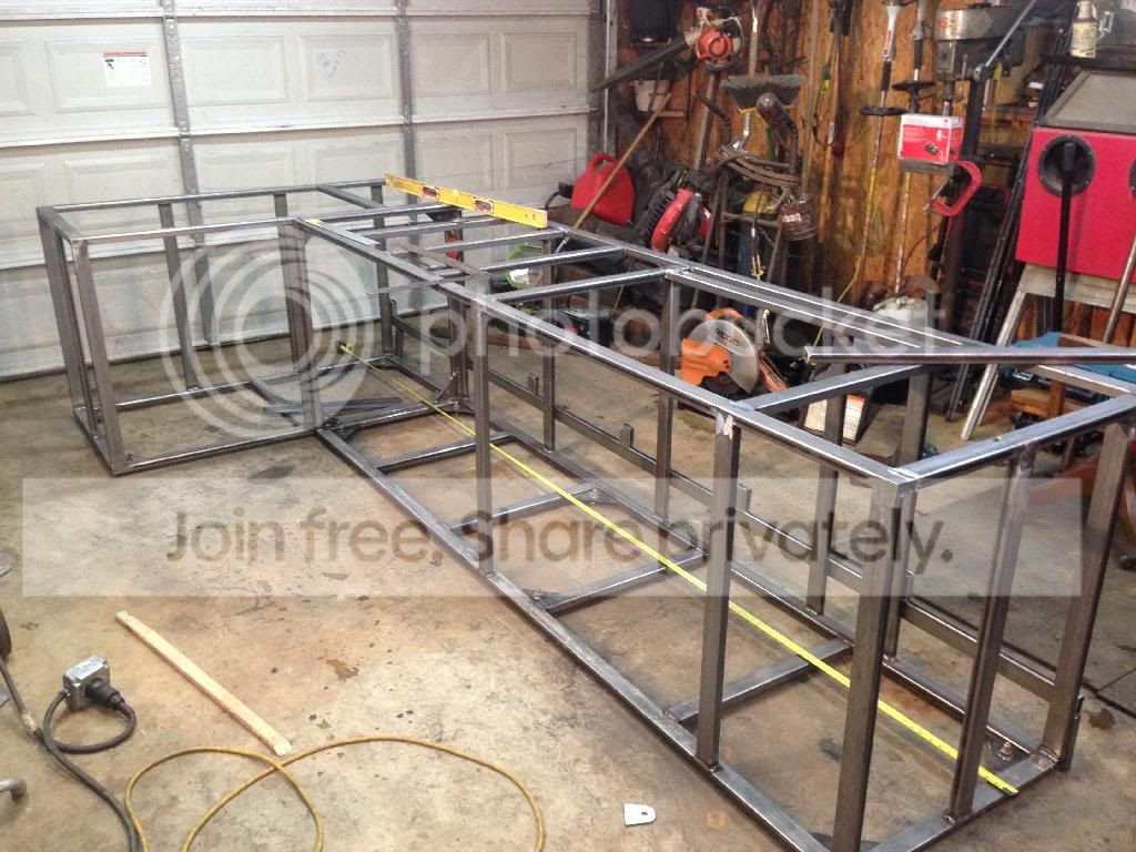

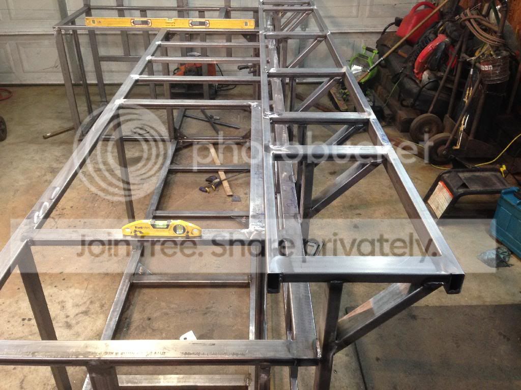

I did get this past weekend to do a little welding, but unfortunately, it wasn't on the rig. We have been doing a big backyard remodel. Pool shed, gazebo, pergola and an outdoor kitchen.

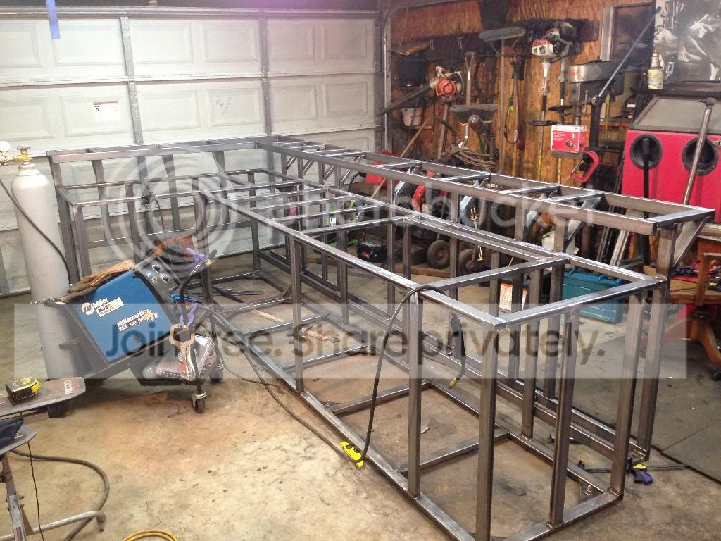

We have been through the outdoor kitchen a couple times in the past, starting with wood on one, steel studs on another, till we finally realized a fully welded structure was the way to go. No twisting, no shrinking,,,,blah blah.
With that, I had to pull the rig out of the garage this past weekend to gain a little floor area to build this thing. Anyone that has had their rig on the garage for years can tell ya, once it comes out, it's like an entire new feeling in the garage. Actual room to move around felt pretty weird all weekend.
Anyways, here are the shots that Dean was talking about. Nothing great or new. The rig does look pretty funny with the rollers on it though.
The beginning of the outdoor BBQ with sink and a two burner. Hopefully I can get the back bar rail done tonight as I wait for the actual units to come in from Costco.

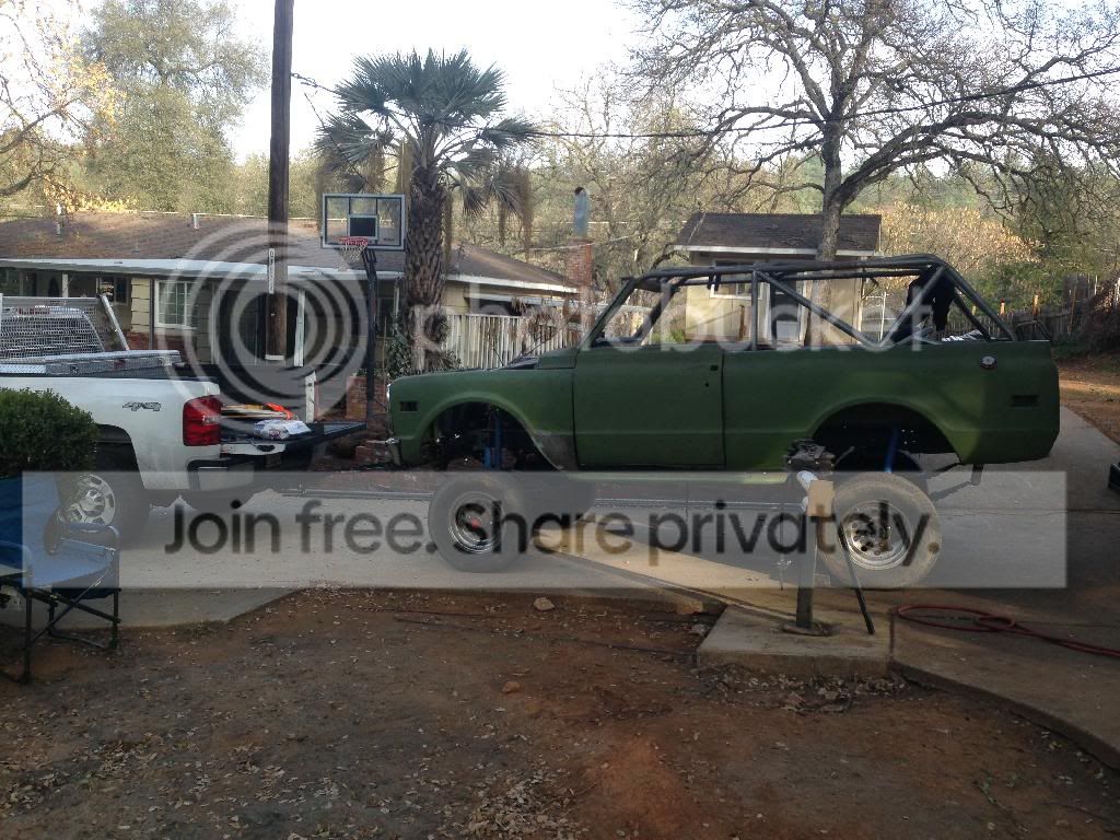

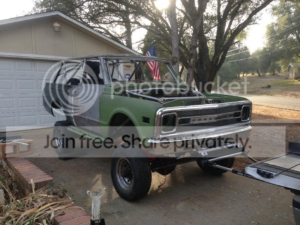

And the rig outside all scared and alone.
A small transformation.

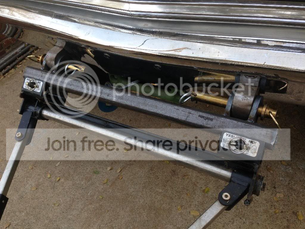

And the fabbed up tow bar to get her outside.

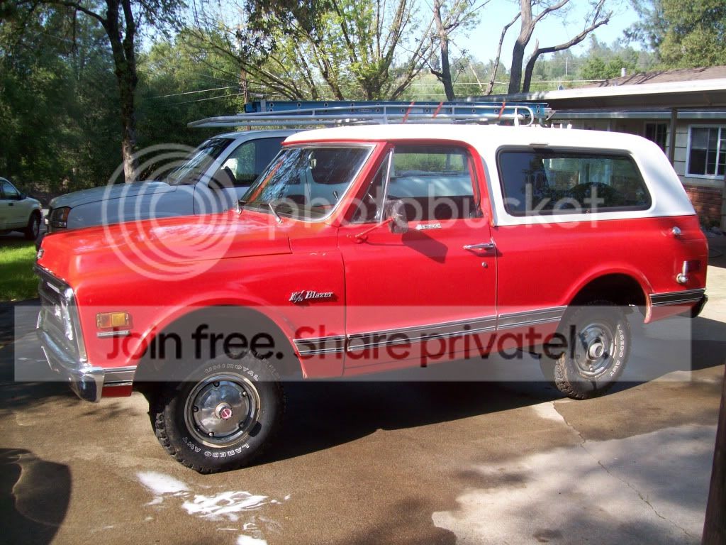

Cool to see what the blazer started out like years ago...will be quite something to see it that color again.

It really is not that heavy....yet. I built the entire thing out of .090 1x2. Strong enough that it doesn't bend or blow through when ya weld it, but light enough to move around.
I might have to make it one piece though. The way it stands the "L" splits into two pieces, but I may have a plumbing issue there and need to cut some of it out. :doah:

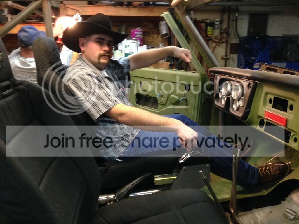

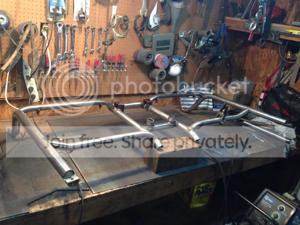

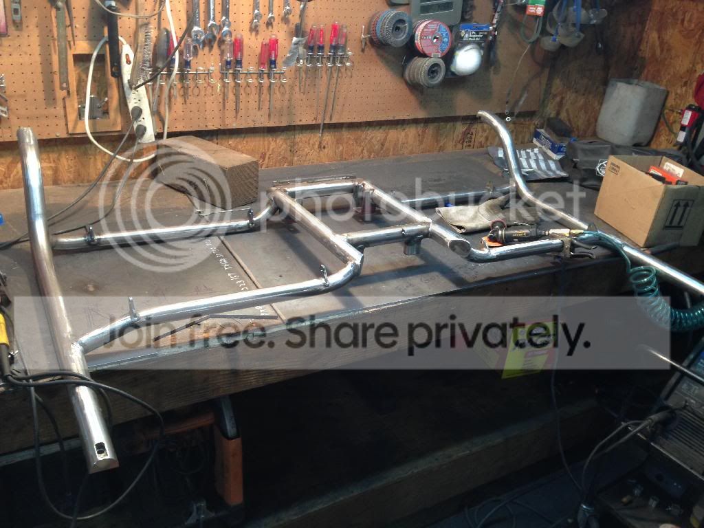

Now that the rig is back in the garage, I spent a little time this weekend getting after it.

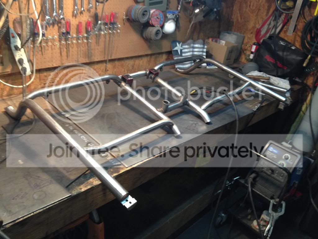

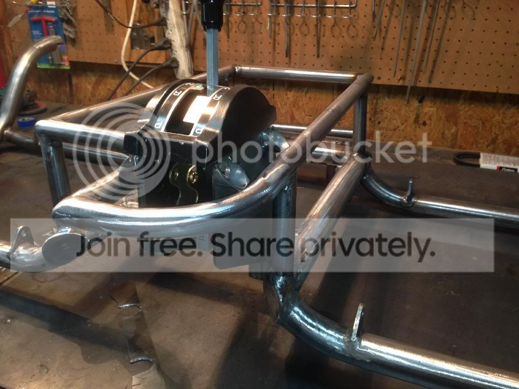

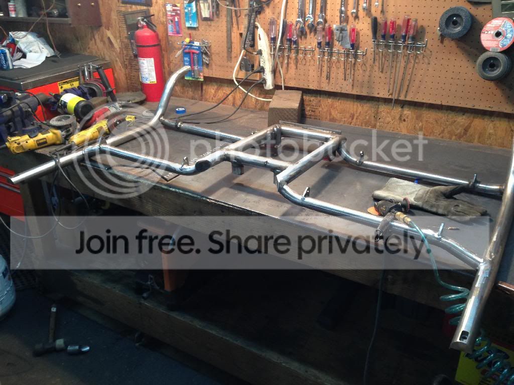

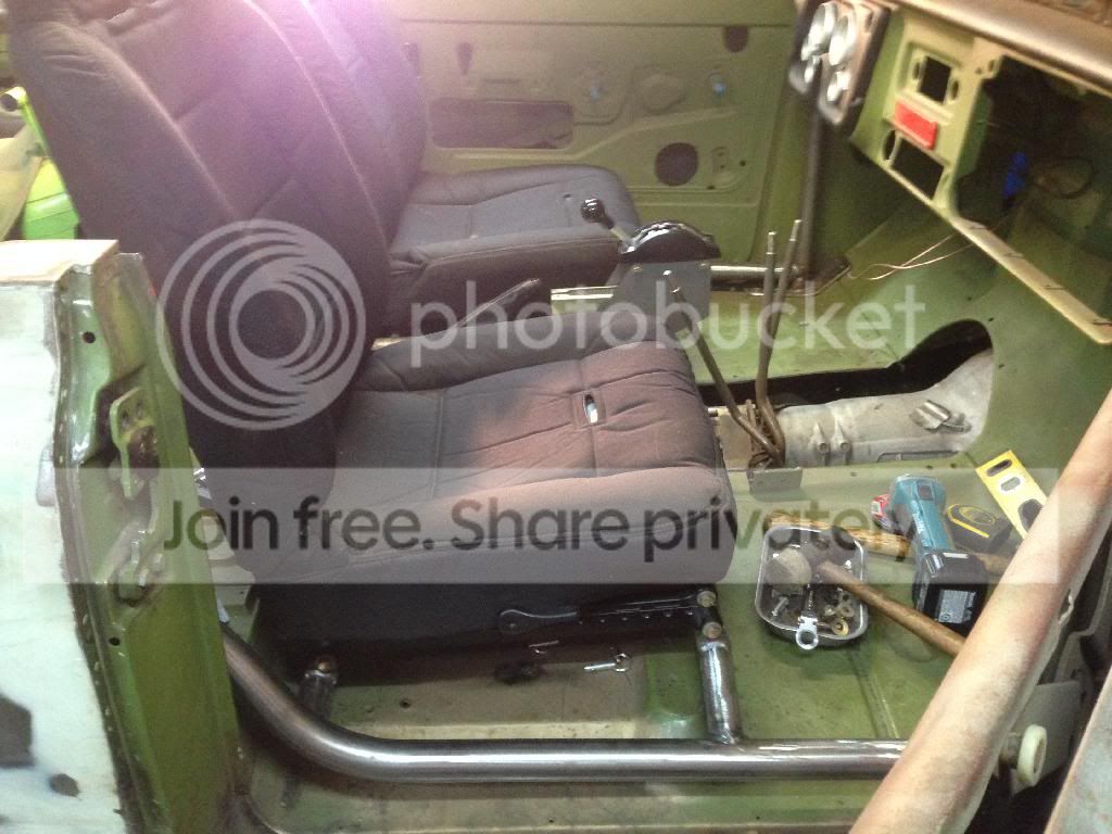

It was all about getting the front seats finally mounted. I ended up getting the bars all welded up and back in by the end of the night. Believe it or not, but everything went back together fairly awesome after welding. I was pretty scared that it was going to twist all up like some spaghetti noodles during the welding.
Not many pics. Everything will come back out for the mount to the undercage and the console.
Here's what we got.
Being able to flip this onto the work bench for final welding sure was nice. :pimp:
The daughters boyfriend trying it out for size. :whistle:
As Eric will see, :D this was the least amount of tubes I could use to fab this thing up. :thumb:
I'll get more pics when it comes out to show the tie in and such.

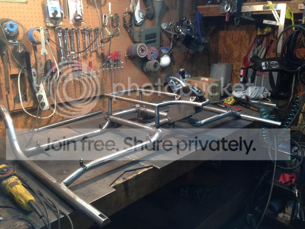

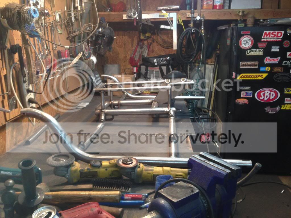

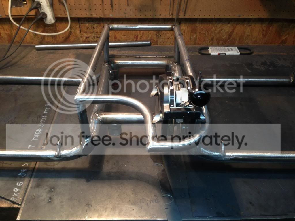

Thanks Dean. Here are a couple pics from this weekend.

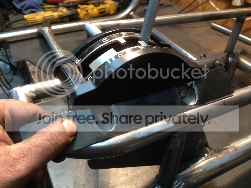

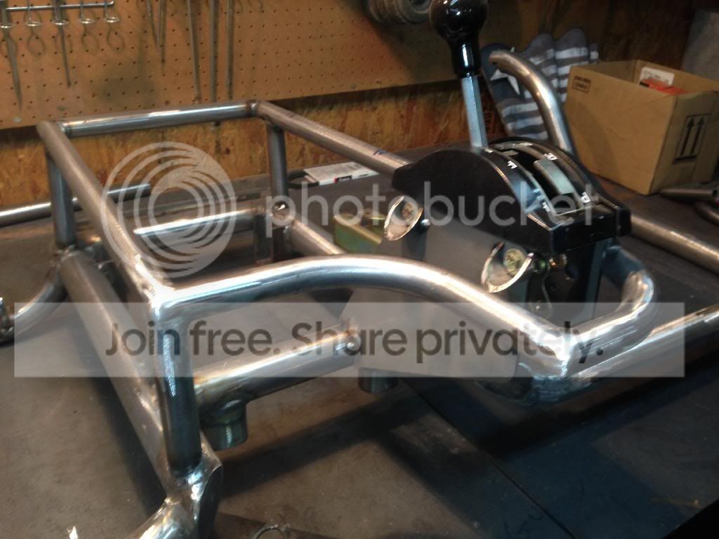

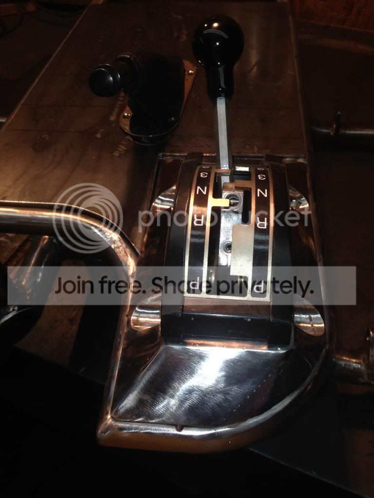

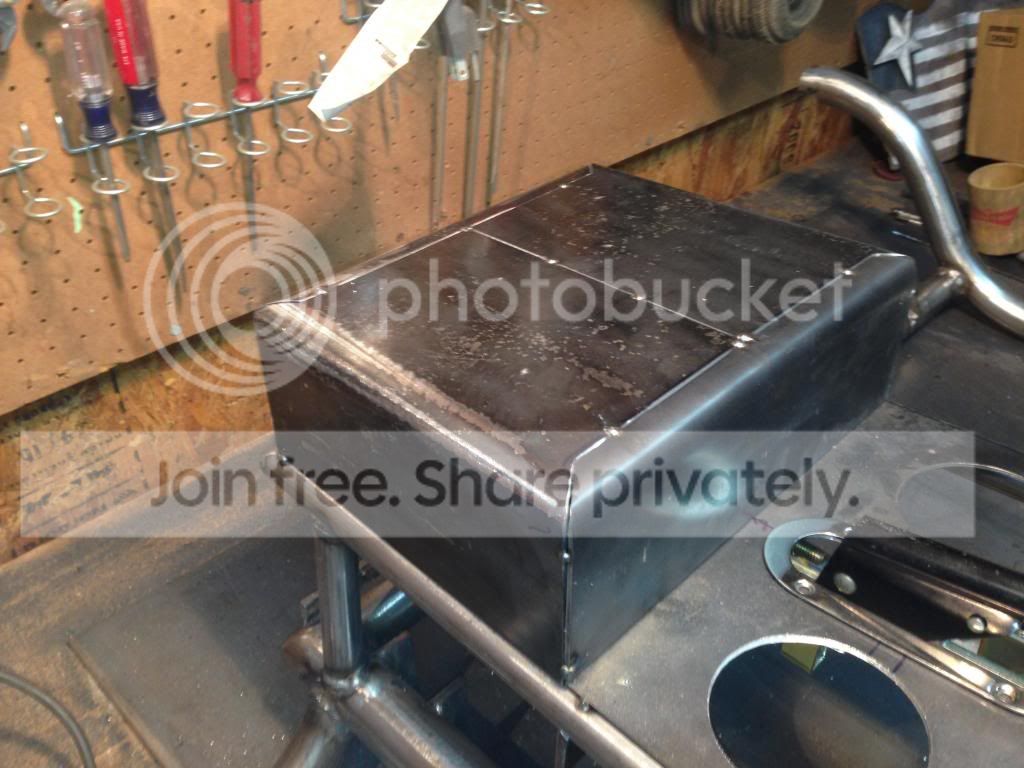

Started working on the console and shifter. The thing kinda kicked my butt a little. Kept falling apart and was generally frustrating. But at last, I have something that I can build off of. actually took a long time just to get to here.
The beginning of the top sheets. Should look cool if I can pull it off. :popcorn:
13 1/4" in the front, to 12" in the back. That was a lot of fun. :confused:

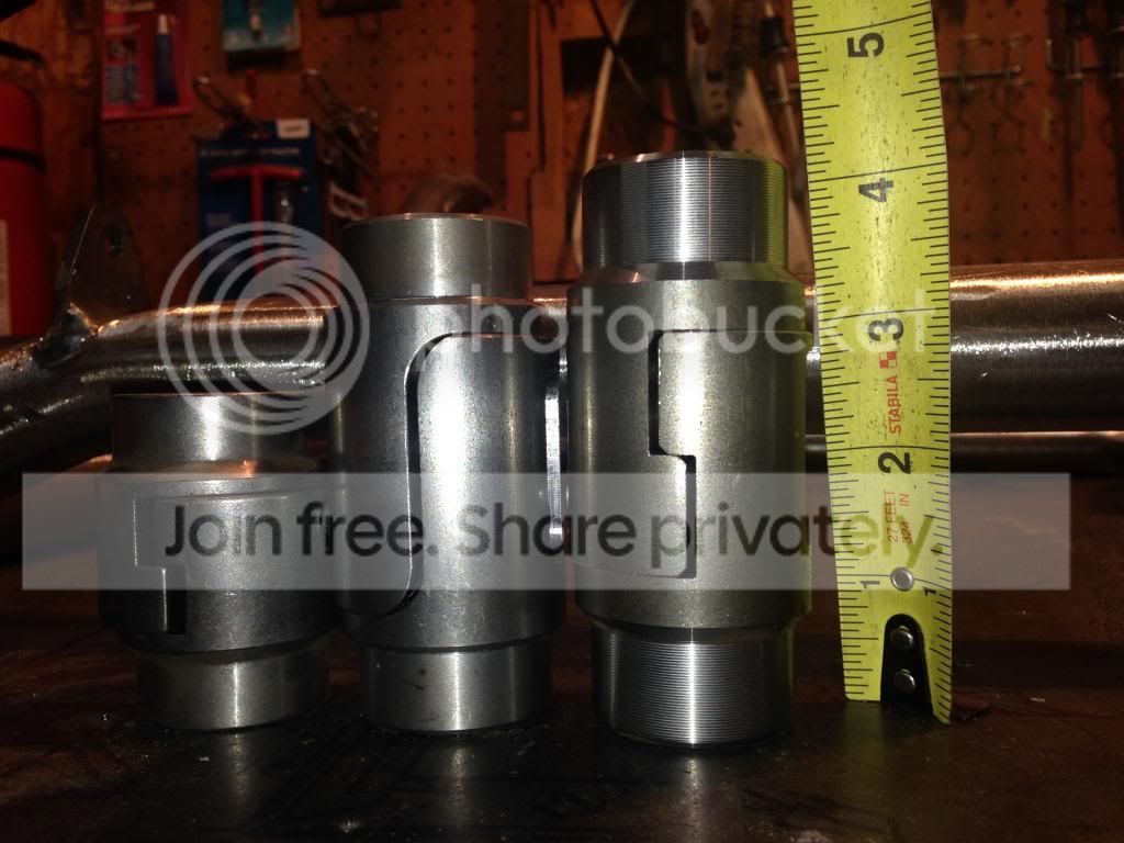

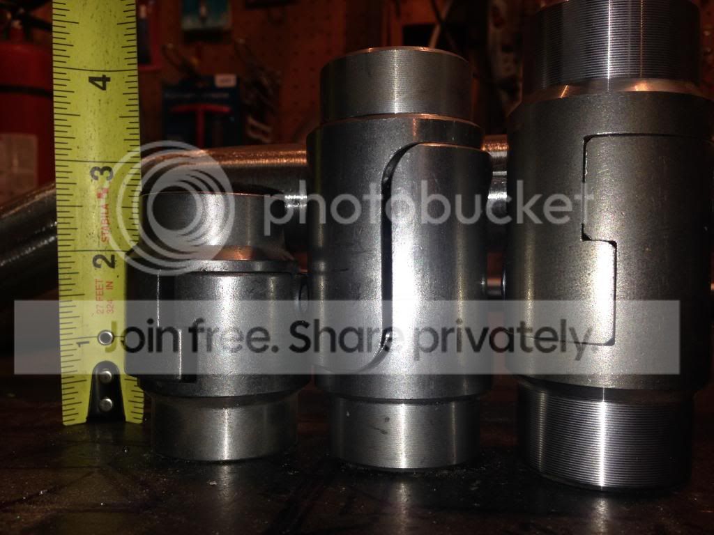

What are those notched thingys called that connect your cage together. I think I am going to be needing some in the near future.
Tube disconnects is the name for the thingys. :D
Here are a couple places. TMR has the best ones that I have seen, but I should be getting my shipment of two WOD discos by the end of the week so I can finish the rear seat cage.

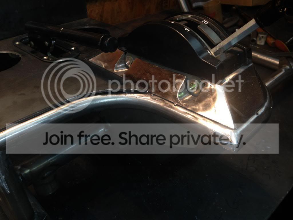

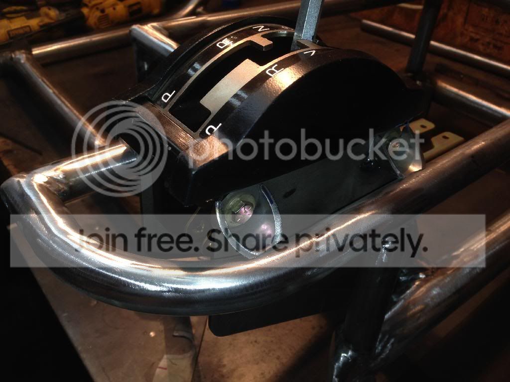

Some more console pics from this weekend. It's starting to take some shape now. :thumb:
I also have a couple pics for Chris on the disconnects.
Left side is Ruffstuff, Middle is Wide Open Design, the right is TMR.
And the console

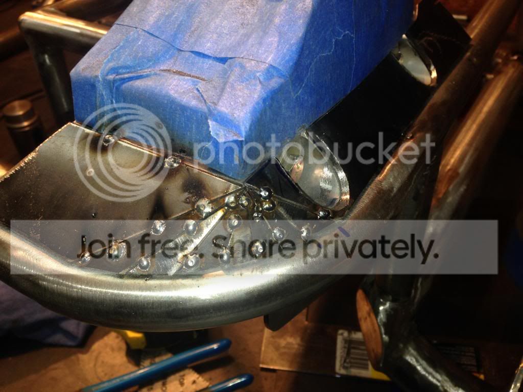

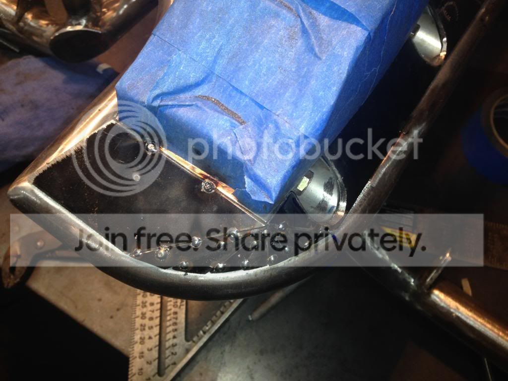

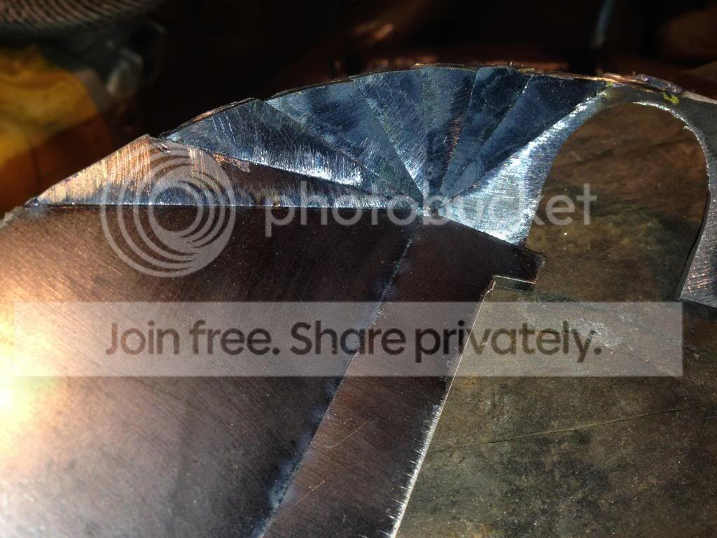

Started to make my smooth corner so my knee doesn't get all banged up.
The inside of the corner.
A little smoothing
Some body work and she should be nice.

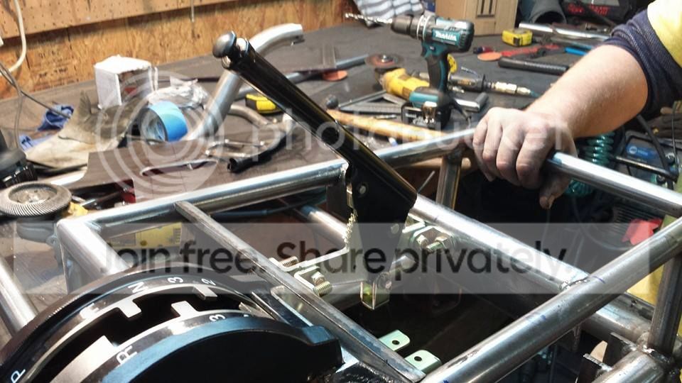

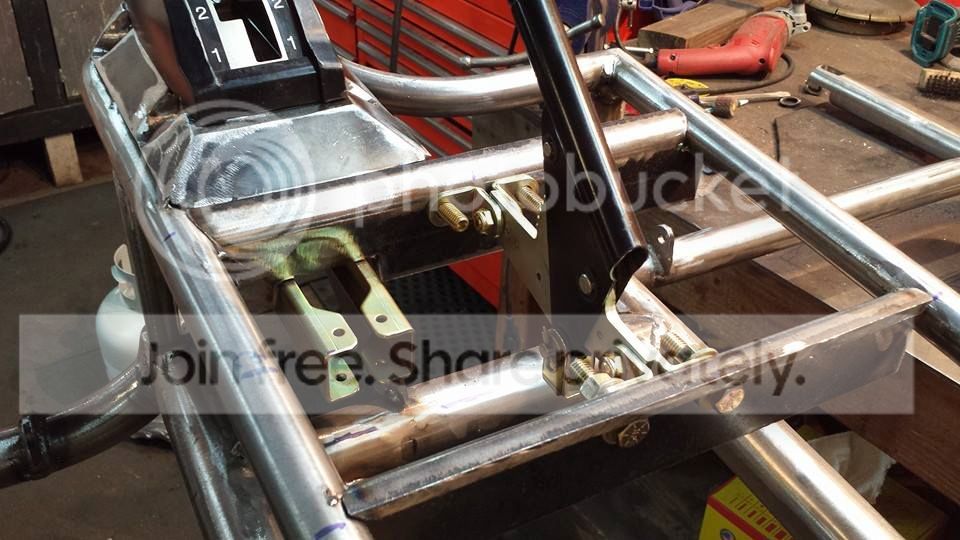

E-Brake install.
A beautiful pic. Mainly, because I'm in it. :pimp:

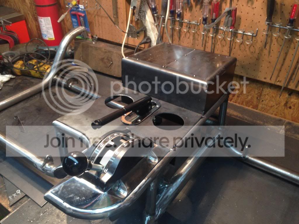

The beginning of the soda holders and arm rest/ storage area. There will be two small boxes that come around each side of the e-brake. I need a little more depth for the cup holders as the shifter linkage is just under the drivers side. Those will be all roundy round, too. :wink1:
All rounded and nice. :waytogo:
