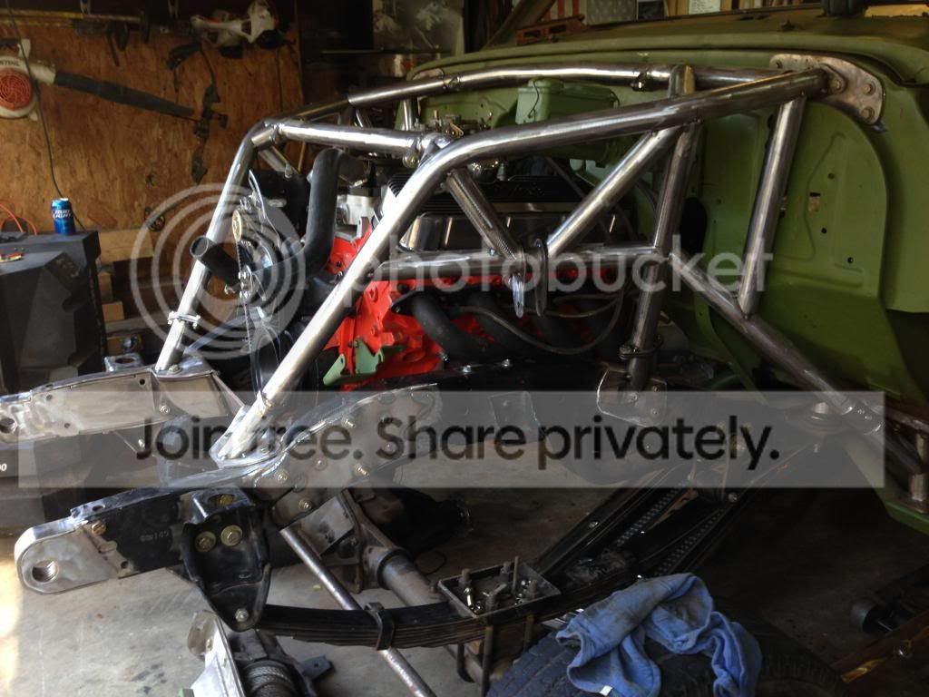

Very nice work, and it sounds great Mike!
Good luck with the surgery btw...
Good luck with the surgery btw...![]()
I just wish that the actual sound would come out on the recording. It just never comes out right.
let's just hope that three times is the one.

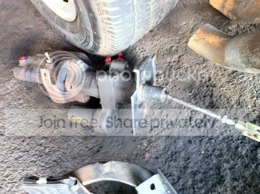

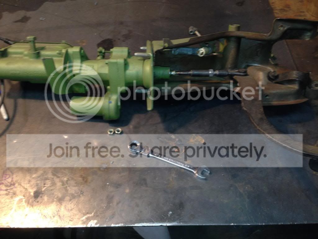

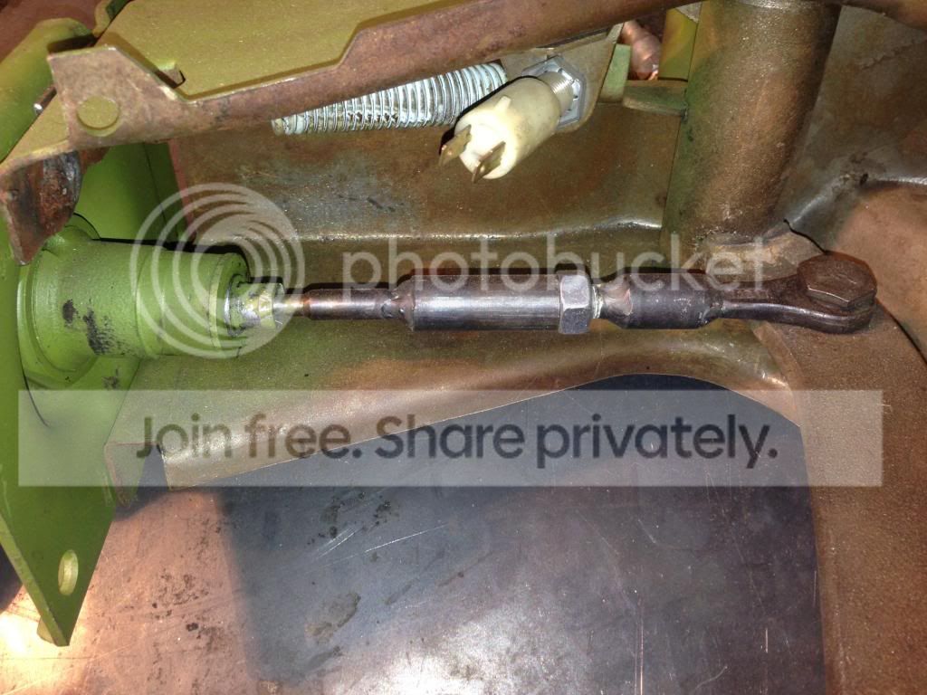

If I do plan on driving this a time or two before she gets blown apart again, I need to work on the brakes and steering. With the brakes, I want to install the hydro unit, but I need to fab or find a pump bracket for that to go in. That is, after I figure out the mounting of the hydro brake pedal rod and unit.

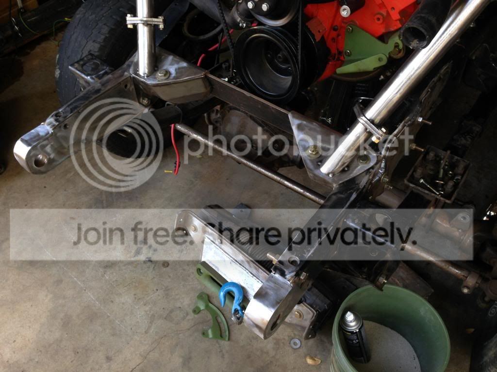

I guess I can come clean on the front end too. Back forever ago I ordered the cross and drag from ORD being I knew I bought a GM 60 off of pirate. After sending pics back forth to Chris, she ended up being a dodge. I guess the only way to know on this year was a measurement from king pin to pin. Turns out it's something like an inch or two shorter.. So I either need to send these back or get them cut down and tapped again.. Who knew? I sure as he'll didn't.I also need to find an Xj shaft, buy one or go with a Borgerson.
That would leave a ton of welding, a million loose bolts, radiator mount, gas tank mount, new inline tube tranny and gas lines, e brake mounting with cables and the minimum wiring for some hot laps. My neighbor is a cop, so he said he would race me, try to catch me going around the circle (round block) with his lights going, so I guess I won't need any for the test runs. His should be sufficient

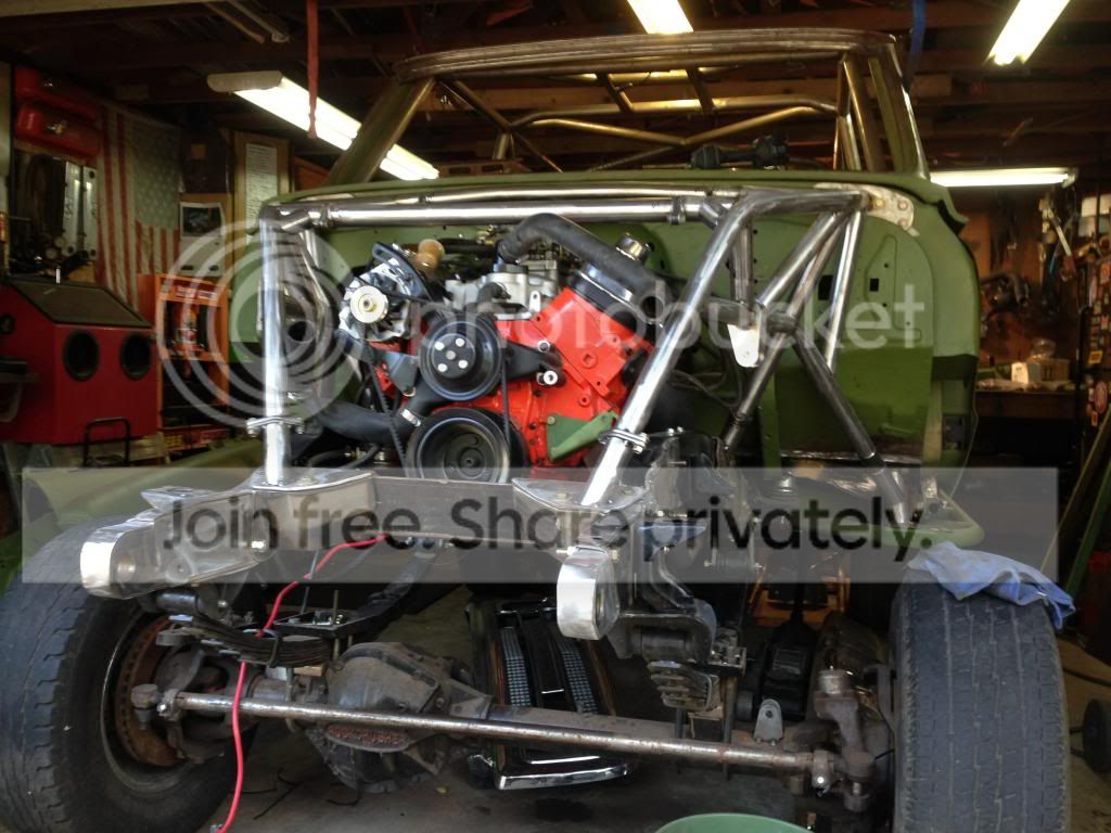

great tube work on the exhaust Mike, they done good! Are the pipes 3"?
And what the heck is that archaic fuel mixer on that sweet BBC anyway?
As far as the traction bar.. I dont know if you could get it in next to the driveshaft now, but keep in mind that for good articulation it needs to allow the axle to move on both planes of movement not just up and down, as in sled pulling or drag racing...Kert's antiwrap bar works great in this application, I've seen others with a compromised setup that limits movement by not having the pivot for the bar to move on.
