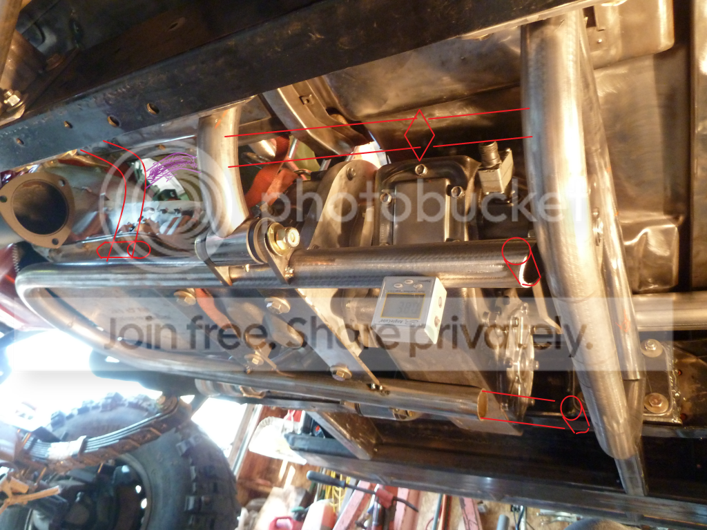

Here is a pic of the overall design that I have in my melon.
The main question would be an additional crossmember going from frame rail to frame rail. The way I see it, I really only have two. The engine mount and as Heath put it, My fancy double pipe looking crossmember..:pimp:
The round things are the fab bushings, the oblong square looking thing would be one of Kerts two bolt staked cage flange. The purple would be an additional crossmember from frame rail to frame rail.

I really don't even know if the front fab bushings and support will work out yet. They would need to go over the exhaust in that area. It looks doable, but on the pass side, I don't have a lot of the hoop visible. I needed to tuck it under the trans pan a little more on that side for clearance. But if they do work, maybe run a bent tube over the lowest part of the trans.
Do you think that it would even be needed, if I could even do it??
Your bushings in the back was exactly what I was referring too, sounds like you already had that plan.
I think if you make the red/purple one in the front with the crossbar over the top, plus the 2 mounts in the back to the double pipe x-member, that you don't even need the center one with the red diamond link connecting it. That one will help, but since it is only connected to one frame rail it will want to twist that frame rail, which probably isn't an issue because your sliders and cage will stiffen the frame a lot. Just keep in mind you won't be able to take the front x-member out without removing the trans first, but as long as you can remove the trans by just removing those two bushing bolts, and you can get the exhaust out without removing the trans, who cares.
Also, in my opinion, if you have two bushings holding the engine in at 24" widths, then the rear of the trans should have 2 or less bushings, at a maximum of the same 24" widths, preferably narrower. The crossmember can have as many bushings holding it in as you want if the trans is only bolted to it in 2 places toward the center with bushings. This may not be necessary, but I would feel pretty confident it wasn't going to bust a trans case when the chassis flexed or you got on the throttle.
You do have your double tube crossmember at the back, but I dont yet see where the other is. One potential problem is that the two existing bushings are hard mounted to the frame without any hard mounted crossmember tieing the bushing mounts together. When the frame twists, there's a lot of potential leverage in those two bushing mounts being able to rotate your transfer case around.
One option would be to rotate the two existing bushings around and hard mount them to the doubler mounting plate you have, then hardmount your big "U" tube to the frame without bushings.

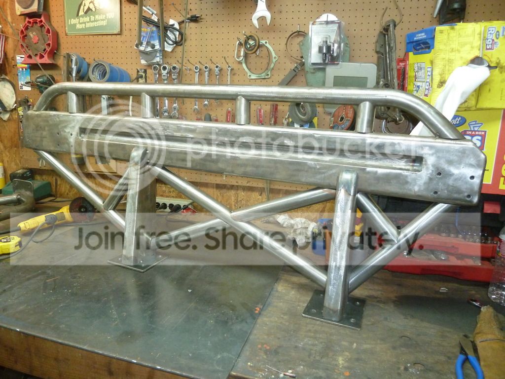

Had this on my brain for some time now. I know you guys were talking about the leverage on the two separate bushings on the back of the big U. I ended up bending up the back half and throwing in just one bushing. The way it sits now is the two side bushings sit about 1" closer together than the engine crossmember mounts, using the same bushings and just the rear one.
Still got a ways to go on some of the other factors with the doubler mount, but thinking that this may of crossed one off the list. Maybe??? :D
It looks really good, except I would put one more bushing between the front trans mount and your center support, those puts both bushings in the center. They way you have it now with the center bolted directly to the mount it puts the torque out to those bushings on the outside. Once you do that, as long as you are satisfied with your trans pan access then you should be good to go.
Not sure if I follow you yet, Heath, but I really want to. Just not sure if I'm seeing where you would install the single.
I still plan on using two more bushings on the sides that mount over the collectors. As far as the trans access, I was thinking of using two of the cage inserts directly behind those two mounts. This should give me easy access to the trans pan while still keeping everything else suspended.
The way it sits in my mind is by the time I have everything welded onto the removable side plates, the entire mount should split into seven separate pieces.
1- Rear crossmember that is welded to two removable plates on the frame.
4- Support legs that are welded to the removable plates and attached to the hoop with bushings.
2- The bottom hoop that that can be split into two separate pieces.
Do you like the idea of the single bushing in the back VS the double that was on the original plan? It seems to me, that is what you guys were trying to beat into my skull with the leverage of tying two bushings to the rear crossmember. The entire thing, if needed, should be able to twist separately than the frame on the single much more than the double ever would have. This should keep the twisting of the entire drivetrain down VS the original mounting using the double bushing.

I do like that single bushing, it's a step in the right direction, however, the two outside of that add stiffness to your mounts. What I was saying is to mount the tcase adaptor to your hoop with a bushing. But you will actually need two bushings probably(missed this in my other post), one for both adaptors (trans and doubler adaptor). But with both those mounted in the center with bushings, then it won't really matter how you mount the hoop, you could mount it solid to the frame if you wanted, but more bushings wont hurt anything at that point because it's like they are in series, not in parallel if you know what I mean.

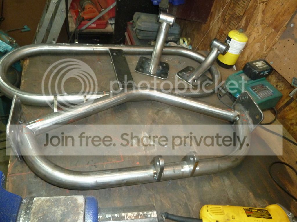

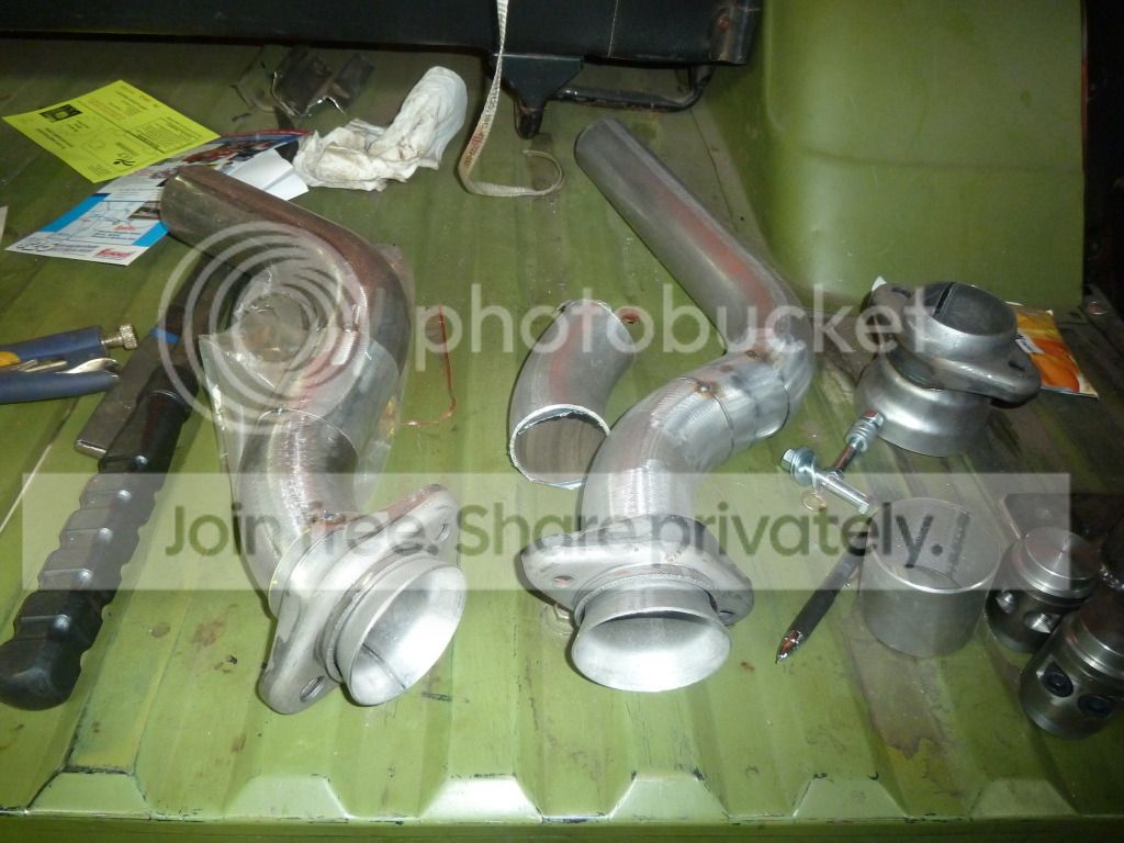

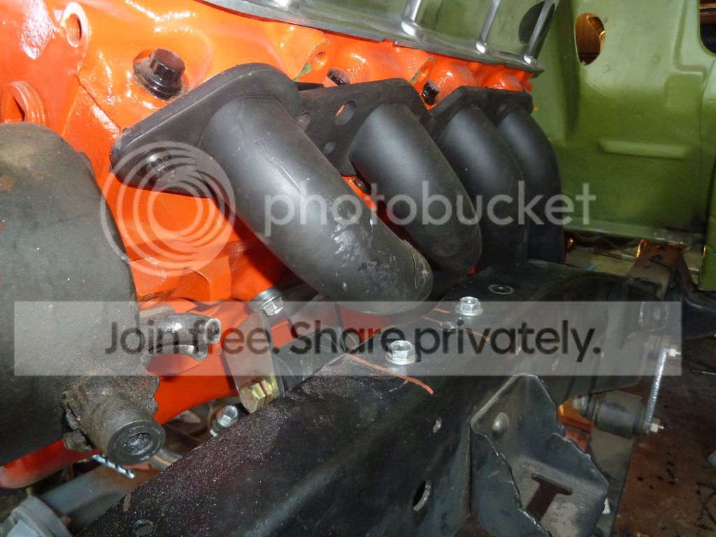

Finally beat the drivers side header. I did the same thing that AJ did and it worked out nice. Once I take it all apart, I'll fine tune that 1/2" shim. I massaged the frame a little too..

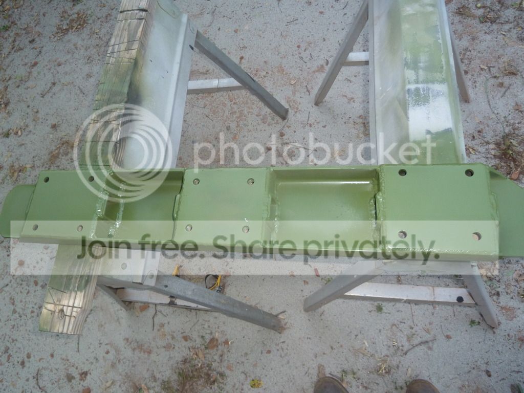

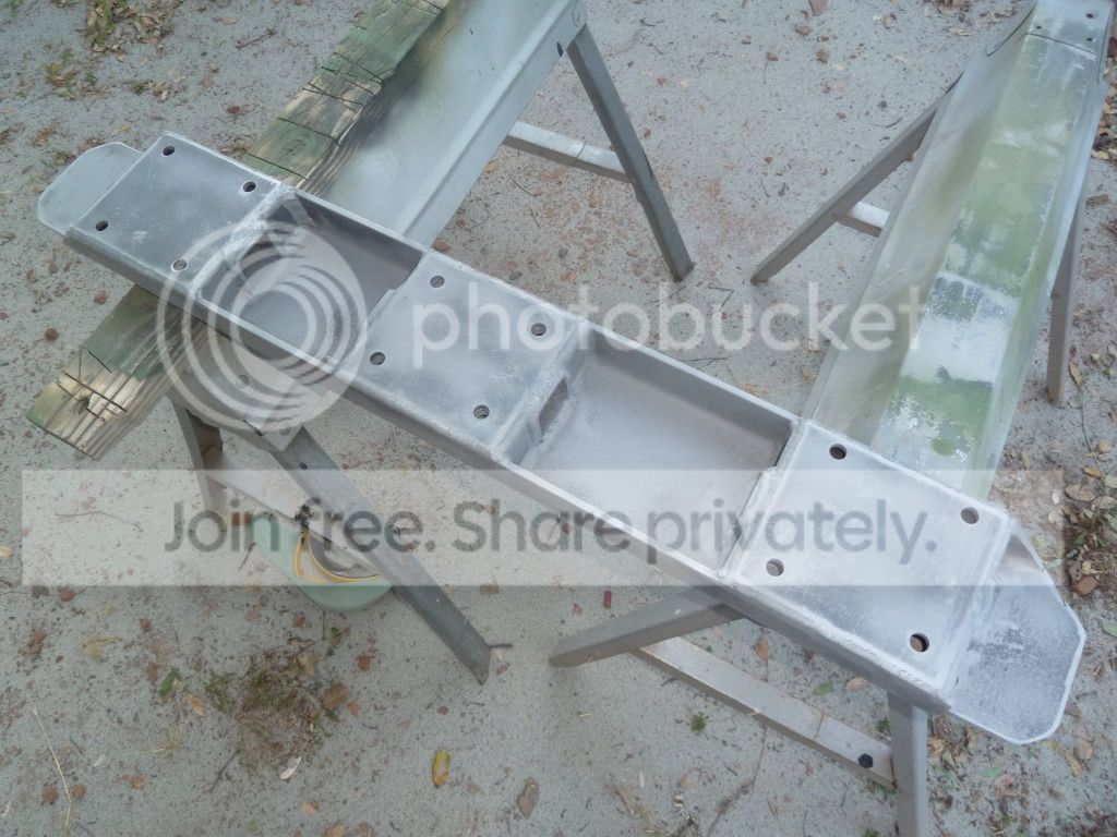

Took out the drivers slider for final weld and the doubler mount for partial weld. On the doubler, once I get the outer stuff welded, I can mount the centers with some stock I picked up last week. I think that I'll be able to use the small bushings I got from ORD on Sat. too.

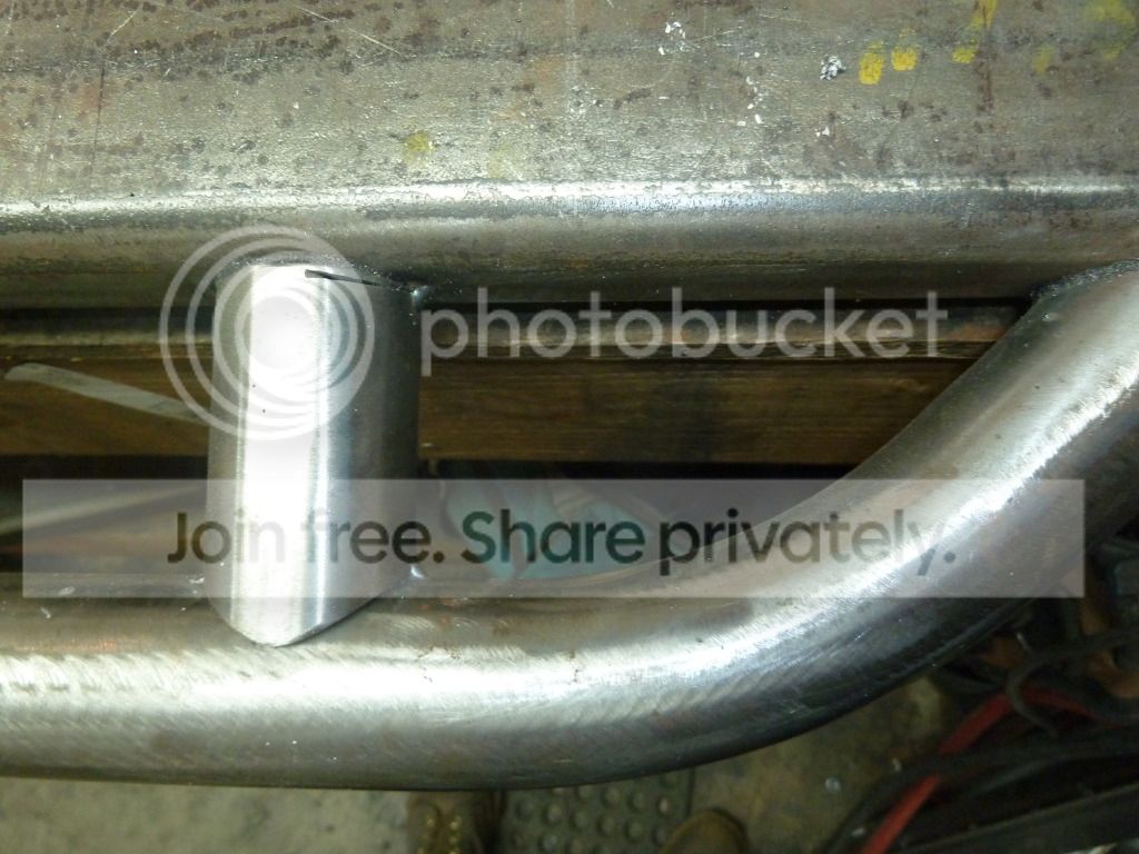

Fixed one of the tubes that has been bugging me since I hung the step on the slider. A little sawzaw relief cut and she was able to move.

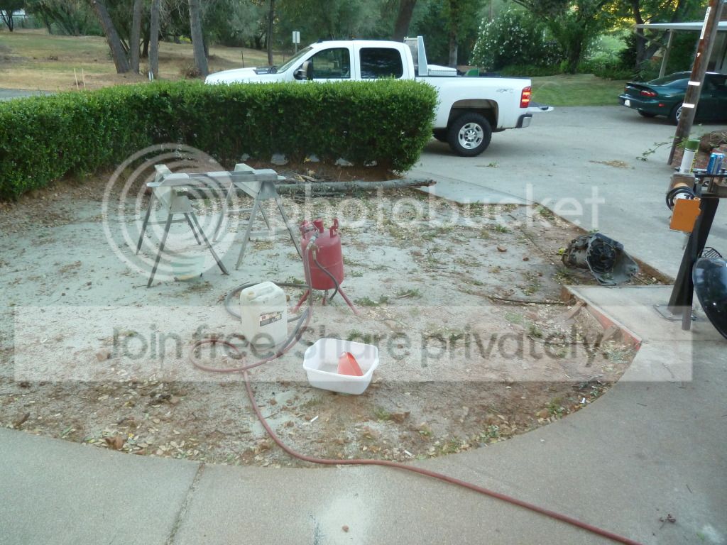

Finish weld and blasted the inner frame things.
The neighbors must love me..:rolleyes:

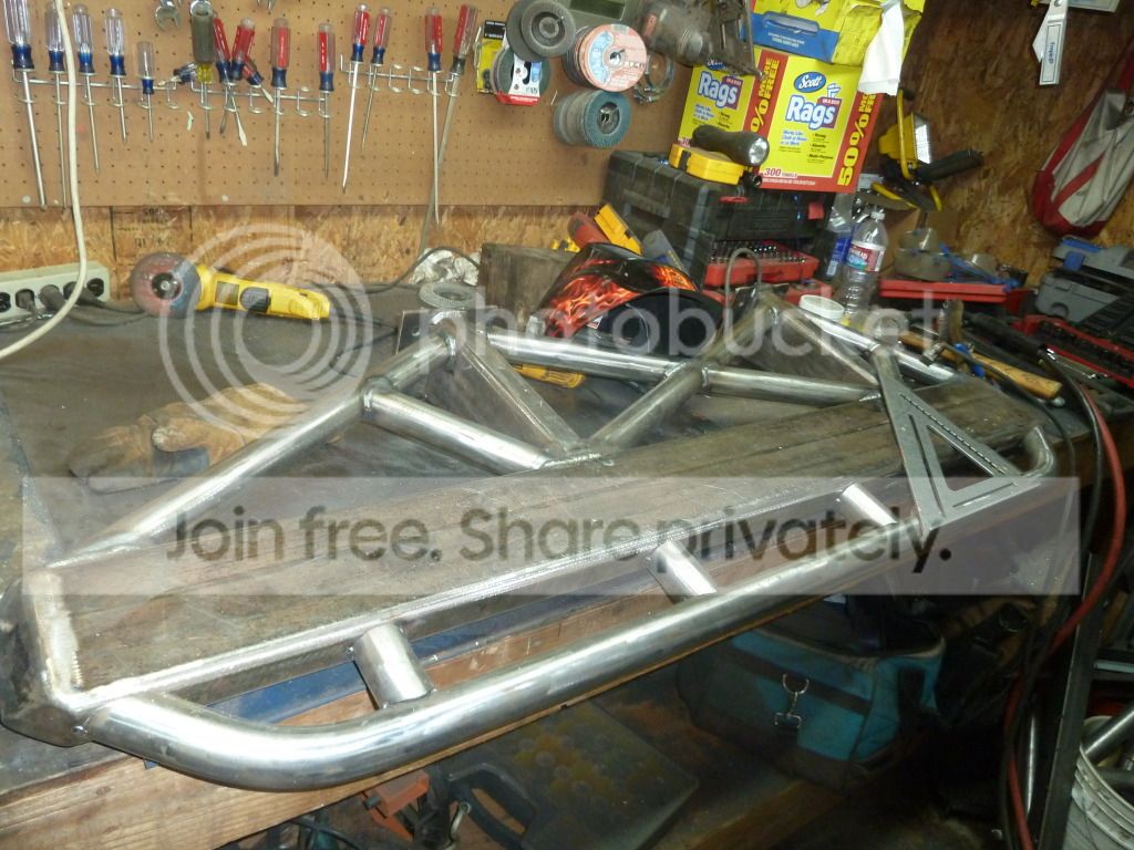

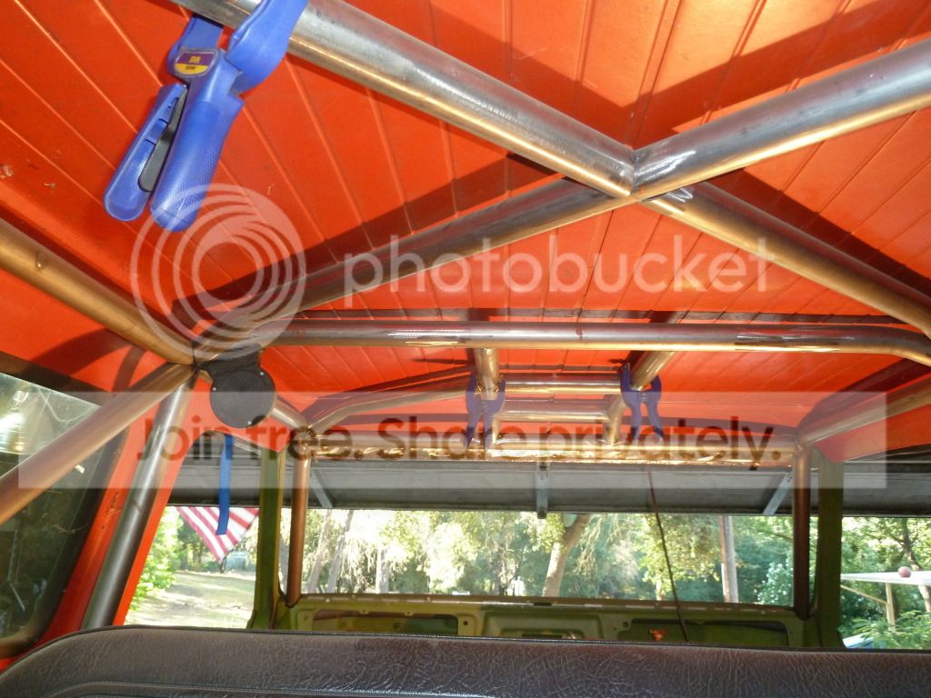

Bent up one of the new bars that come off the top of the A to the center over the driver. The old ones had too much of a bend and the top was hitting them. Still need to do the pass side.
Mocked up the drivers side tube. Some how I didn't get the same CLR bend on this new piece. We'll see how it works out.

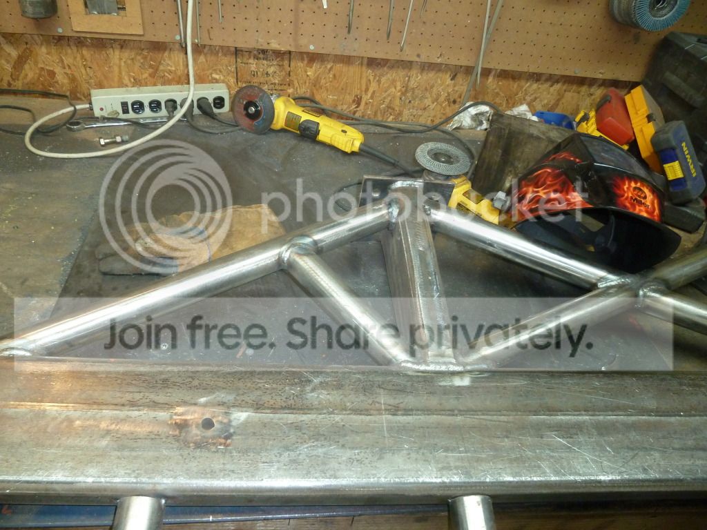

And some tube welding for the first time. It's not super pretty, but I'm getting better. I ran out of gas last night, so that was as far as I could get. Today, it's going to be a bigger bottle exchange at the welding shop. :D
