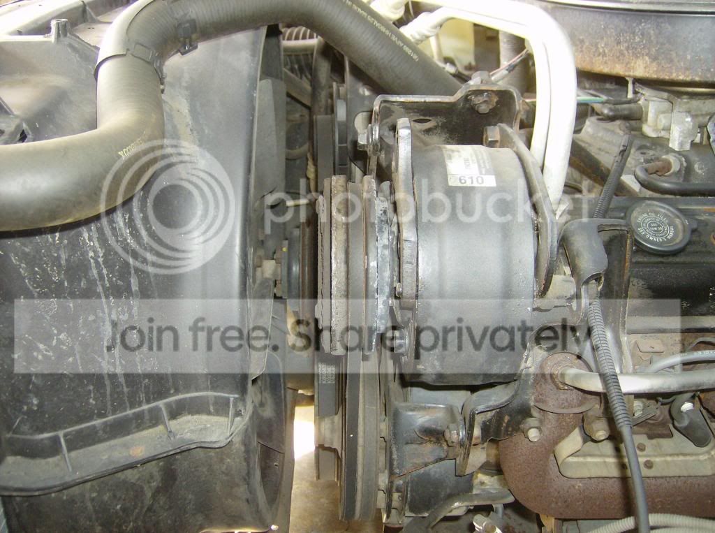

Is your compressor now really long with a bracket at the front and another bracket at the rear? Or is it a really short unit (maybe 4-5" from the belt to the rear). You might already have the right one. I just can't remember which came in the diesel model.

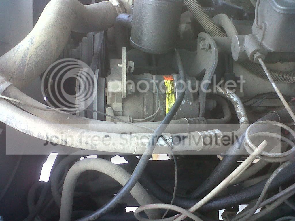

Longish, bracket in the back.
Still haven't cleaned out last summer's mud as you can see... :waytogo:
If I'm seeing it right on my blackberry. That's the one you want for oba. I will look at it at home on the laptop and tell you for sure. I think that's the A4 the log. That one outperforms the york 210 by 20% of volume.

ok I'm home and have looked at your picture. If your ac lines are connected to the compressor by one bolt in the middle of the lines on a single block then you have an A-6 compressor, your good to go. I couldn't for sure tell if you had in fact an A-6 (which I believe you do) or an A-4 (see attached picture). Both will do the job, but the A-6 will do a better job, longer, more efficiently, you just have to make sure that you occasionally add oil to it manually through the air intake line. Just like using an air tool, occasionally you add oil to the tool before using it. I have attached another picture of my A-6 oba compressor that is sitting in the garage and can easily be spun around for me to show you the back and how the lines fit on the compressor. If yours is like that then it will work, with no problems. If each line is screwed onto the back, it will work, just will need more specific parts, but it will work! The last picture is the plate and piping I did to make mine work (when I install it) so that I can simply attach any black pipe that I need to to the plate instead of tapping out the compressor. Hope this sets you in the right direction!

That's not an a6. I've posted pictures of mine here before about 8 months ago. That's about all the help I can be. The a6 is 6 cylinder, 12ci vs the York 210 which is 2 cylinder 10ci. I'm guessing the a4 would be 4 cylinder and 8ci.
Look at the bottom of the housing. If it has some sort of bowl/depression about 1-2 ounces in volume, it'll probably be a good candidate for OBA.

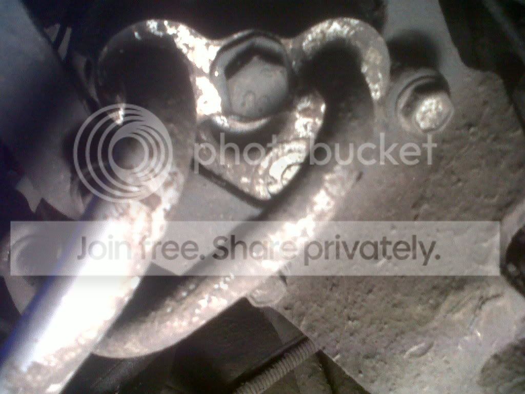

Alright, went out to grab a pic to make sure but it looks like the one piece.
That's the one that you want. Email inbound, do me a favor, post up the pics so that the next guy can search this thread and learn. Kind of a pay it forward type of thing! You'll see what I mean when you get my email.

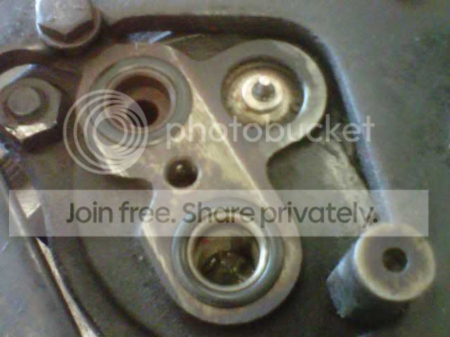

[FONT=&quot]back of a-6 compressor - this is the back of the a-6 without the ac lines attached. You can see how the o-rings seat around the base of the openings and how little room the ac o-rings need to take up to do their job.[/FONT]

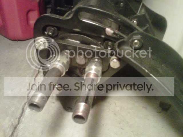

[FONT=&quot]rear of a-6 - this is how mine is now, in the garage. I have tested this setup with an electric motor, it was an older style plow electric motor. I figured from the pipe on the back of the compressor, I need to add flex lines next to the other components of the oba system to allow the motor to flex and shake in the motor mount without damaging any of the plumbing of the oba system or any system it comes in contact with.[/FONT]
I'm thinking what I may do is take that backing plate with hard lines and hoses in to a fitting place where I get all my NPT stuff, and see if they can put some fittings onto them that I can connect with a standard air line. On the output side at least. That way I minimize the risk of leaks.
