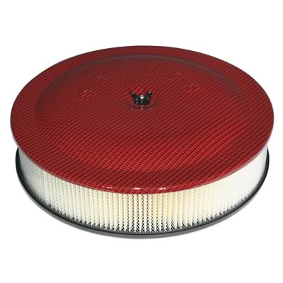

Air cleaner lid anyone..?
I'm pretty sure those lids make you lose HP
The only way I could see one of those lids helping is if you have say a very tall intake manifold and like a 2in cowl hood and are running a thin open element to clear the hood.
I don't even care about the function in this case, they look ghey... :haha: coming from an oldschooler.... :popcorn:
I'm gonna run a 14" x 6" element with this lid in my cowlhood airbox...
