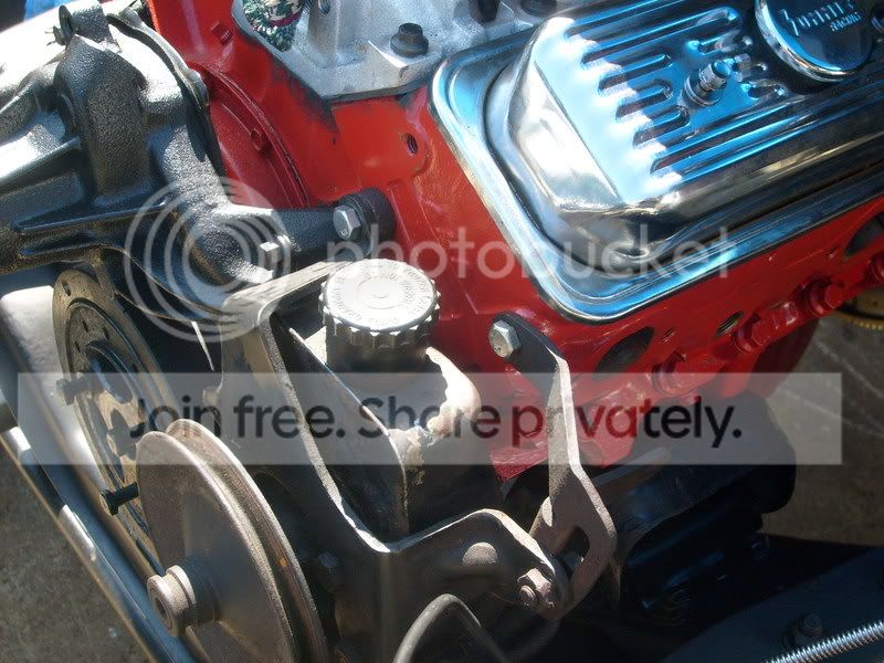

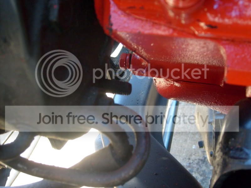

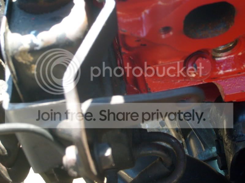

Ok. I bolted the top two mounts to the head, found a spacer to use (which I believe came off of there anywho).
I don`t see how the bottom mounts up. I see no way for it to mount to water pump. There is however a stud on the back of the pump.
Here`s a few pics. Without the bottom mounted, the pump is really close to the block.

yeah, I know about that. I shouldv`e clarified my question. I don`t know how the bottom of the P/S pump mounts, as I see no where for it to go. I do see a stud on the back of the pump near the bottom, but no where for it to go.
If I were using this pump on my March brackets,, then yes it would work fine.. I removed the stud on the back of the pump and replaced it with a thin spacer and M10 bolt.
One of the brackets in the kit will bolt onto the back of the pump,,the other will bolt to the front,,these two brackets pivot on a open casting hole of the water pump.
the third bracket ( the main adjuster arm will bolt thru the water pump mounting bolts on the right side of the pump.
If you need a pic of my set up I can take one tonight and post it up....
