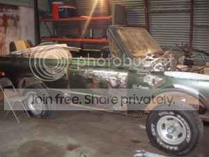

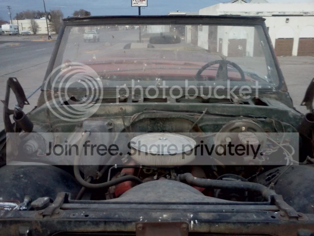

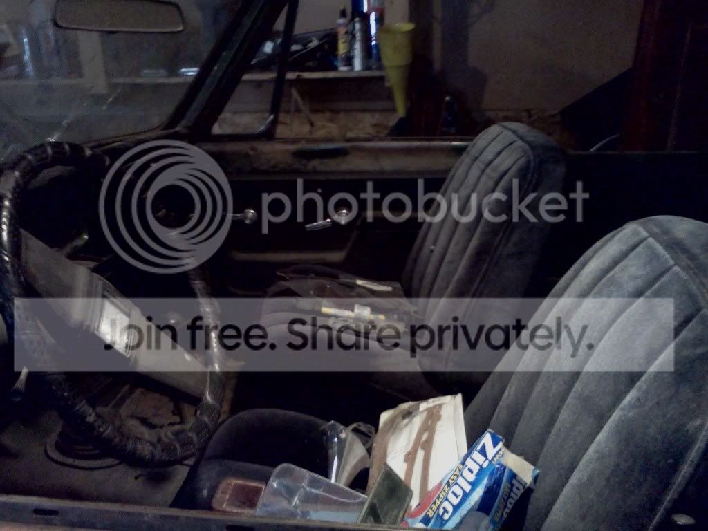

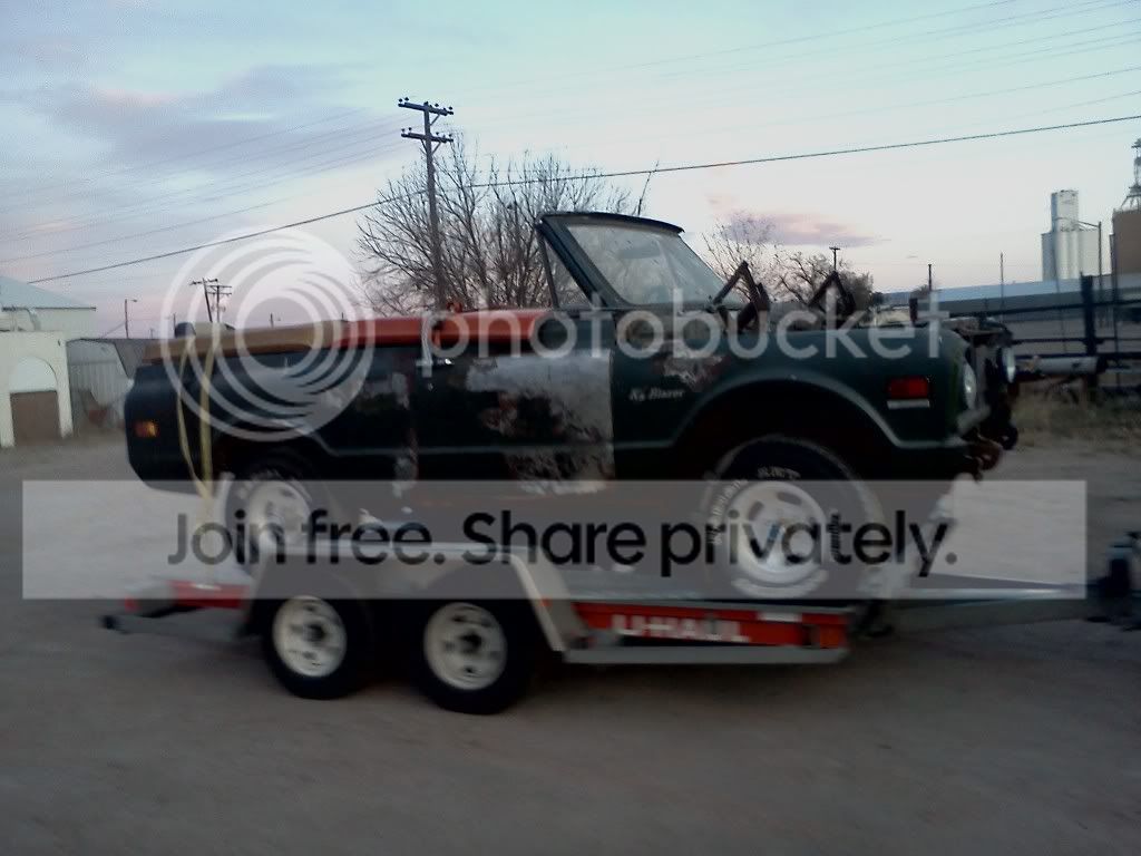

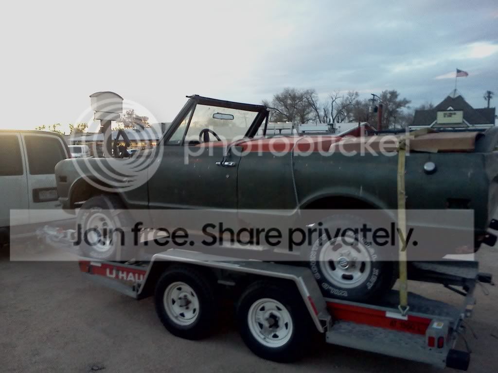

Yo everyone! As you guesed it, im a new guy here. I paid for the subscription so i hope you like the build. LOL. Anyways! Hi nice to meet ya! I have been a very active member of another foreum for years that i will not mention but just thought i'd stop in and see what it was like over here on the other side. LOL I have had a few blazers now but this is my first first gen. I picked it up in northern colorado about six hours out of lafayette. It had been sitting in a pole barn for 10-15 years. Two previous owners and all paper work. Sadly mice, raccons, and birds had made her there home. So we put some gas in her and a battery. She fired right up. Drove her on the trailer and home. Picked her up for $850 with no top, two hoods, no bumpers, ect.

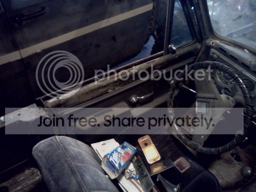

ok the fun starts. surface rust. i was waiting on parts had to do somethin

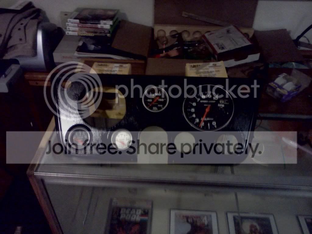

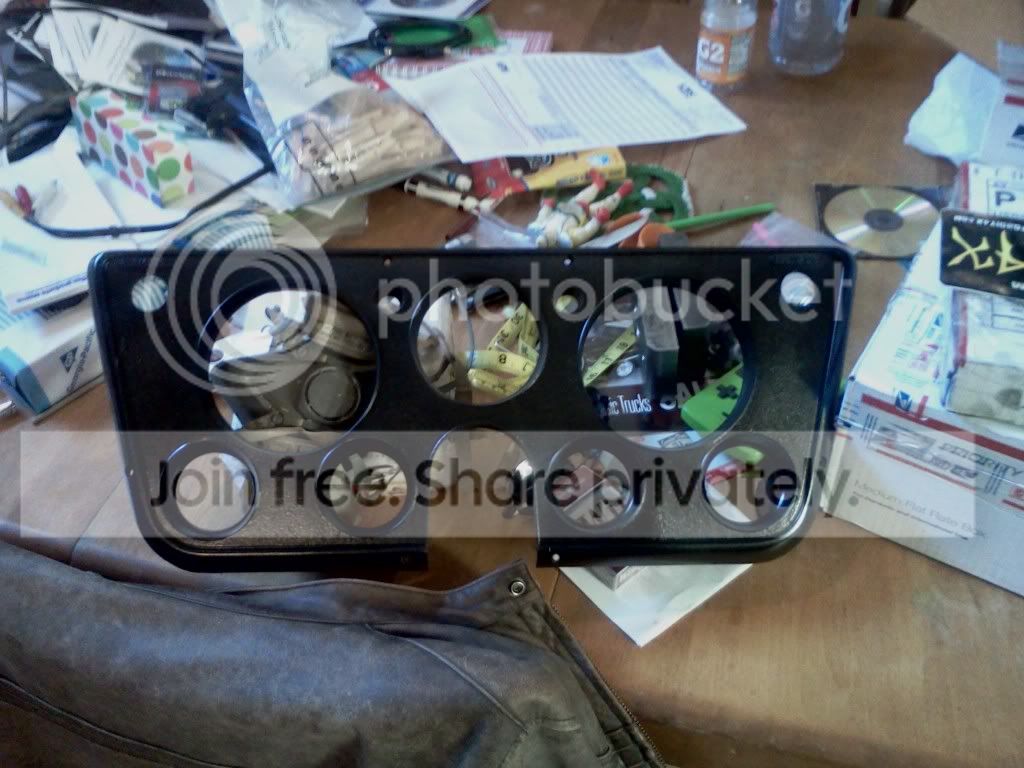

gauage cluster
painted

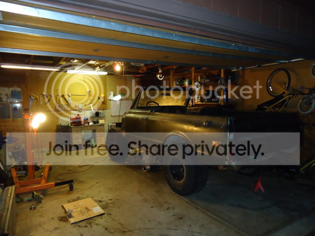

quick shot of my working set up

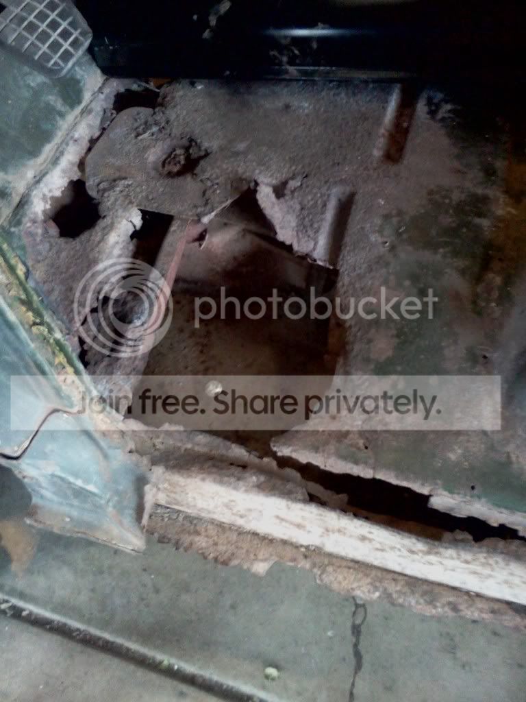

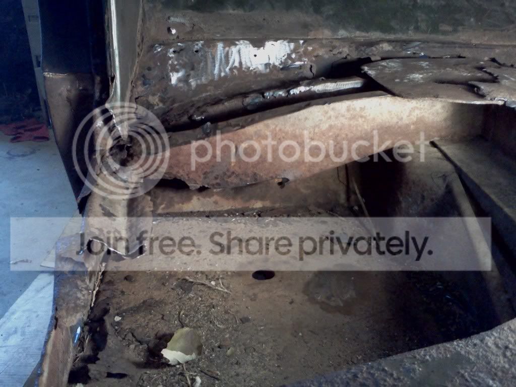

nasty rust
picked up a heater blower motor off ebay $12.00 didn't want to fix this after k5's back together that would be a pain

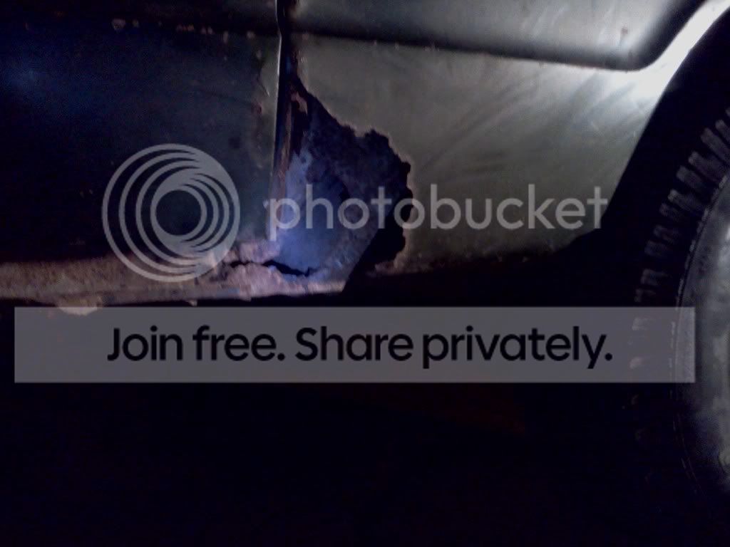

check out the rust hole. new meaning to flinstone car

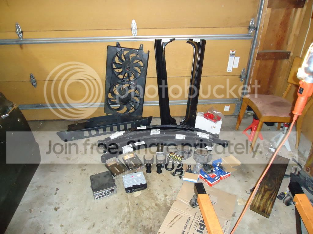

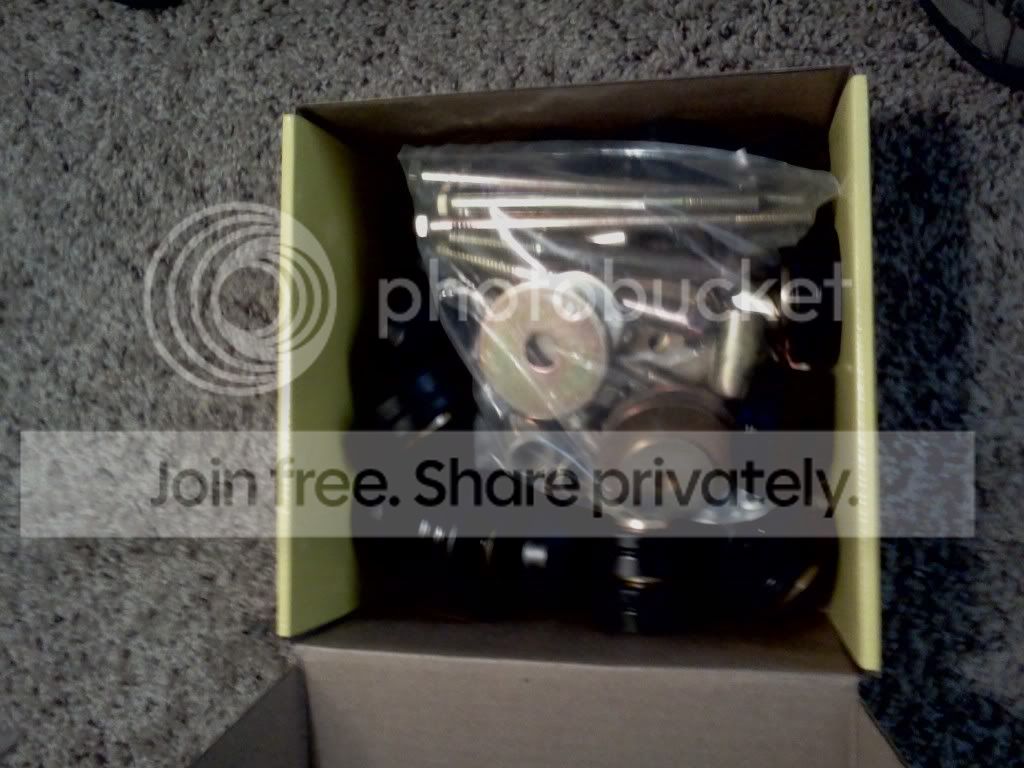

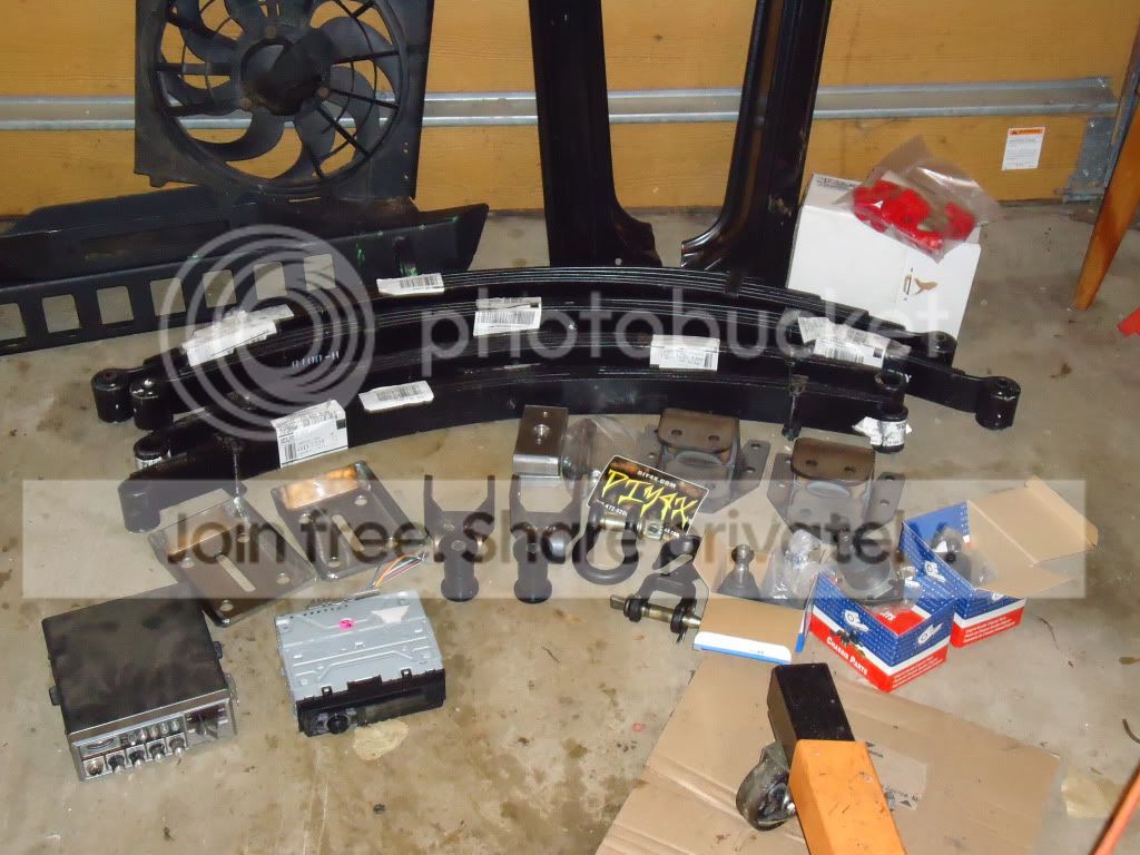

Finally my waiting was over PARTS!!!!!

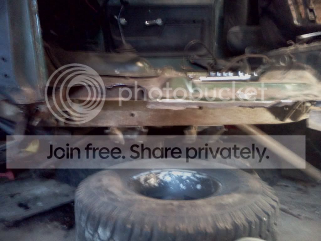

From the pic below, at least you won't have a problem finding the plate on top of the front cab support when you cut out the floor. :haha:

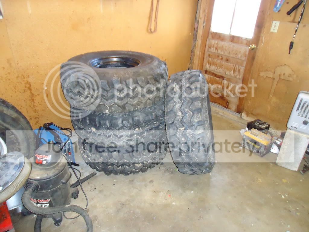

craigslist pulled tho on this one $1160 still had hair and blue line with 16.5 rims

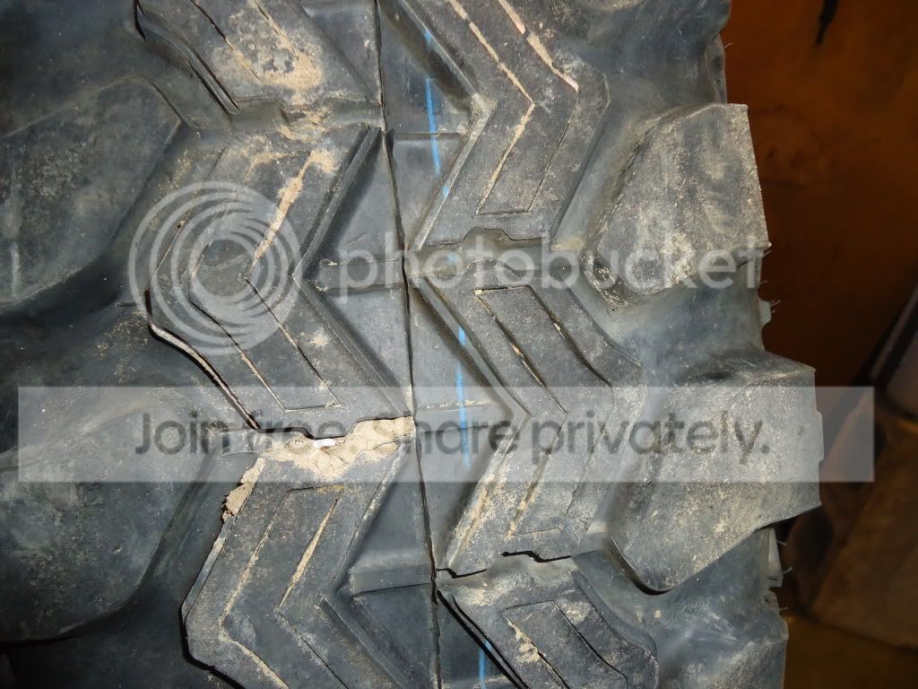

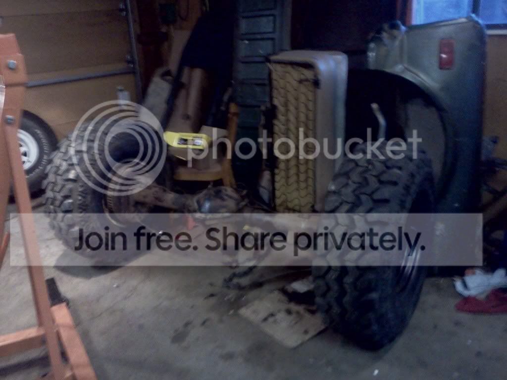

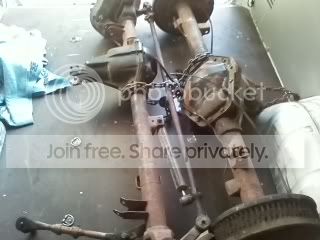

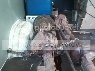

But wait what am i going to put them on they wont fit on the stock 72? Got it covered! i picked these up a while ago and they have just been sitting around.
got bord one day and bolted em up.

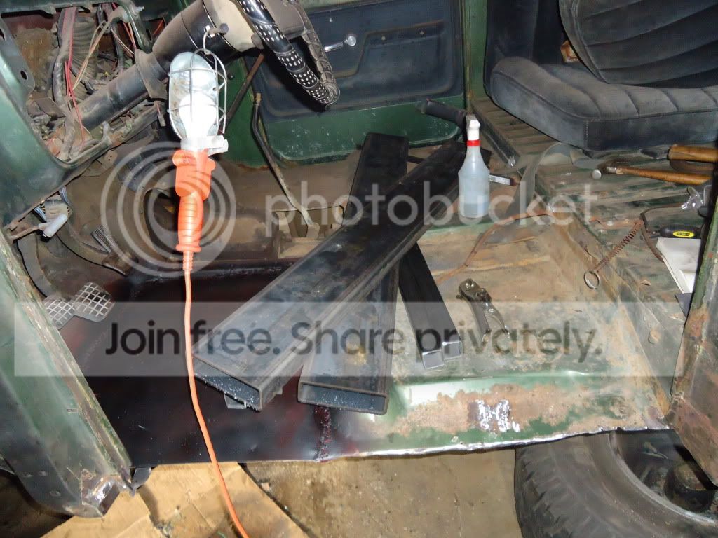

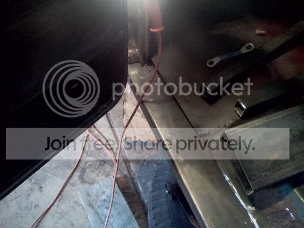

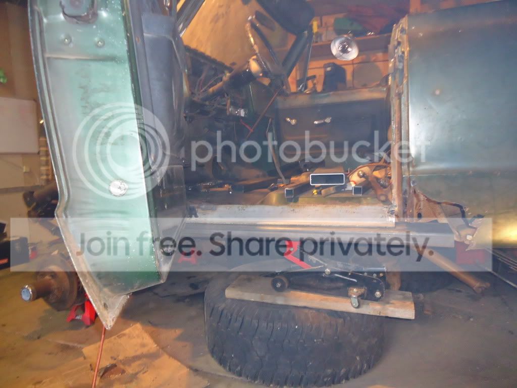

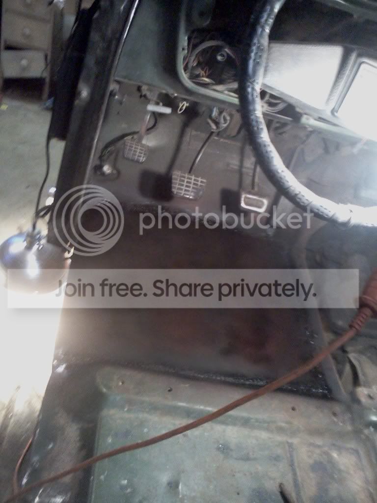

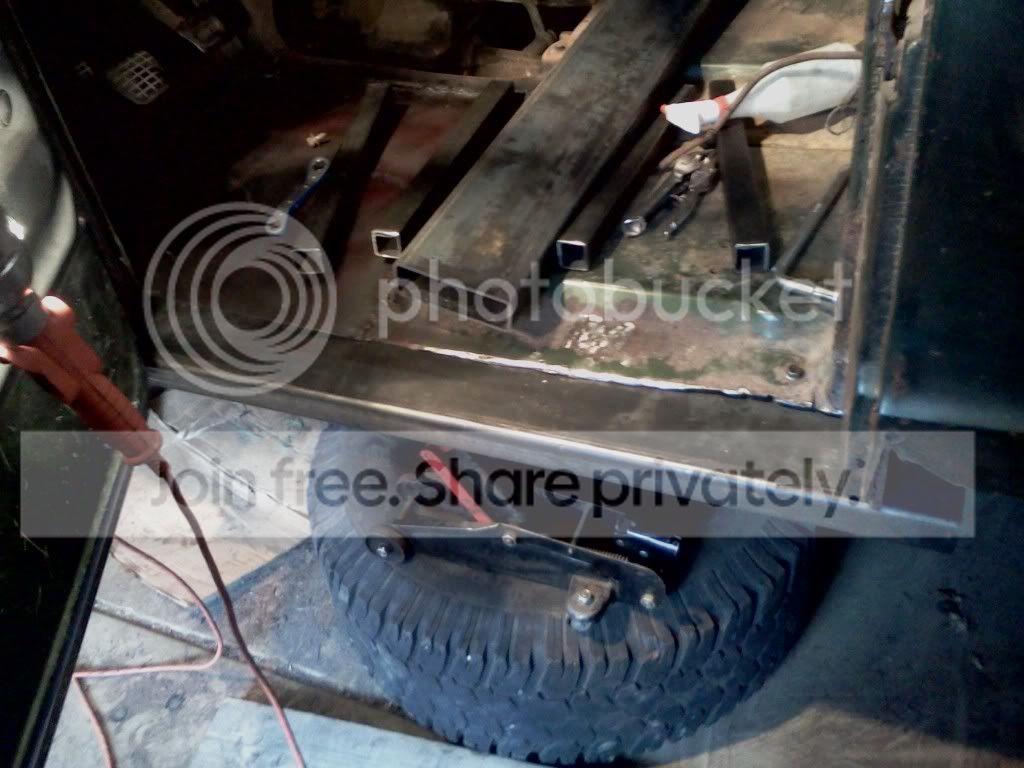

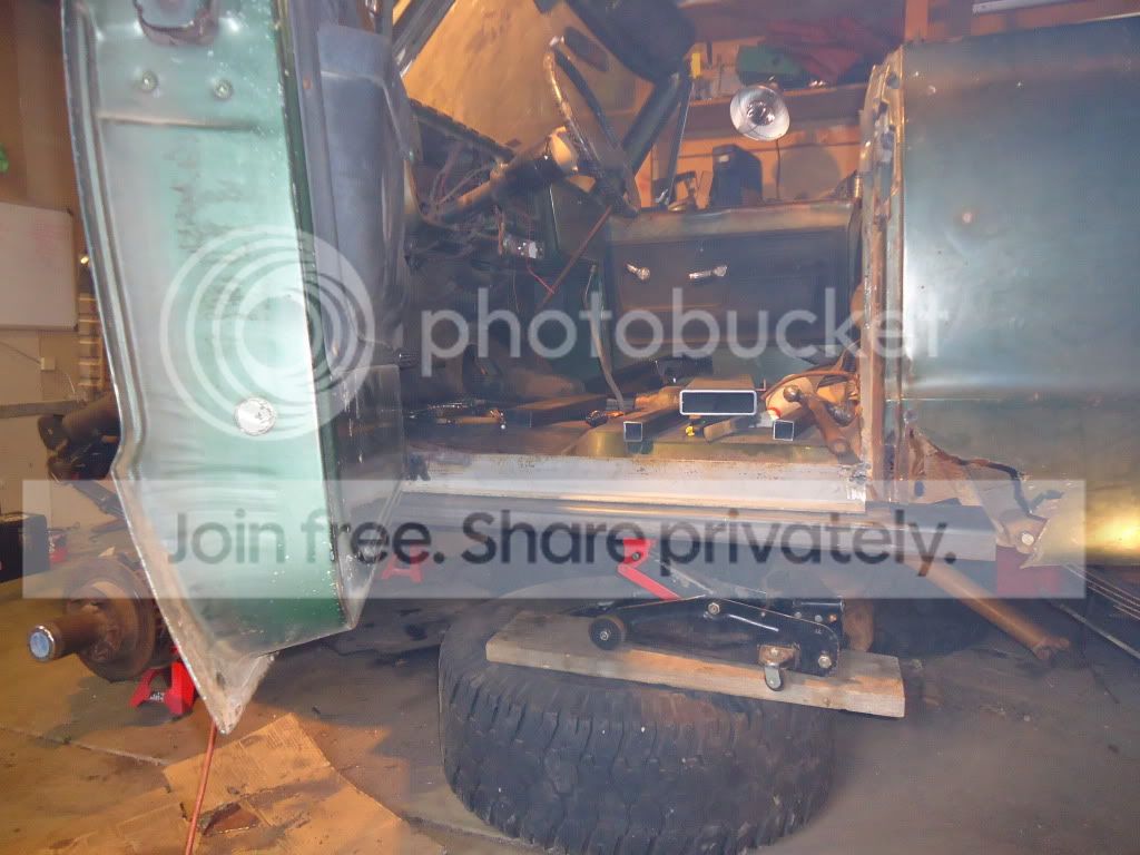

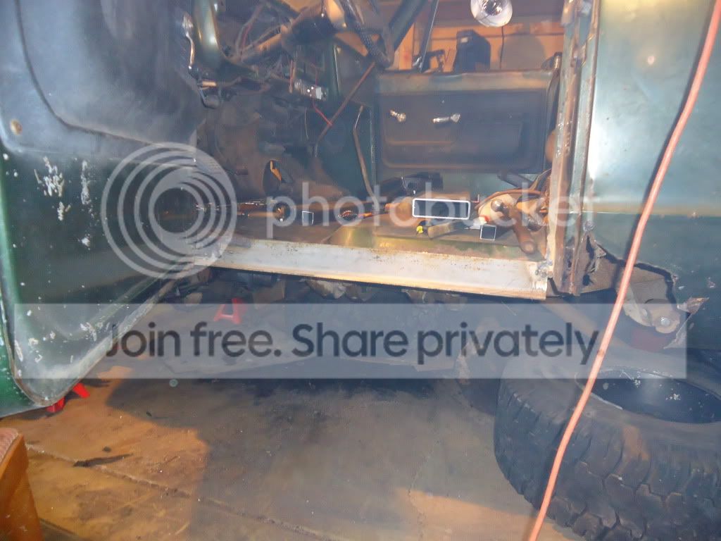

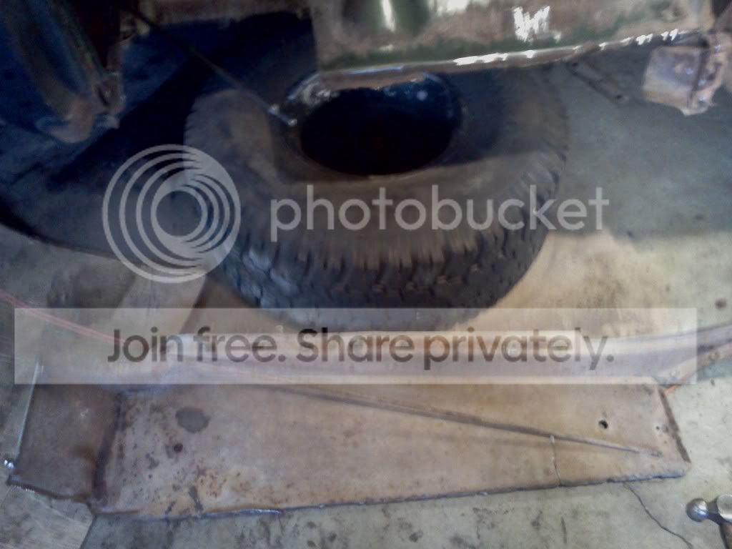

ok floor went from this
to this

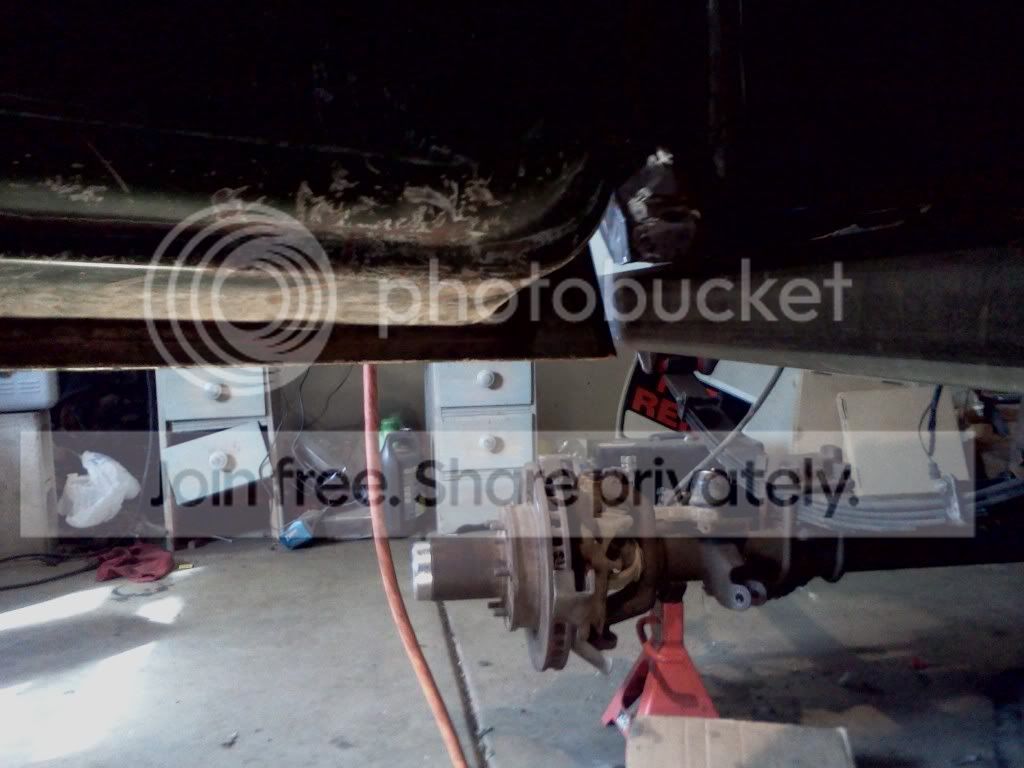

Rocker box is off and not going back on

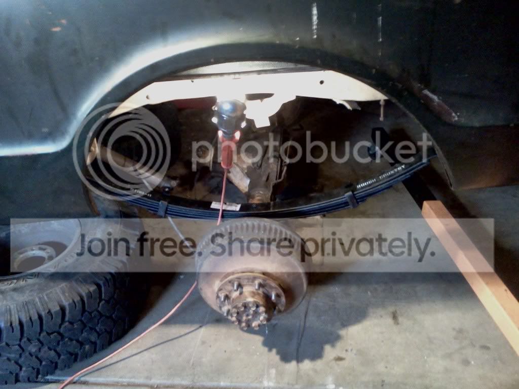

This pic is kinda out of order but you can see i cut out about 5.5-6" of body.
which will be replaced by this for more clearence

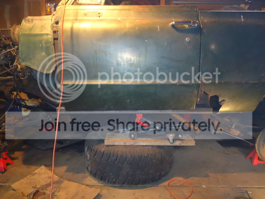

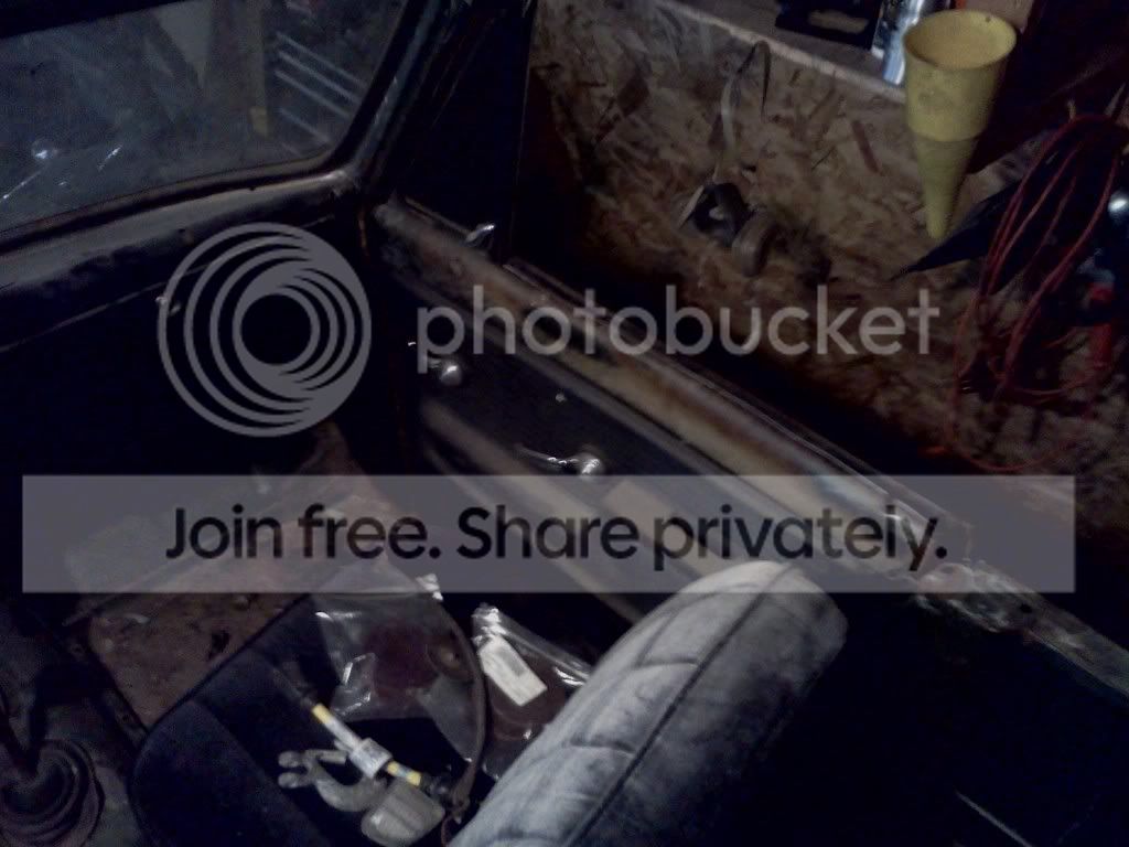

so here is the idea

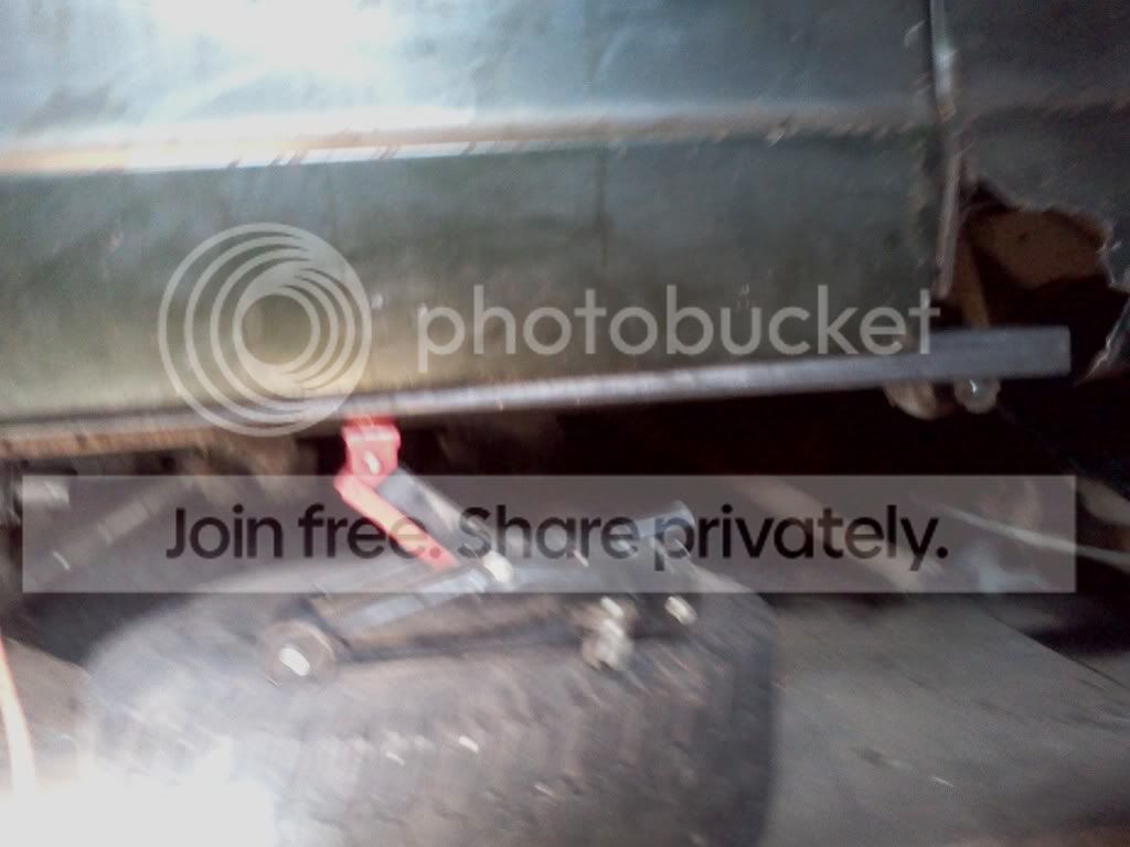

heres how much of the door thats going to have to be trimmed
from this angle it doesn't look like it's going to be that bad.
So a buddy of mine just saved me a ton of work a found out that if i just drop my slider 1" i don't have to cut my door kick butt!
that will save me some time there!

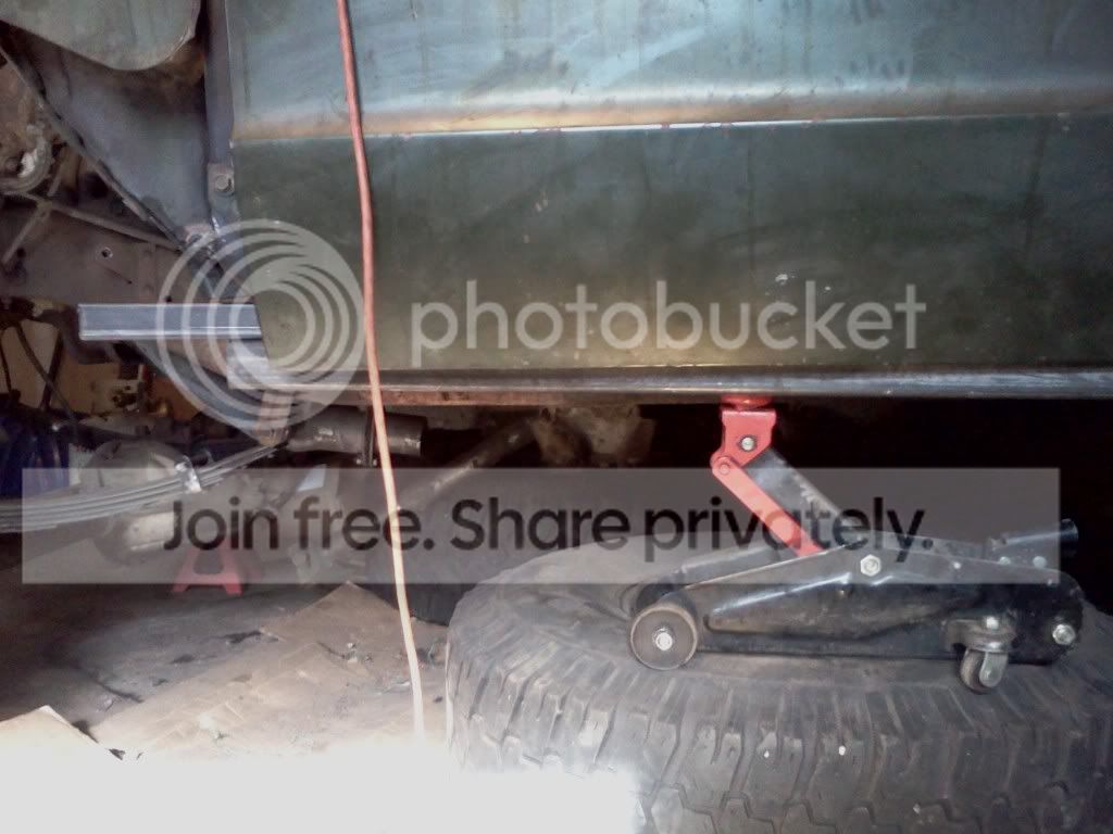

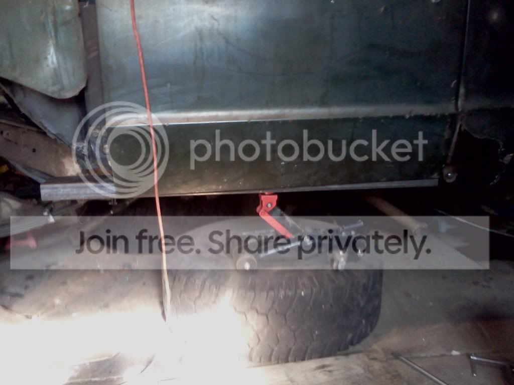

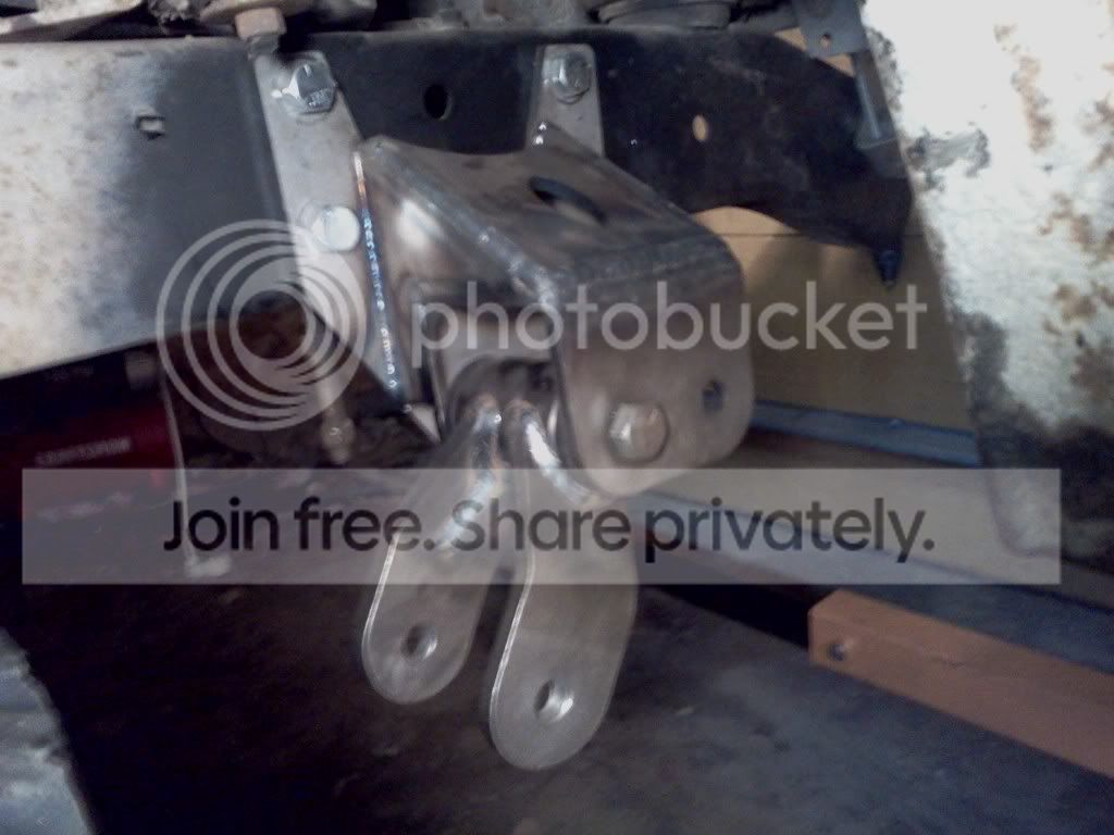

Found a new way to do the sliders that i like way better. This way there is also a lip to hold my crap in so if im at an angle and open my door the stuff stays in.
