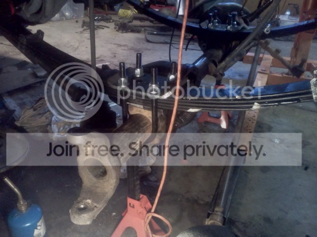

2wd steering box and xj mod installed :woot:
changed my mind and started back up on the crossover steering again and joints etc.

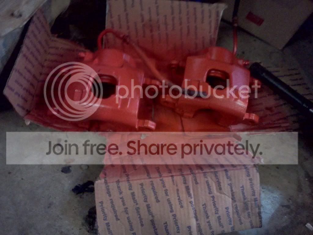

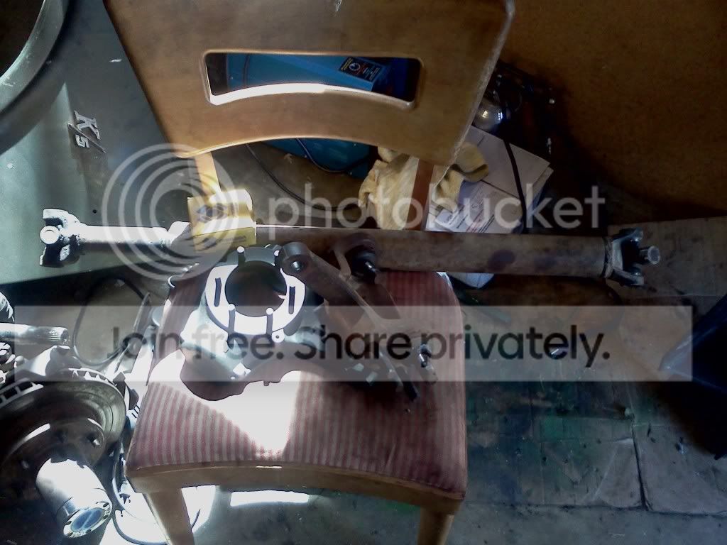

this is the knuckle i sent to sky
before
after machine i cleaned her up and alittle paint

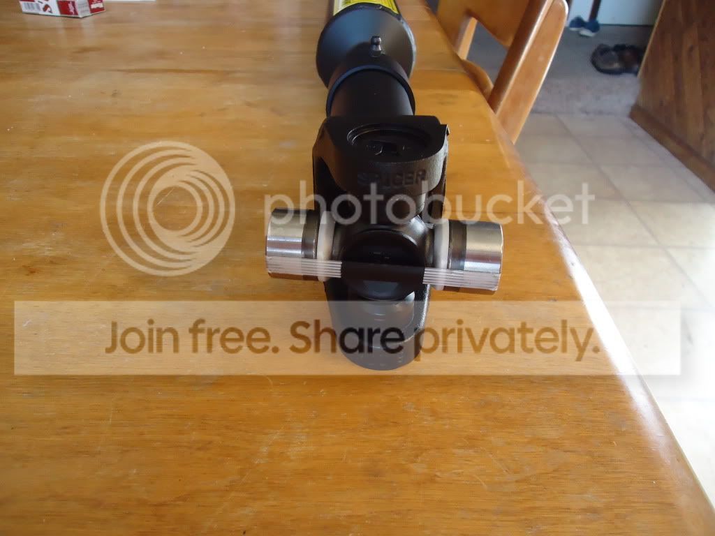

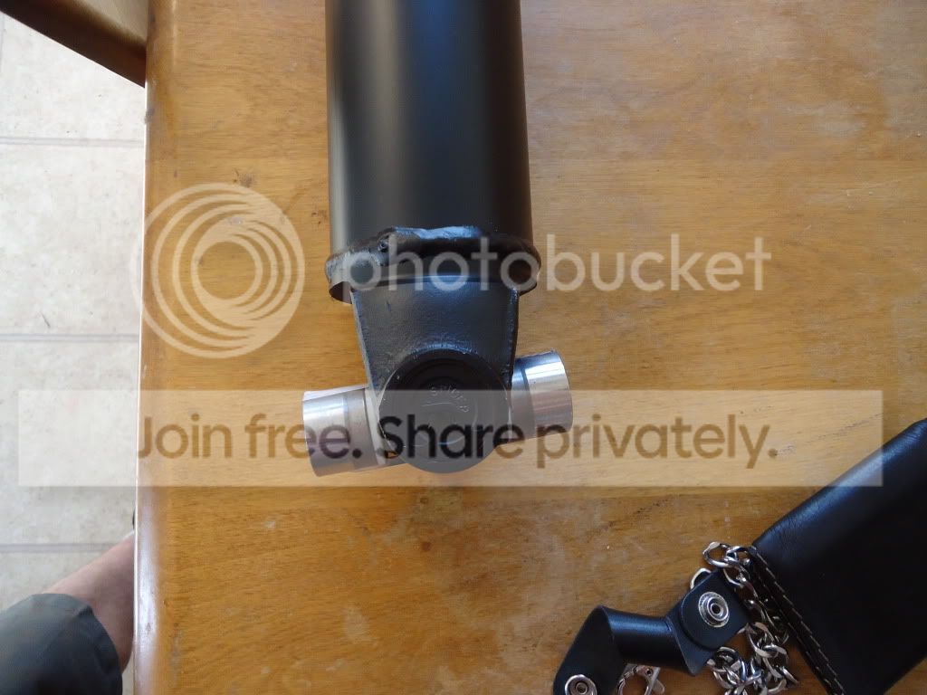

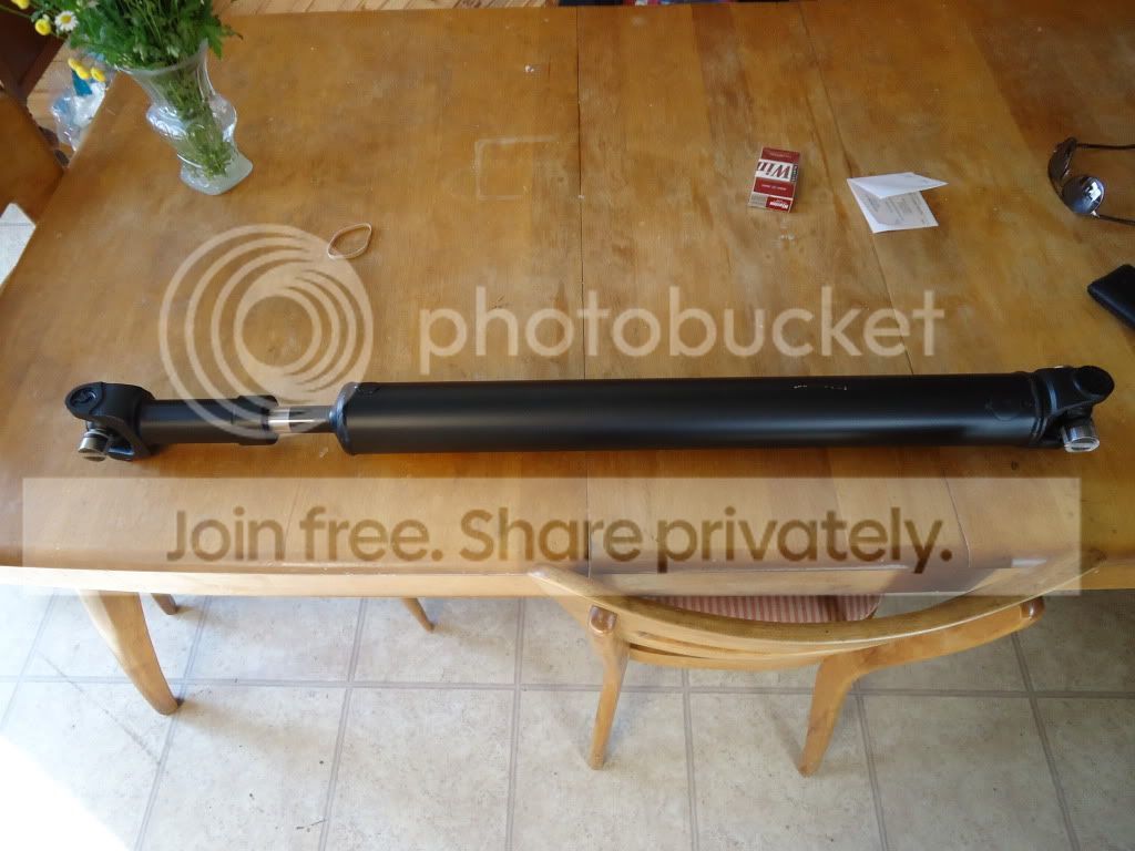

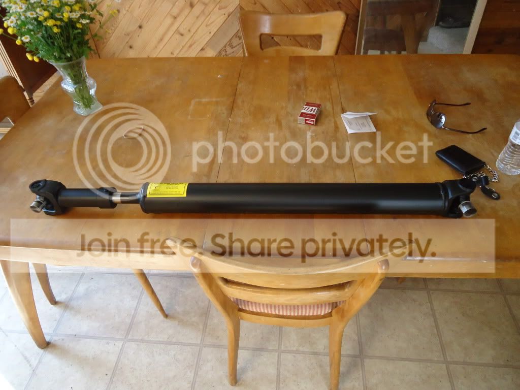

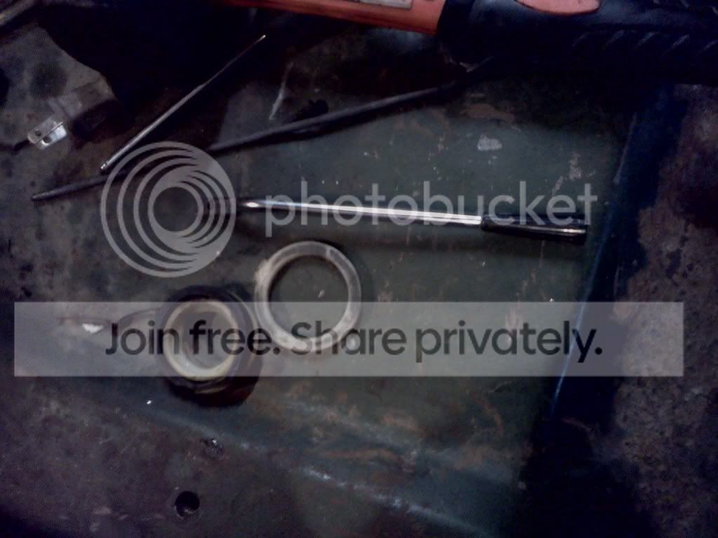

My driveshaft will be done today. Ended up getting a custom made one with with joint changed to match the 14 bolt. Cool! The tubing is 3" and of coarse all balanced. I should have pics tonight. I also got the ball joints installed in the right knuckle. It's a heck of alot harder to do by hand!
So this is what a $250 driveshaft looks like! LOL 3" tubing, balanced, 14 bolt u joint rear, heavy duty stock size u joint front, and extended for my lift kick ass!
sweet!!
wife: "what are you doing in there? that damn thing better not be on my kitchen table!!"
lol
Driveline services bouler co I tell ya this guy was freaking awsome!
My wife usally doesn't have an issue with parts on the table as long as there clean. LOL:waytogo:

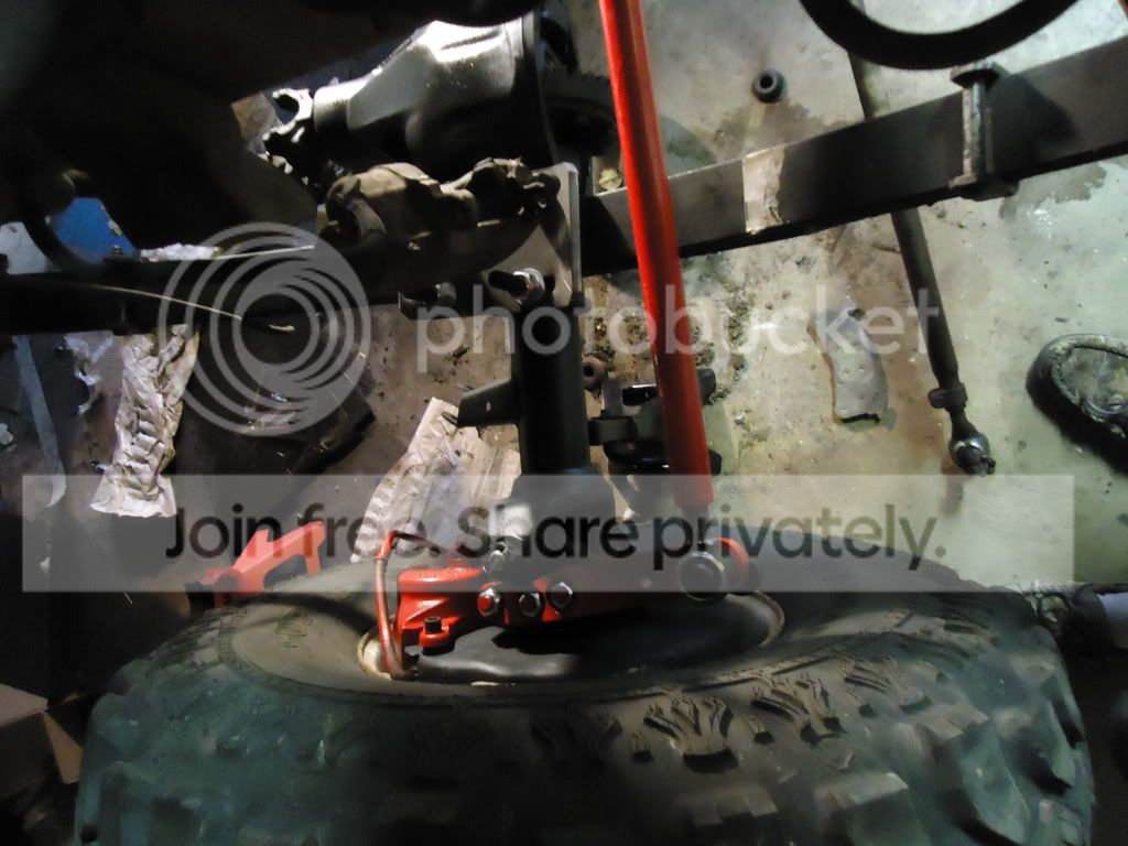

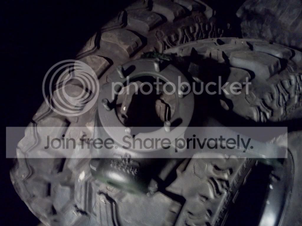

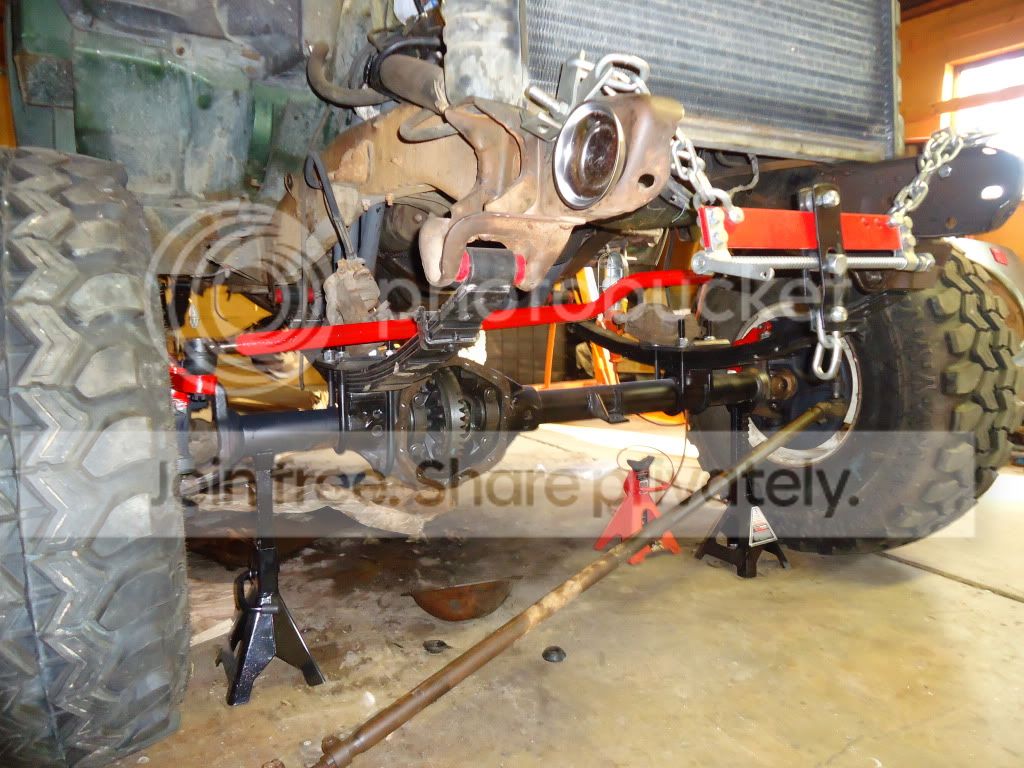

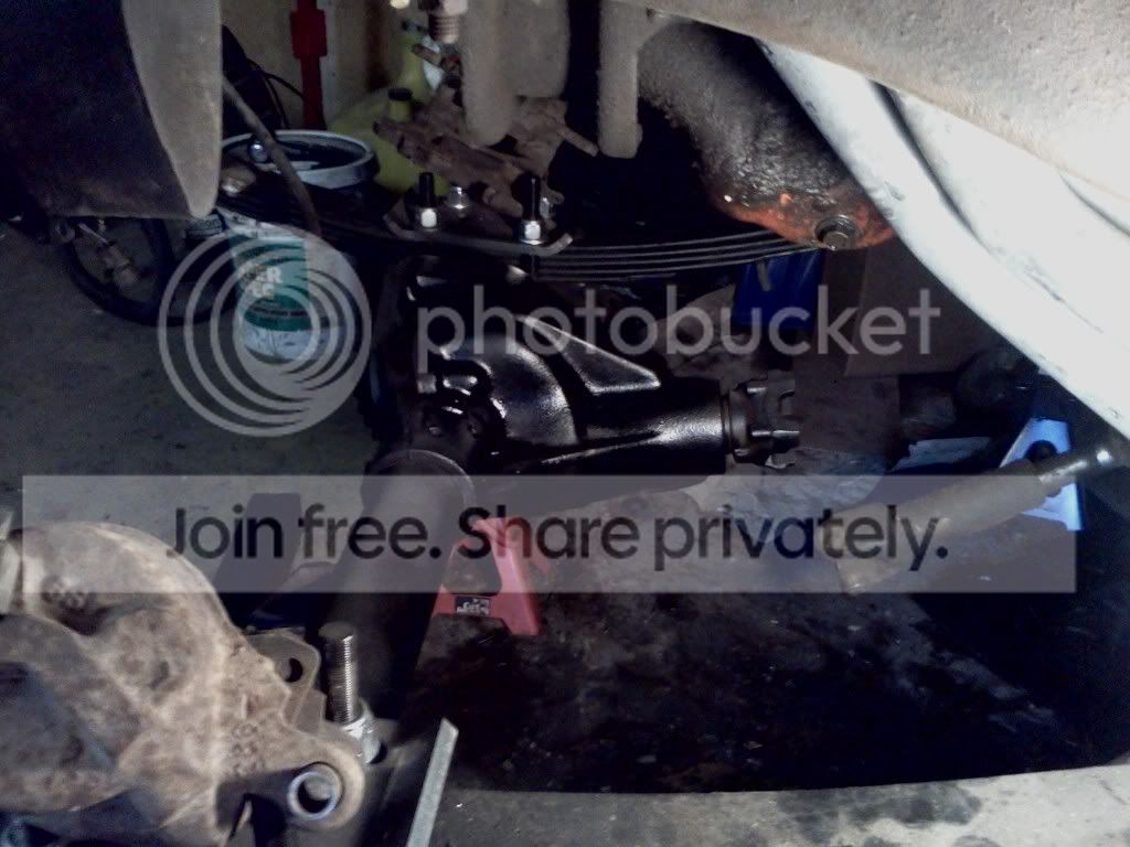

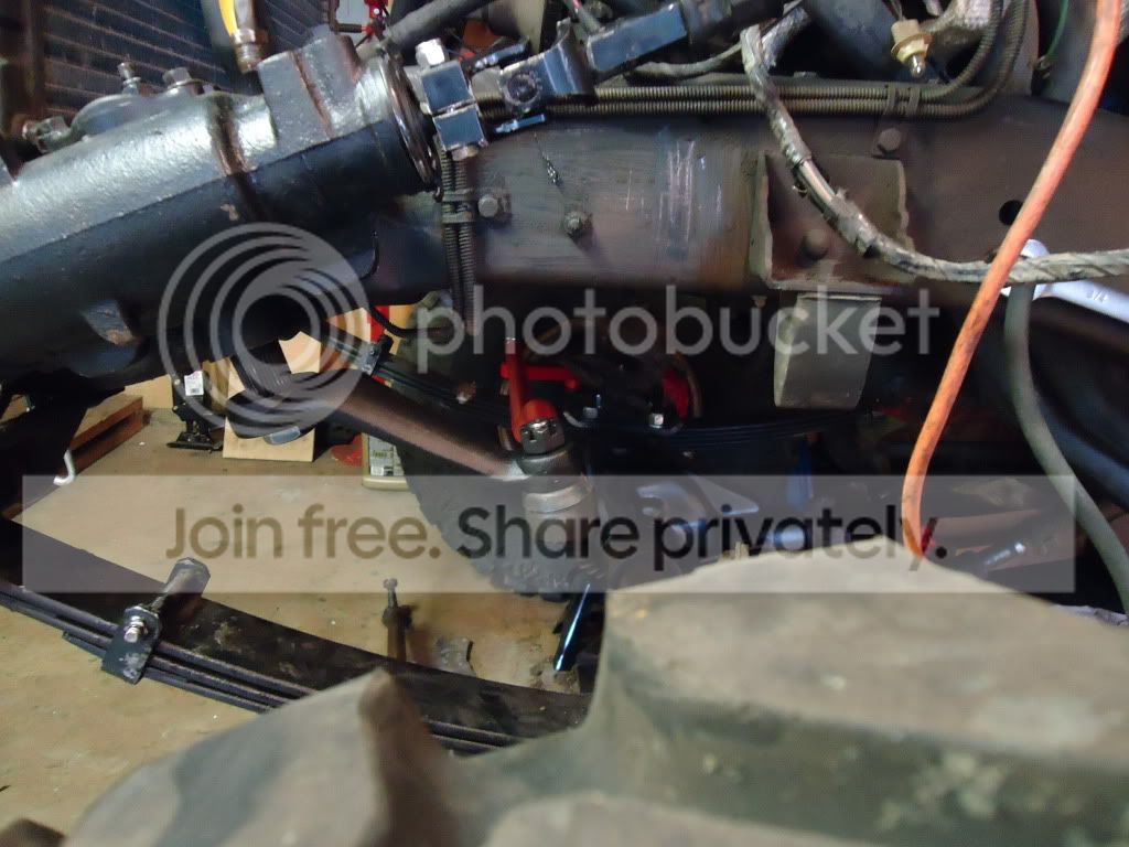

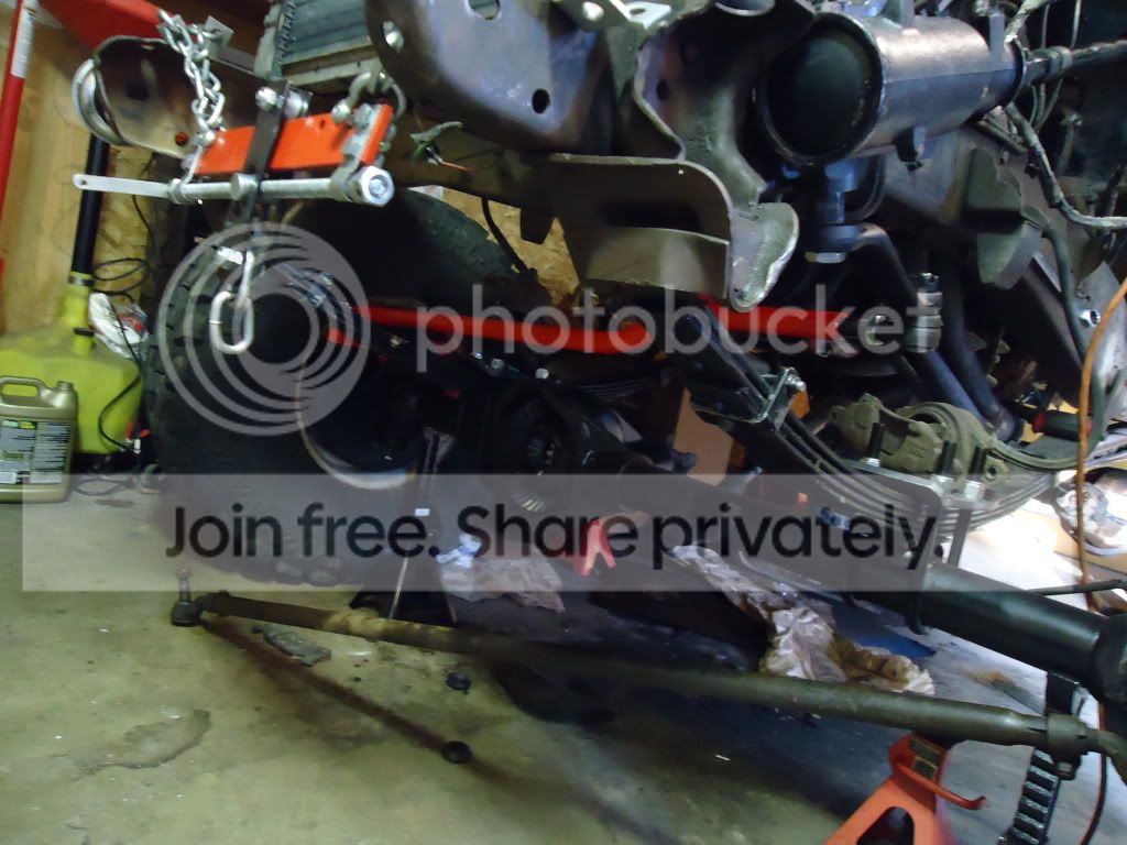

Just another update. Got stuff on but not tighten down. Tires are on and hopefully not coming off. Need to get the brake lines put on and the other tie rod end but thats about it. Then on to rear spring perches!

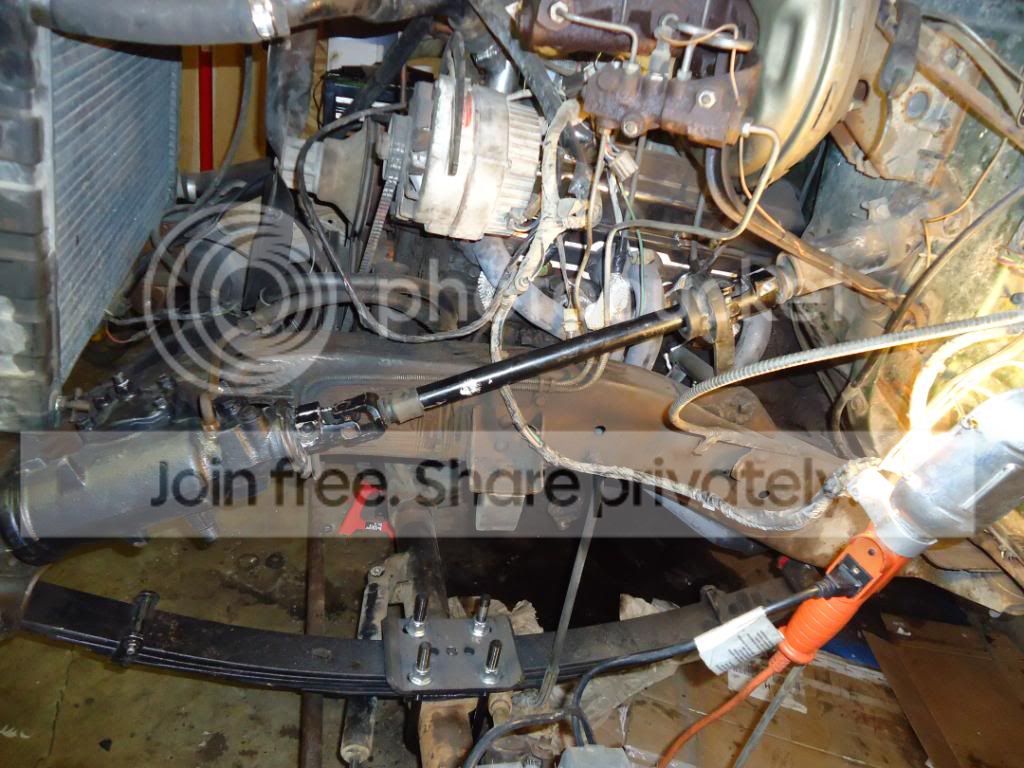

Not sure if you can tell from the pics or not but i let one of the liitle guys paint the steering rod! LOL Looks fine to me!
Good Progress..:waytogo:
Are you using a frame brace for the box, or is one on there and I can't see it?
hey, get em involved any way you can I say. looking good!
There is a weld in brace for the steering box if thats what your talking about. But i didn't do it. So i do plan on going with ORD bolt in also just because i can't trust someone else's welds on this old frame.
