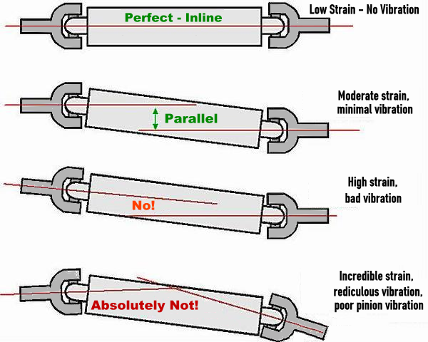

Are your angles out of phase ?
What are the angles for each joint ?
Might just be too much angle for that short of shaft.
And as said earlier you DEFINITELY need the yoke at the axle end of that shaft replaced - immediately.
Out of phase?
How would one remedy that problem?
I might be able to get LeVar Burton to use his phaser on it?
If the pictures where taken without the driveshaft moving it is out of phase, as mentioned above. Should have vibrating like a sob.
You should even hear/feel a good bit of chattering because of this issue.
And that is causing the excessive heat in that joint.
