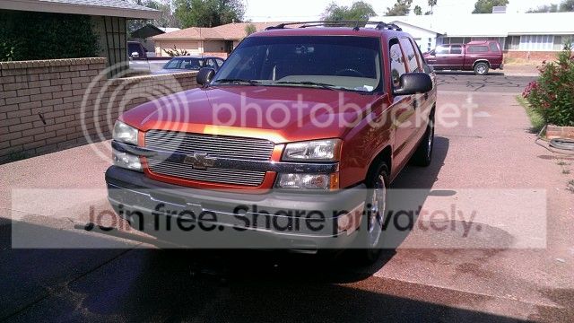

Just killed the transmission in the '05 Avalanche on our way back from SoCal vacation to Six Flags, Universal Studios and the BEACH :D
Guess the trip just got a whole lot more expensive.
Apparently, the "AUTOMATIC" transmission, didn't like the hundreds of hills it had to climb up and down through while out there, it kept going in and out of lock-up for one, I would manually downshift it into 3rd on the larger hills, but most of them were not seemingly enough for a 3rd gear drop to maintain speed.
Got the "transmission hot" dash warning on the climb on some hills entering Arizona (I-10) slowed it down a bit and dropped it in 3rd to maintain a locked gear setting, warning went away, didn't smell anything, but now it slips betewwn gears and slips if you hit it for passing gear situation.
Just called the trans guy I had do the Burb, $975 for a bench rebuild with minor mods to assist with slightly firmer shifts than it came with from the factory. Said there really isn't much else you can do to overly modify them since they are primarily computer controlled.
125,000 miles,,, kind of short on the life cycle, but I also don't know how well it had been maintained before I came around and did a doule fluid change within a weeks time to clear up a dirty fluid condition, so i'm guessing it was already on it's way out, we just finished it off. :doah:

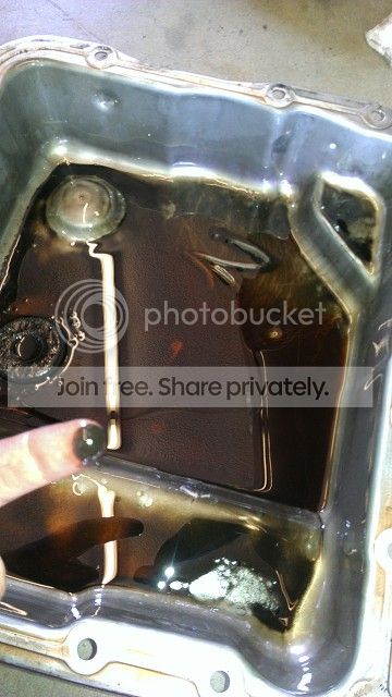

Probably once you got the transmission hot light, it was too late.
Of course, the heat may have been caused by slippage to start with.........
The heat was due to the already slipping, this trans was already acting alittle funny at times between gears since it was bought, I did a double trans fluid/filter change last year about this time, 2 changes within a week of each other because the fluid was already looking alittle on the dark side, it did clean it up a lot.
This trip just finished it off.

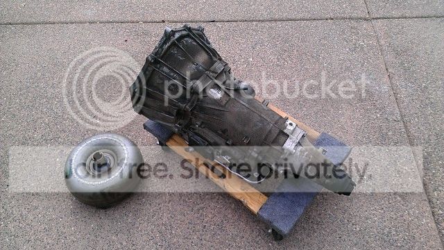

anyways, we just talked it over this evening over dinner, and apparently, I'm removing a transmission tomorrow morning... :doah: yay me :smirk:
No finances for a 4L80e, just going to get it rebuilt, with a few upgrade mods and call it good. :D
We already knew the trans was going to be an issue with this thing, we were just hoping it would last a bit longer until the funds were available alittle easier. I even mentioned starting to put money into a seperate bank account for repairs, mainly for the trans when it decided to crap out,,, too late :doah:
tiss all good though, will have a new-ish trans next week and be back in business again. :D

pulled a 700r4 pan 1 time with 3/4 inch thick layer on bottom.
drove fine dead cold. warmer tranny got the gears started droping off till no go. :eek1:
Removing ANY transmission is a PITA,,,as far as I'm concerned.
Just had a few different procedures than I'm used to with the older setups and as mentioned, I'm just getting too old to be rolling around under a truck like this. :D

Also once the fluid is dirty like that, best case is to leave it alone until the trans takes a dump. But putting in fresh fluid you replaced all the fluid that had clutch material in it from wear and accelerated the trans dying on you.
