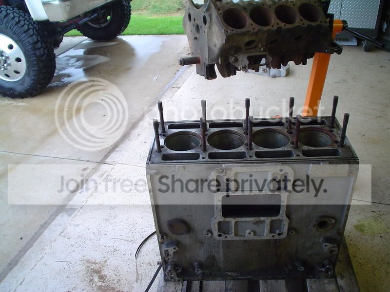

Here's the aluminum block I'm using. An all iron 4-71 would weigh over 2100 lbs. By using an aluminum block, front and rear plates, front cover and rear bellhousing, along with some other weigh savings things, I'm hoping to save 650 to 800 pounds.
The engine in the back is a pontiac 455 for size reference, although you can't really see how much bigger the Detroit is in this picture.

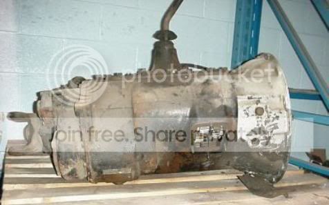

Here's a bad picture of the transmission.

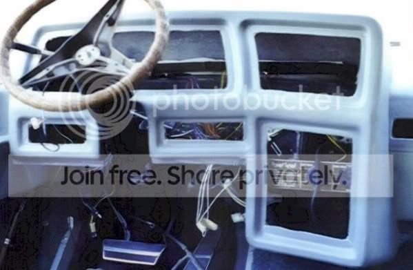

Here's closer to what I'll actually do for the dash...
CDA 455 said:
Well, is the engine built yet?????
It's already been 26 hours :D :p: !!!!
Almost, I'm only missing a few minor parts such as the crankshaft, connecting rods, pistons, cylinder liners, cylinder head, camshaft and balance shaft...:D
What will be the length of the stroke?
And what would be the maximum stroke length?
That looks like a very taaaaall block!!!
Here's the info from the service manual. It seems a little small, but keep in mind that every stroke is a power stroke. There's not much messing around with bore/stroke like you might do with any conventional engine. When the engine is worn, you replace the cylinder liners and go from there. A guy I know is boring out the block to accept the 92 series cylinders and pistons, but it's a lot of machine work and you're cutting into the air dam and water jacket. I'm keeping the displacement stock. I'll ceramic coat the top of the pistons and maybe put some kind of coating on the skirts, but other than that, it will be all stock.
I used to own a '72 Pontiac GP with a 455.
That Detroit has similar numbers in the bore.
Try to find oot what the maximum stroke is on that motor.
5 inches :eek1: :eek1: !!
I wonder if you can squeeze another inch oot in stroke.
So, you're talking aboot 500-600ft-lbs of torque :D !
CDA 455 said:
I wonder if you can squeeze another inch oot in stroke. So, you're talking aboot 500-600ft-lbs of torque :D !
I doubt it. Not without major reworking of the block, cylinders and crankshaft. Air enters the cylinder at the bottom of the cylinder (even though it's 4 valves per cylinder, all 4 valves are exhaust valves). At about the time the piston reaches BDC, it uncovers the intake ports. These ports are cast into the block.
I'm hoping for 350-400 hp and 600-700 ft-lbs. I believe this is obtainable while obtaining 15-20 mpg based on what others have have achieved with similar style builds.

I would recomend a different transmission setup than to run the 13 through the 205 and then the brownie. I assume the brownie is there for the low gears it would give you. The problem I see is parasitic drag from the extra box. What about running a RTO 11909LL. It gives you the same overdrive ratio (.73) and gets you a deeper first gear than the 13. Low low gear would be about 26.8-1. I think this is a popular dump truck tranny. Weight is about the same at just under 700lbs. I saw the overdrive feature of the brownie but that takes lots of torque to pull.
