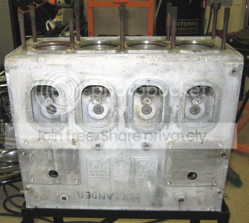

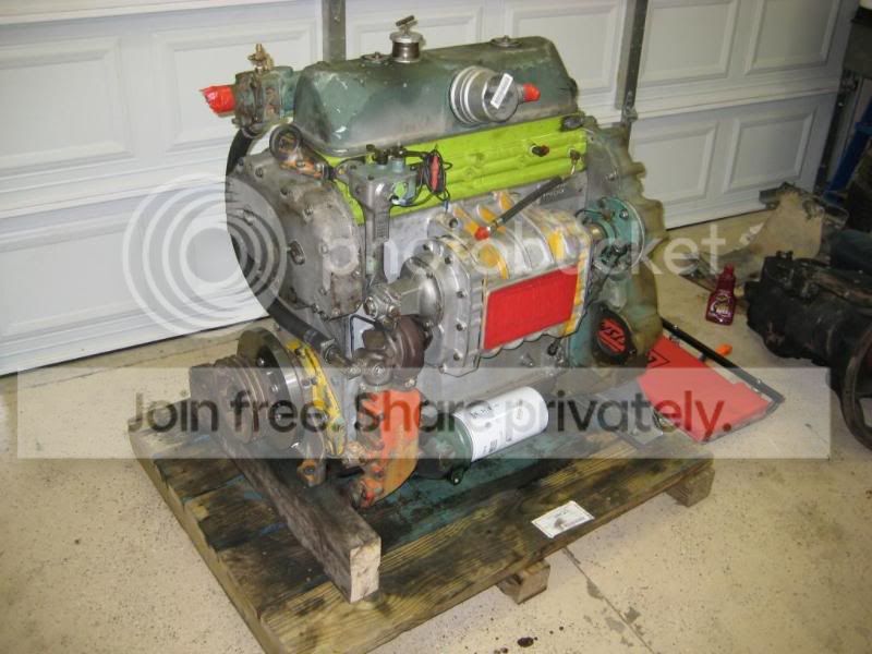

As of right now, my engine is built. Just to recap, I started with an aluminum Detroit 4-71 block.
I've been collecting a bunch of parts. From the big stuff like the crank, rods, head, turbo, etc. To smaller stuff like the exhaust flange, oil cooler, etc.

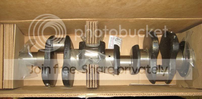

New crankshaft (found it on e-bay for $100)

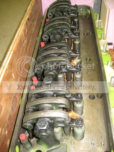

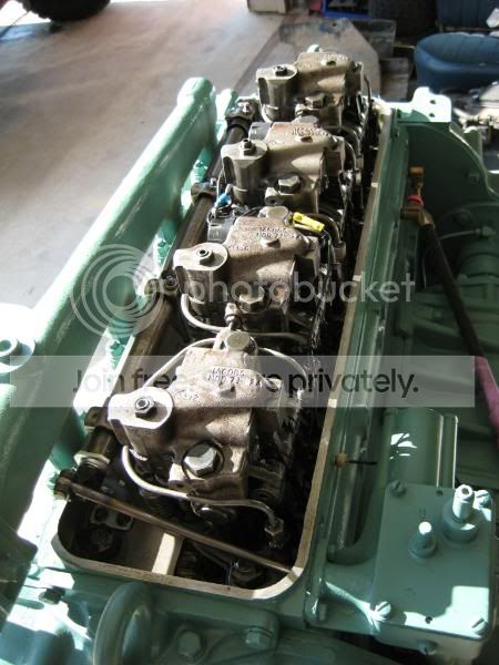

New four valve cylinder head. Jake brakes will be added.

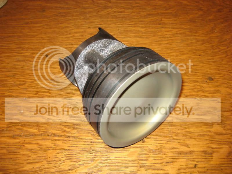

Pistons are the heavier duty two piece with the domes ceramic coated and the skirts teflon coated.

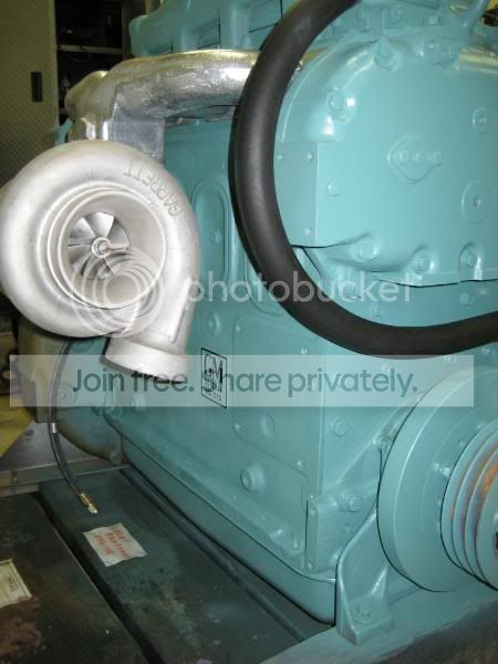

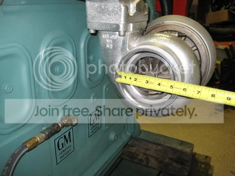

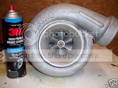

Here's a picture of the turbo. Think it's big enough? :wink1:

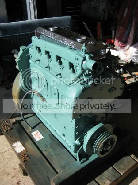

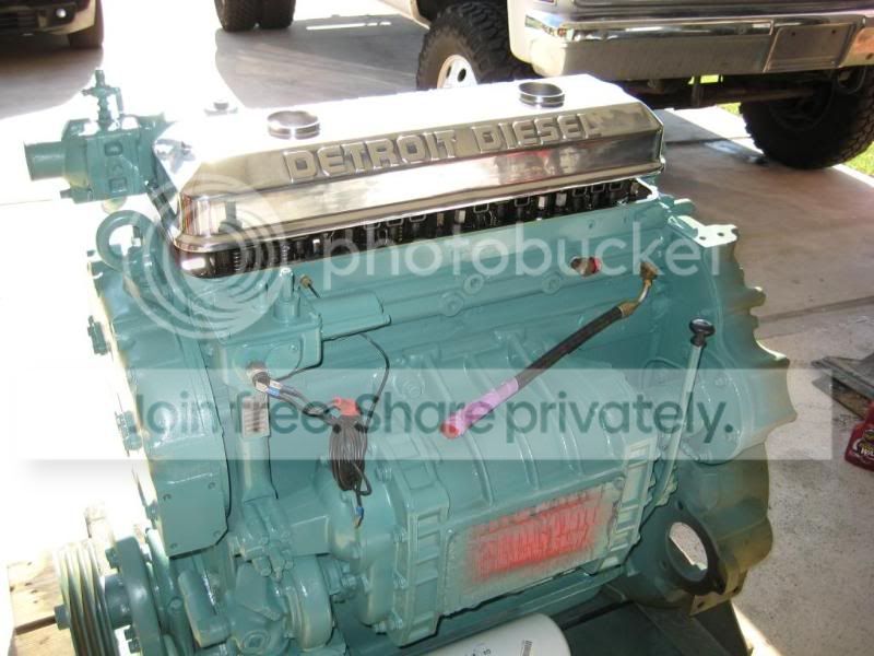

Anyway, here's a picture of the engine fully assembled.
Painted the engine Detroit Alpine Green and added a nice shiney polished aluminum valve cover.
Jake Brakes are in!!! My neighbors are going to HATE me!

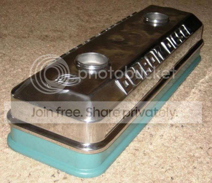

Polished valve cover doesn't fit with the Jakes. :doah:Going to have to make a spacer.
Well, I cut the top off of another cast aluminum valve cover and TIGed the bottom to the shiney one. That should do. And, it'll stick up a bit over the water manifold and should be the first thing you see when you pop the hood.

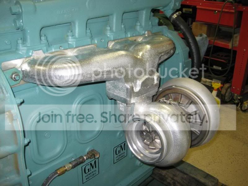

Jet hot coated exhaust manifold and turbo housing (exhaust side).
I'm planning for a five inch downpipe and then it'll open up to seven inches under the cab and to the back. I'm thinking about doing the stack straight up through the hood, but my wife is against it. She says (and I quote) "The truck looks redneck enough already without the stack through the hood". :rolleyes: I'm still thinking about doing it anyway.
Front shot of the turbo.

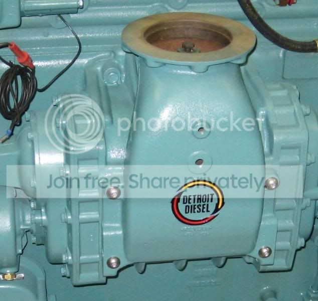

Here's a shot of some intake detail.
