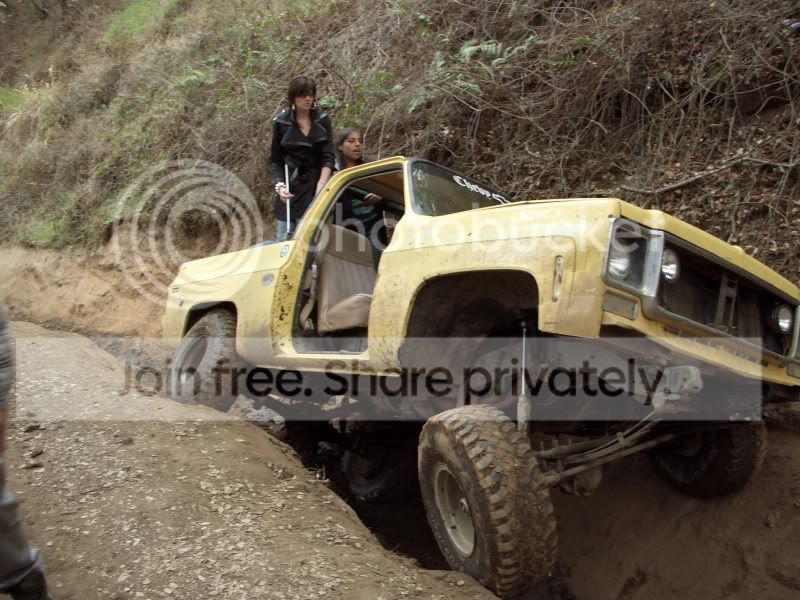

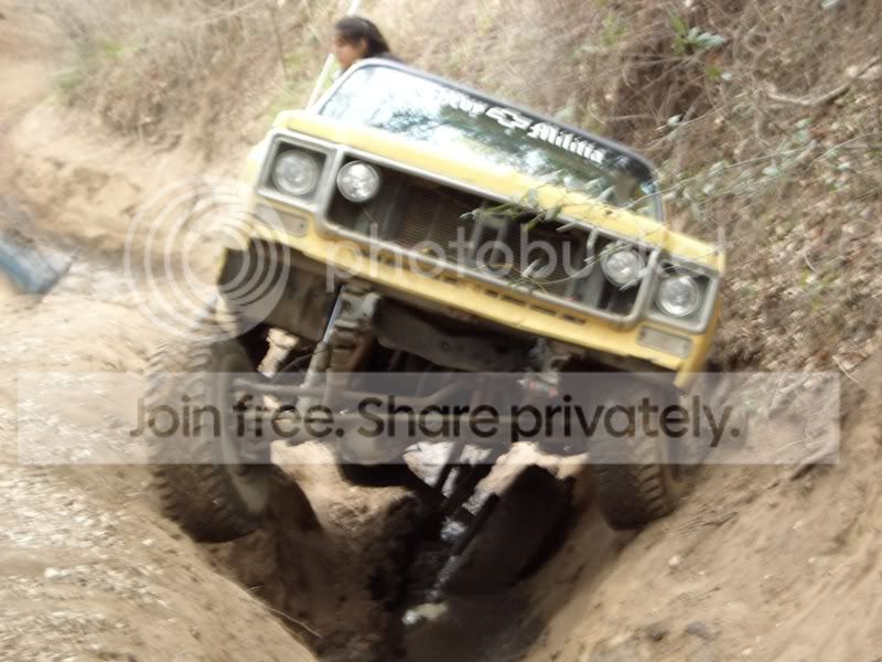

That seems pretty good lizard, you runnin anything special or just the stock shackles, with the 4" springs. How bad do them 36's rub or did you trim it up with only runnin 4" lift?
4" lift springs in front, 4" blocks in rear, stock broken leafs in rear
Minor rubbing when turning during flex.

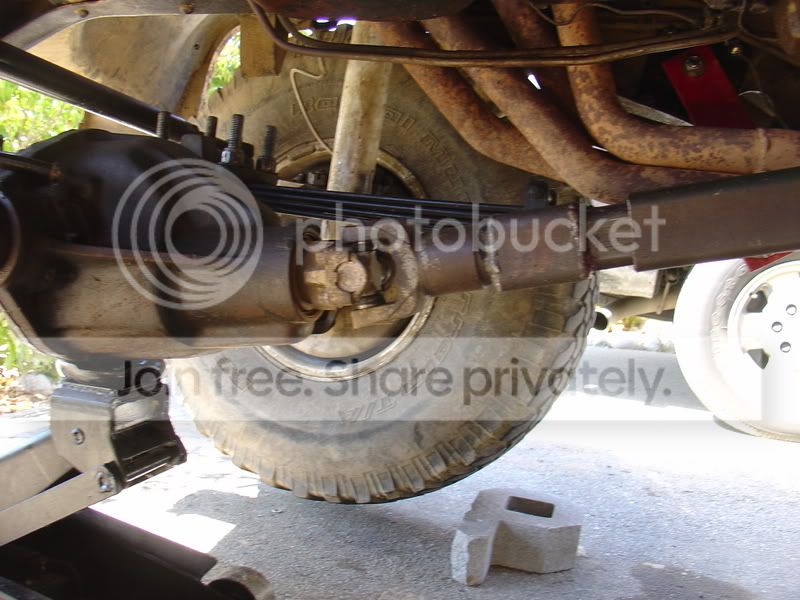

But cant you make a Front d-shaft out of 2 squair tubes and then have super long slip shafts?

Yup thats what I did for my front (the rear is still the stock one, that doesnt need any extra slip cause the diff is centered). Cost me about $30 in materials and works great.
