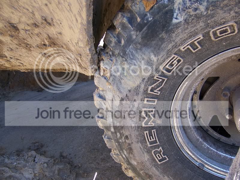

The removal of the sway bar and also relocating the shackle mount and using a 7.25" shackle helped me tremendously.
does doing that mess with your steering geometry any? it seems if you put it right it wont mess with the caster angle or whatever it is called. how dod you know where to put it?
I got a peice of paper and made a templete of the bolt holes and hanger hole, then just reused the upper front bolt hole, clocked the hanger alittle and drilled new holes. It didnt mess with how much lift or anything, sits about the same. This made the ride much smoother, lots more articulation up front, and is super cheap.
