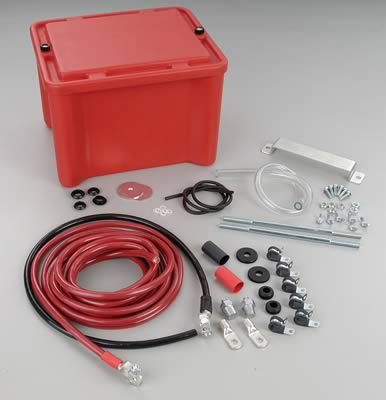

http://store.summitracing.com/partdetail.asp?autofilter=1&part=SUM%2DG1230&N=700+115&autoview=sku
OR
http://store.summitracing.com/partdetail.asp?autofilter=1&part=SUM-G1230-K&N=700+115&autoview=sku
In regards to your first post and "I always keep tons of crap in the toolbox and would hate for something to short the battery out."
Think about it. My answer would be a resounding NO.
There are cheaper enclosures thou. But not as stout.
I think you could bolt down a plastic el cheapo tool box and then use a universal battery hold down inside the box to keep the battery in place. You could even make a little tray out of 1" angle and bolt through that through the plastic tool box and into your tool box, then a universal battery hold down to keep the top from moving around.
