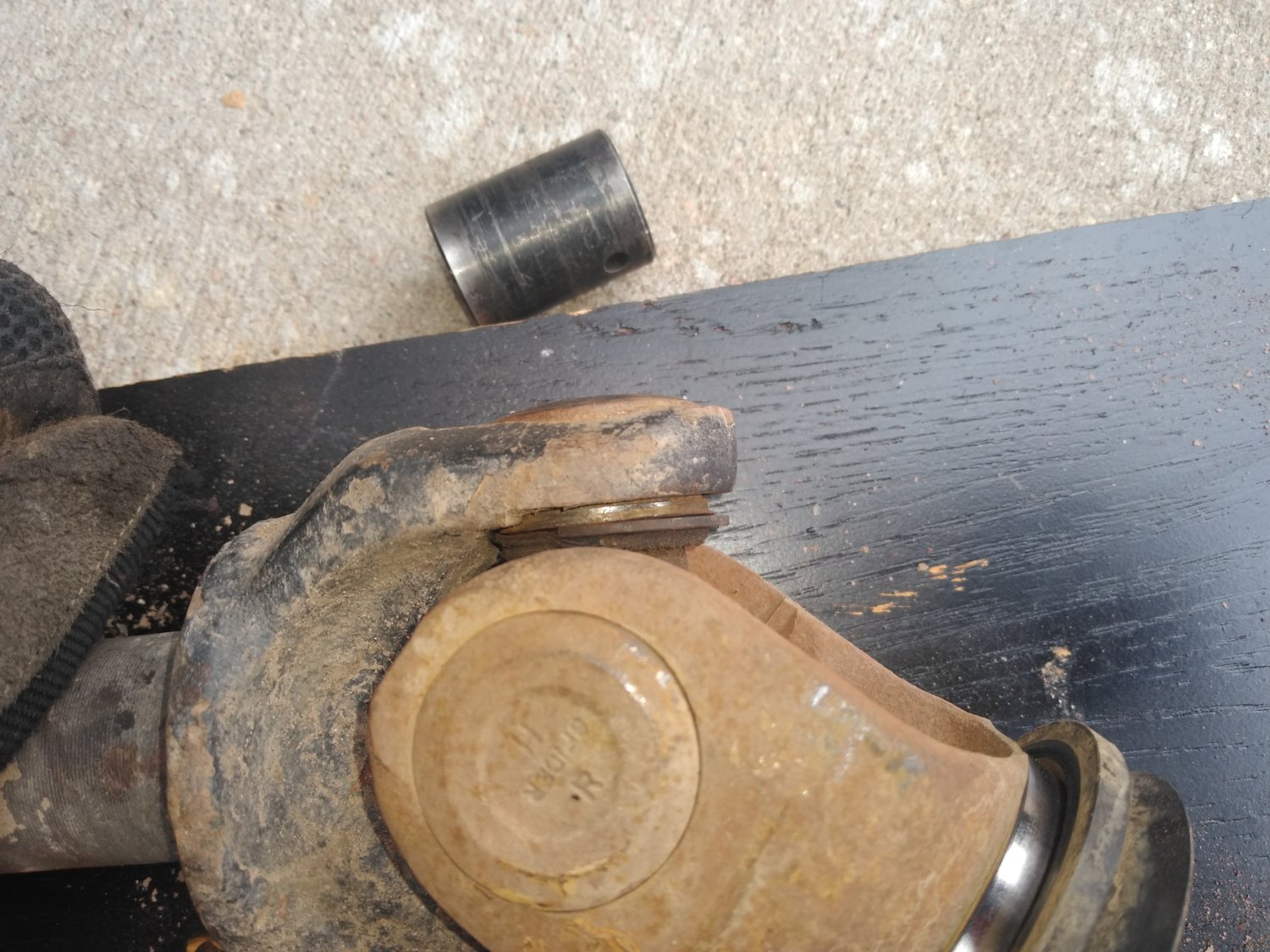

One item had been nagging at me. Noticed a u-joint cap walking out of the yoke on the right front a while ago. Considering my track record popping them in the past I figured I'd pull it apart and make sure its right.
Here it is. It was stuck out enough it would not pull through the knuckle. Had to pound it in some just to get the shaft out.

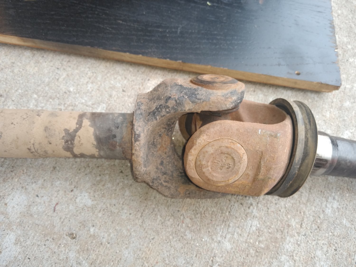

Once I got it in enough I yanked the shaft out to finish it up.
I thought the clip was missing but you can see it's not in the right groove.
Got the clip put back in the right groove and slammed it all back together. Good to go.
Good catch!
