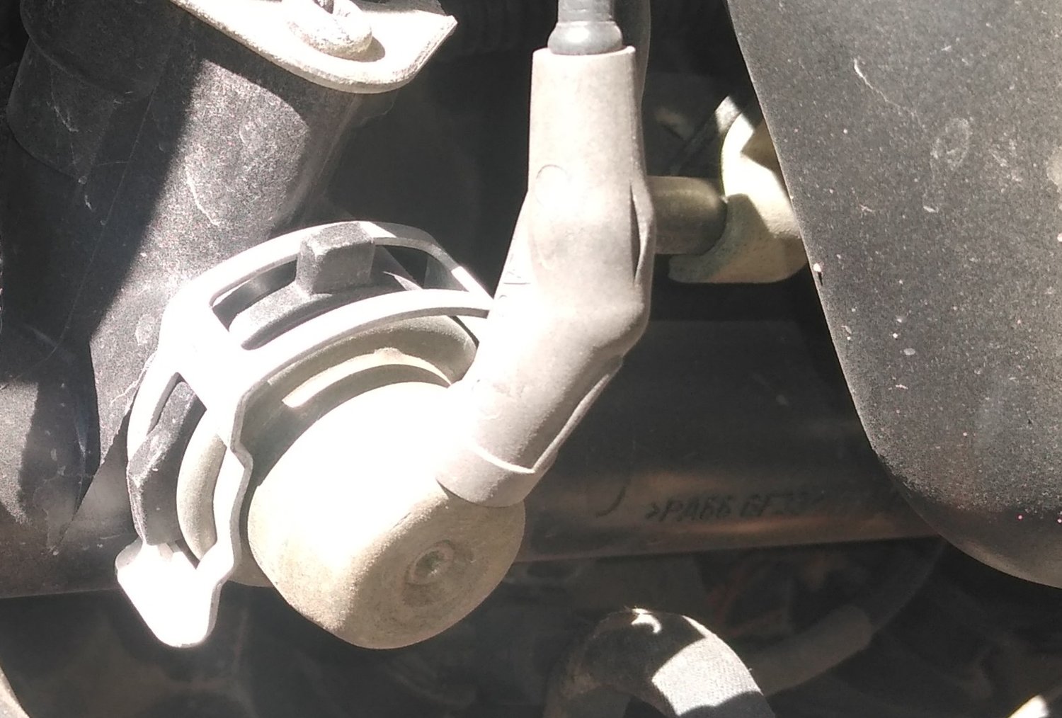

Well I pulled the #2 plug out and found a nice white tip with a little tan on the backside by the electrode. I'd share a pic, but my phone took a crappy one. But let's just say it was good enough not to proceed to pull the rest of them. But as I was putting the plug back in and I looked up and saw this little item...
The split is in the boot of the vacuum line to the regulator. It looks to go all the way through. It's not much and the plugs don't show excessive fuel, but I'm going to get a new boot for it anyway. Max fuel pressure due to a lack of vacuum at anything less than WOT probably isn't helping my fuel economy but it's probably not an issue big enough to make a radical change in MPG. Probably grasping at straws at this point and the mileage is more dependent on my right foot anyway.
