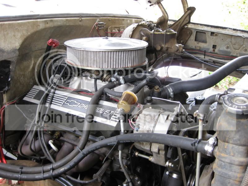

Got any installed pics?
not the greatest pic,
no finish, these were the only ones they sold at the time (2003) so I didn't have much options...I was just impressed on how they fit, for how tight they are to the frame rail. The headers or bbc is no longer in there anymore as I have a tbi350 now, but that is a pic from last year and if I were to keep the bbc, id have them coated or try to find a coated set just like it...

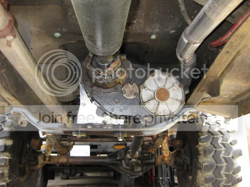

I got these because I've always hated the look of low hanging exhaust that's in the way and cluttering up the undercarriage. This time I want my exhaust tucked up tight and out of the way, I'll run a single set up down the driver side where there's tons of room (instead of snaking around the clocked up t-case).

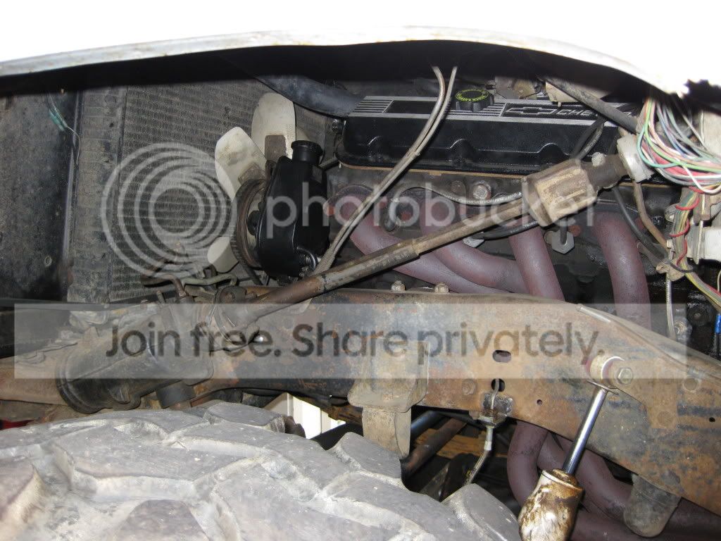

I went with Doug's header's ceramic coated paid 350.oo for them lifetime warranty on coating and headers i believe. 2 years old have not changed any of the gaskets and there are no leaks. I had to trim the frame on the pass about a 1/4 to 1/2 and 2 inches long for one tube but if you run kirts motor mounts i think they would clear. You can see where it hit the heder and left a little crease this was from the motor bouncing down and flexing in the stock soft motor mounts. I think kirts would solve this problem i have not upgraded them yet.
If you check my build on the first page i have some pics of the motor and headers going in.
