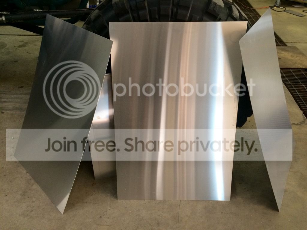

I drew up this bomber frame and had one cut out of 16g steel. All the rivet holes needed to be drilled out.
Ended up using them as templates to lay some out on aluminum panels for later.
Now I just need to get the brake here so I can bend the flanges....

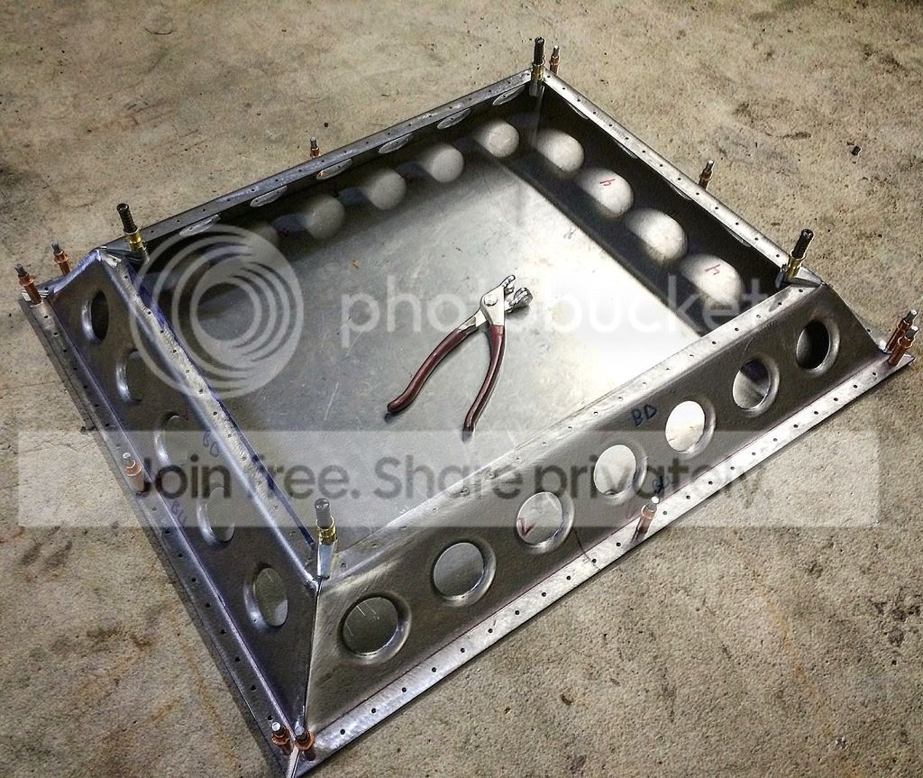

Got to play with the new toy today. Once adjusted it works pretty well. This is 16ga steel and it did it fine IMO. A bit more of a radius than I had expected, but it looks nice.
There are a few things on the brake that I'm not very happy about, but for the price, you cant get too upset.
Spent another 4 hours or so on the frame (most of which was grinding out the holes so the dimple die would fit, the table must not have been cutting on the correct side of the line)
