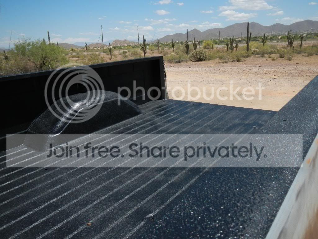

I used raptor by upol for the bed, got it on amazon, so far it's been fine in the Arizona sun but only been on there since early spring. Think I got the gallon kit which barely covered the bed and tailgate.
Then I used monstaliner on the interior, it's more work due to the roll on, and the texture isn't as "sticky", but it rolls on thick, more so than the raptor. The second coat is where the texture shows up.

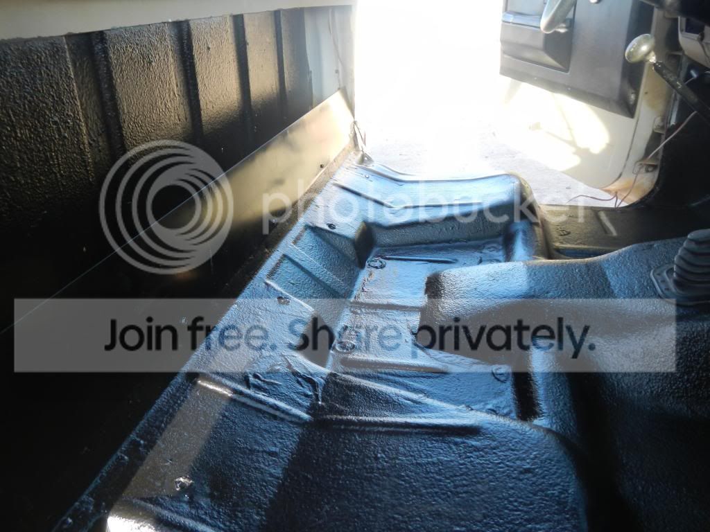

I did my interior with Monstaliner. It went on great and has been holding up very well. Tough as nails so far and its not rubbery.
I used the rollers they supply as well as the sponges for the tight spots. I used 2 gallons for the complete floorpan areas, bedsides all the way up to the rails, and the tailgate.
Total cure really took about 3 weeks. But I'm also in a pretty dry environment. With a higher humidity level it would probably have cured much faster.
I think your second pic is the finish i'm after right there. Thick and a bit smoother.
