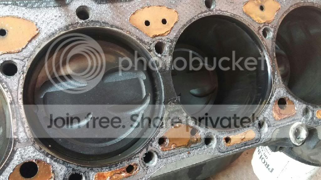

So I gave the motor out of Bertha to Avery4jc to make a coffee table out of or something,but if it wasnt complete garbage we talked about fixing it and selling it.
Heavy scoring on #3 and #5 that a .030" oversize bore probably wouldnt take care of makes it a coffee table :haha:
Some MIA head gasket between #3 and #5 also.

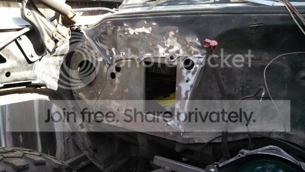

So my little Lincoln SP100 did what it does best today and welded up some holes :D
I rough finished the spots I welded and cut stuff and shot it with a little primer. I still have some welding to do and some Bondo but this is the progress today .

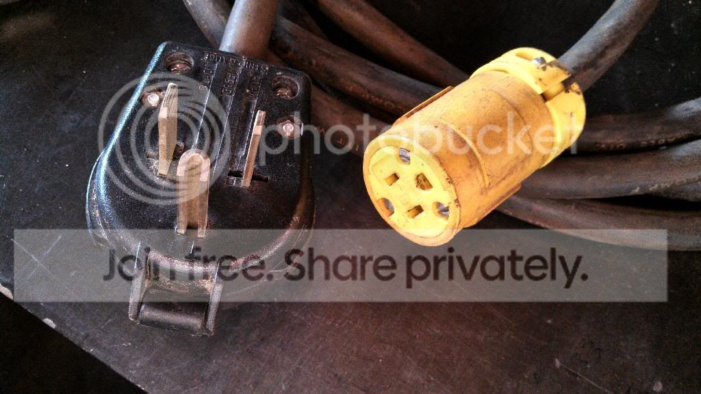

And a little 110v welder tech :sign28:
I did this because I got tired of the cord getting messed up. Being able to unplug the power cord is nice.
And the absolute key to your happiness with your 110v welder when running off an extention cord is to make an extension cord for it like this :pimp:
The hot leg goes to one terminal,and the common is tied into the ground.
