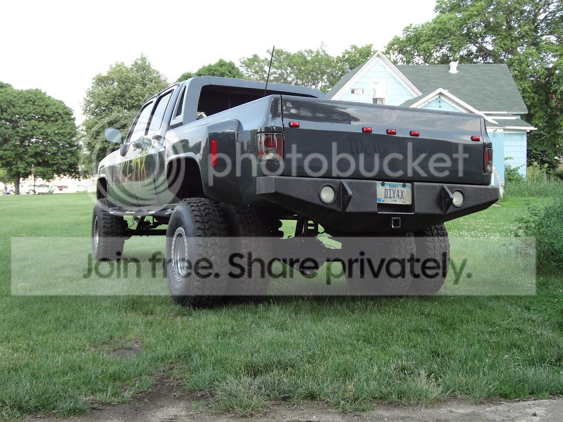

try
try this setup on the snow and ice. It's a ton of fun when 21 foot of truck comes around beside you.
crew cabs are fun to blow
BIG donuts in . feels real wierd first few time having somthing that big swinging around . also fun to prove people wrong on the fact it WILL do it. :thumb:
