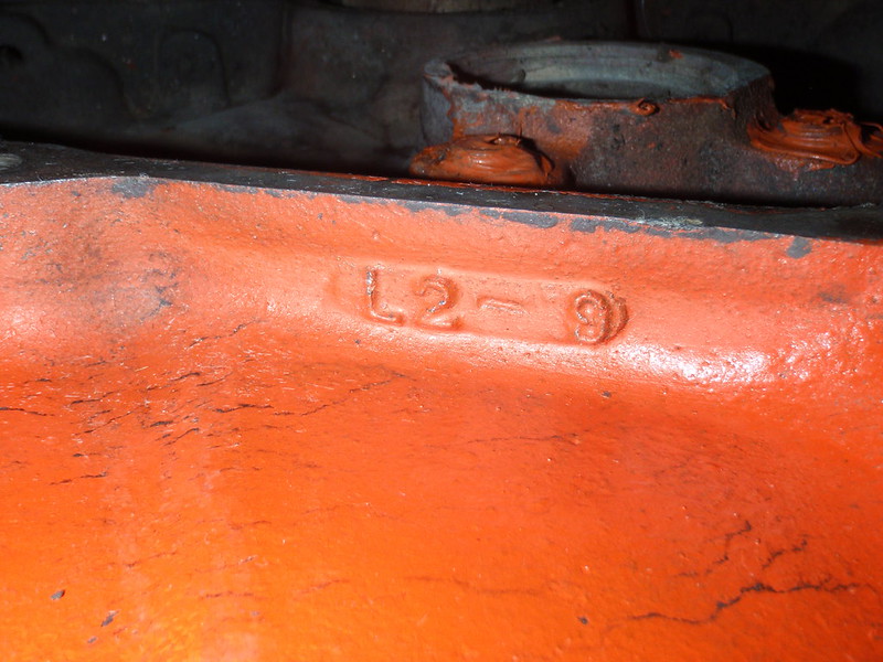

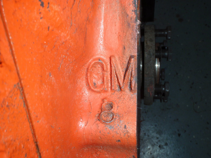

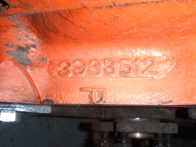

Anybody any good at identifying older big blocks? This one is supposed to be a 427 but looking for confirmation.

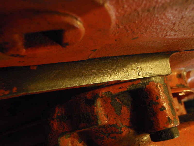

RH deck on engine block in front of cylinder head
CEO76872
LH rear bell housing flange
3963512
Next to the number above
On RH rear bell housing flange
On block above oil filter. Also says Hi-Perf Pass on the back of the block inside the bell housing area

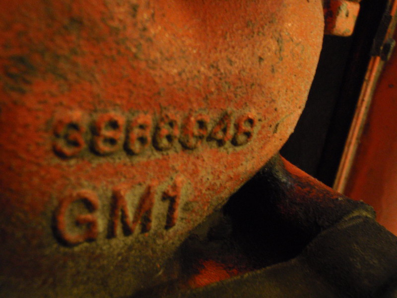

Intake manifold

That block was used for 427 and 454. I would take the pan off and get the crank number. Then you know for sure
If i am not mistaken there was also 2 diff 427s, one that is the desirable one that everyone dreams of, and one that had a real oddball tall deck, 3 compression ring monstrosity that came in real heavy duty trucks. If you have the good one congrats, they are a badass motor and they have a cooler sounding CI, it just sounds more muscular than 454 IMO. LOL
That block was a 427/454 base casting...with that casting date I would think it was for a 454 application, but the CE in the stamping could be either one.
The heads look like closed chamber castings, perhaps 65/66 years...do you have a date of those?
As mentioned, you really don't know what you got until you start measuring bore/stroke.
I checked a little pocket ID book I've got and came up with the same thing. When checking the heads though, they show to be for a 396.
Also, this is a regular short deck block as there were no 454 tall deck motors.
As for the "Hi Perf Pass" markings, those are common on most passenger type big blocks so it doesn't mean there's anything special about the motor.

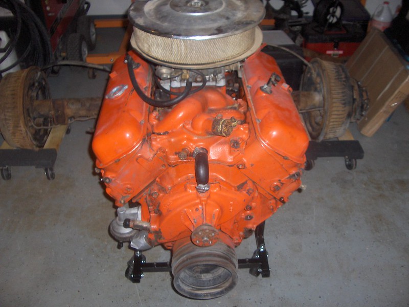

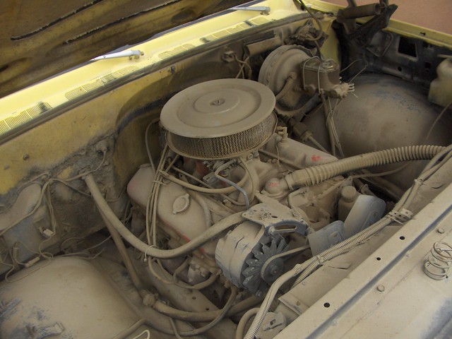

Edit: it's hard to tell but it looks like an early, short style water pump in one of the pics.
I would guess a 2 bolt main as well...the oil cooler plugs are different sizes...oil cooler/4 bolt blocks were both the same size....but again, many variations.
That 3512 block is valuable though to the numbers matching guys....maybe 500-1000$ for a good block.

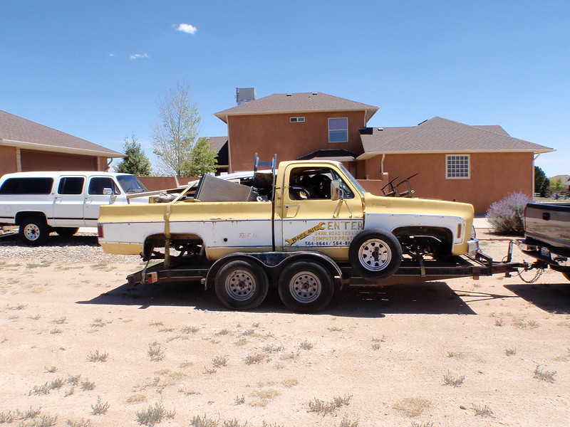

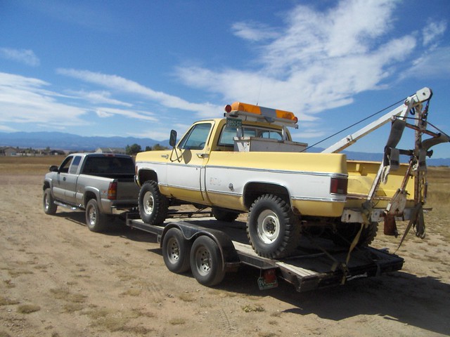

Before dismantling the truck

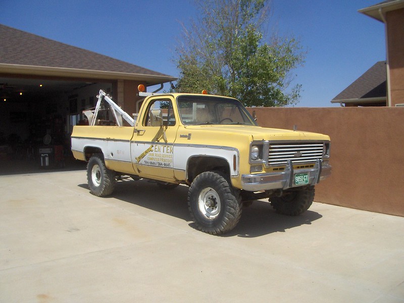

Saturday morning before it started getting ripped apart. I had to take the light bar off a few years ago so the neighbors wouldn't complain about seeing it over the fence

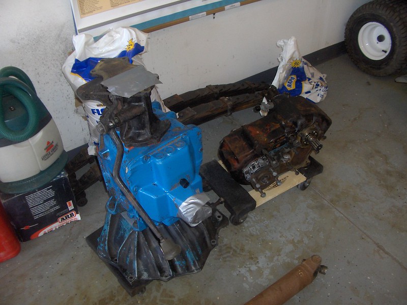

465/205 cleaned up well

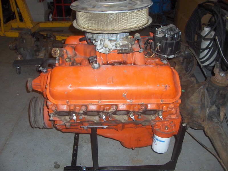

the engine cleaned up nicely too
The 4:10 ratio D44 and rear 14 FF are going in my Suburban and the 205 is replacing the noisy POS 205 in my K10. The SM465 and mystery big block will be sold.

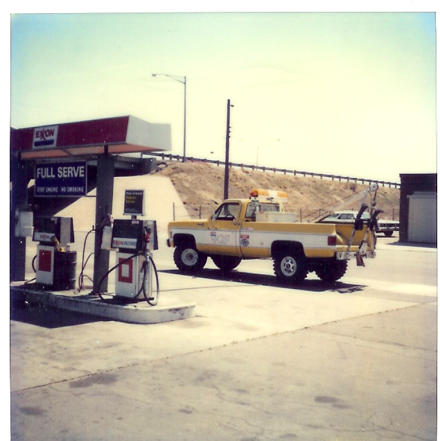

The truck back in the hayday.
I am the little squirt holding the dog. A hunting scene is an odd place to see a tow truck, eh? LOL

Sounds like the motor mystery is solved; "3963512" is a 427 or 454 block and you said its internally balanced so it has to be a 427.
My "How To Rebuild Your Big Block Chevy" book lists that block casting # as a 70-74 454...the heads are listed as 65-73 Chevy passenger,truck and GMC 396,402,427 heads,that have 96.4 cc combustion chambers and 2.06/1.72 intake and exhaust valves...The "CEO" code doesn't show up anywhere,and it could be that block was a factory replacemnt "Complete Engine" that uses a "CE" prefix...but this book hasn't listed every engine I looked up either,I've found some codes in Chiltons and Mitchell manuals and the best book to look them up in is a Hollander Interchange Manual that junkyards use,they had the most extensive listings out of any books I have used.................................................................................................My guess is you have a 454 block and someone put a 396 or 427 crank in it ,making it an internally balanced 427...this can be done pretty easily the pistons are different weights so the engine would have to be rebalanced ,but its not an uncommon procedure back in the day...the 427 crank has heavier counterweights than a 396 to compensate for the different piston weights..you can tell the 396/402 crank from a 427 by looking at the width of the third counterweight..count from the front of the engine--the 396 has a 7/16" wide counterweight,the 427 has one 7/8" wide..you can use either one provided you rebalance the engine...
from what info I've gathered over the years a CE engine is a warranty or crate engine.
It will have the CE code stamped into it, but usually the other numbers (vin #'s) are left up to the dealer to deal with.

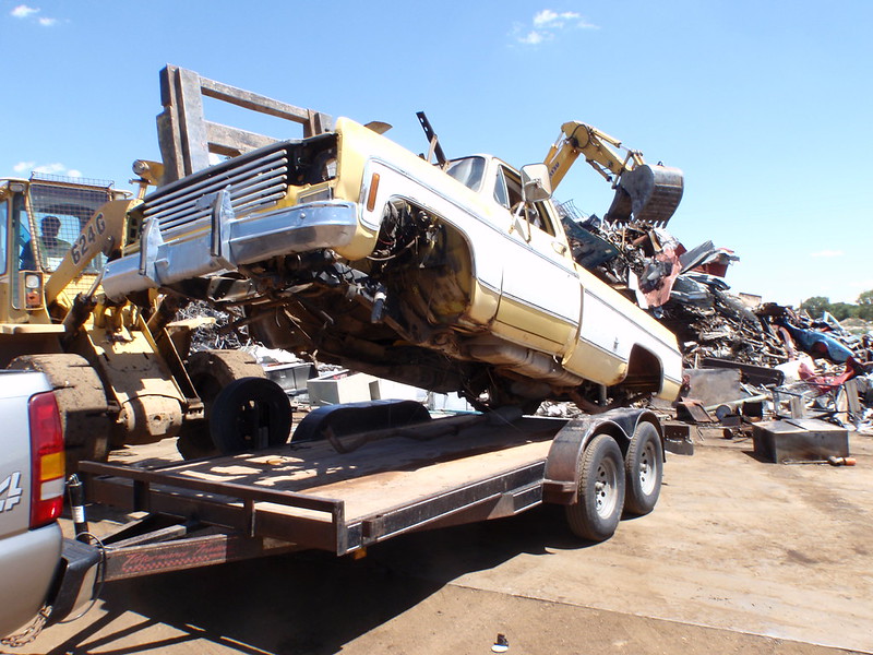

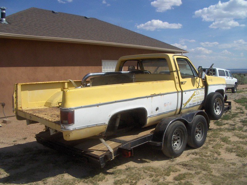

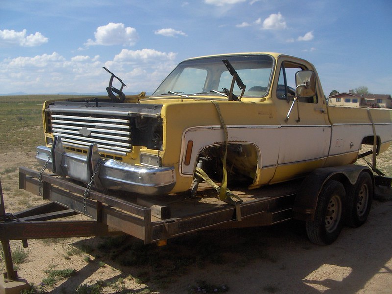

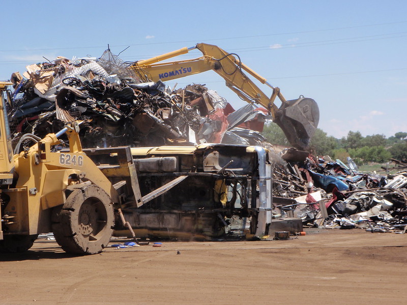

The poor truck met its maker today. I was sure the hell expecting more than $326.40 for it too :mad: The bed was full of scrap metal I’ve been accumulating the last few years. I always get hosed when I take crap to the scrap metal place.
I never thought the end of the road for it would be on top of two Oldsmobiles. Two clowns atually drove that blue Intrepid next to it into the place while I was there and walked out. Known Pueblo, they probably just stole it at the convenience store down the street :haha:
so sad...but inevitable for many I guess.
I don't think the CE will detract, but the other numbers may slightly...more than likely it would get decked on a rebuild and they'll be gone anyway.

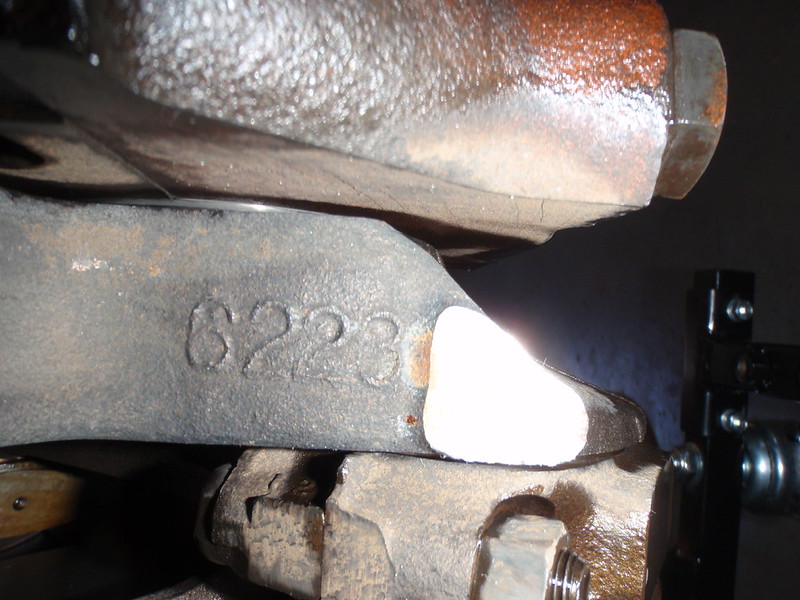

Back to the engine…. It turns out to be a 2 bolt block and I found the crank casting number too. 6223
Google said…..
Casting 6223
Application: 366/396/402/427
Years: 68-76
Journals: 2.75/2.20
Stroke: 3.76
Forged

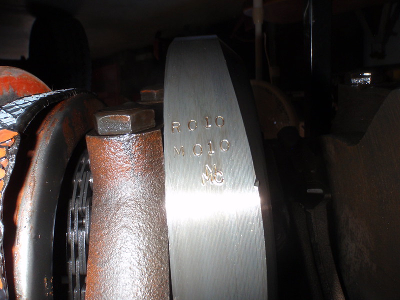

This was on the crank too
So, it looks by the engine casting number it is a 427 block, with a 366/396/402/427 forged crank and 396 heads. Hmmm, whatch’all think? Now the big question is what is this big hunk of builder cubic inches worth? It was parked in 1997 due to loss of oil pressure. The engine does roll over nicely so I suspect cam bearings issues. The engine did have a boat load of miles on it and was using oil (and leaking) like crazy before it died. I also suspect my dad ran it low on oil causing the bearing issue as I only got out 2 to 3 qts of oil from the pan.
part it out...if you feel like messing with it, that 10 under forged crank should be 3-500$, and the block 500-1000 in the collector car markets. The closed chamber heads are still popular with class racers as well.
collect the $$$$ and buy a good used 454!
