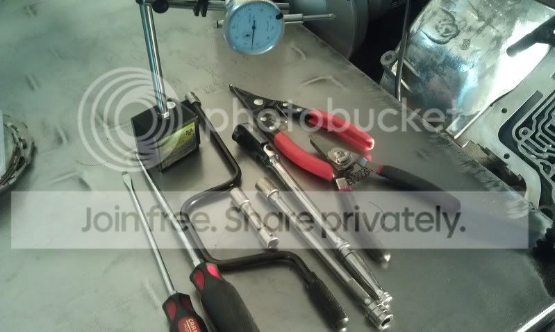

This is far more easy than people make it out to be. The picture below with the addition of two c-clamps, calipers, and feeler gauges is all you need.

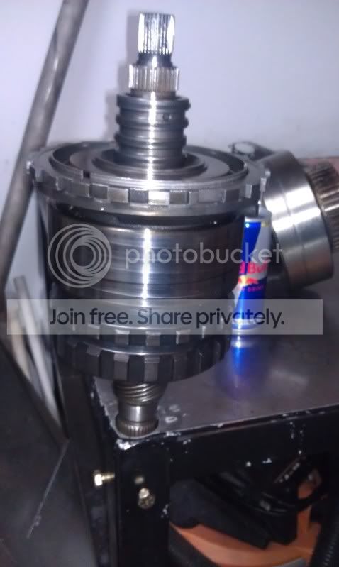

The trans comes fully apart in less than an hour...

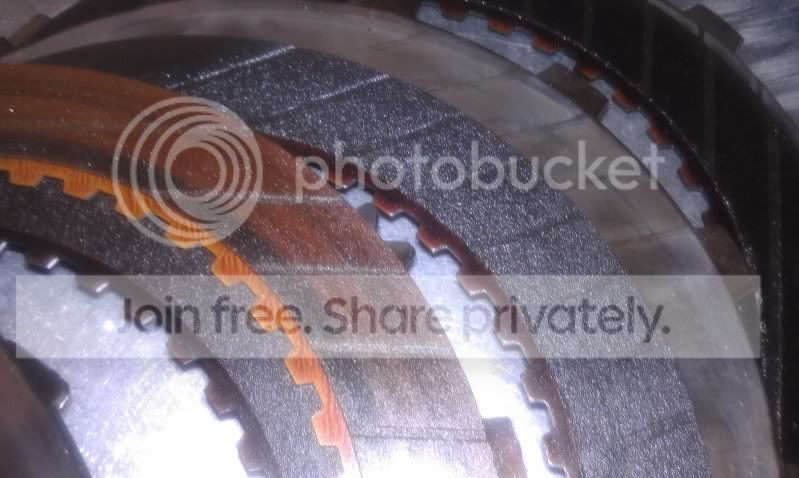

First thing I noticed is the clutches had really been abused. Here is a pic of the intermediate clutches which are what lock up when you hit 2nd. The clutch material should be tan in color and you can see the steels are warped bad enough they dont sit flat on the bench

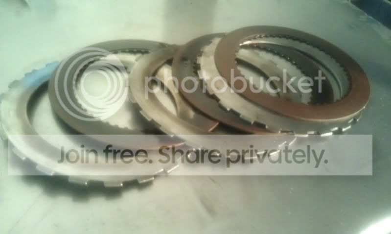

Here is a picture showing an "ok" condition disk from the direct clutch (3rd) and a burnt one from the forward cluch (all forward gears)

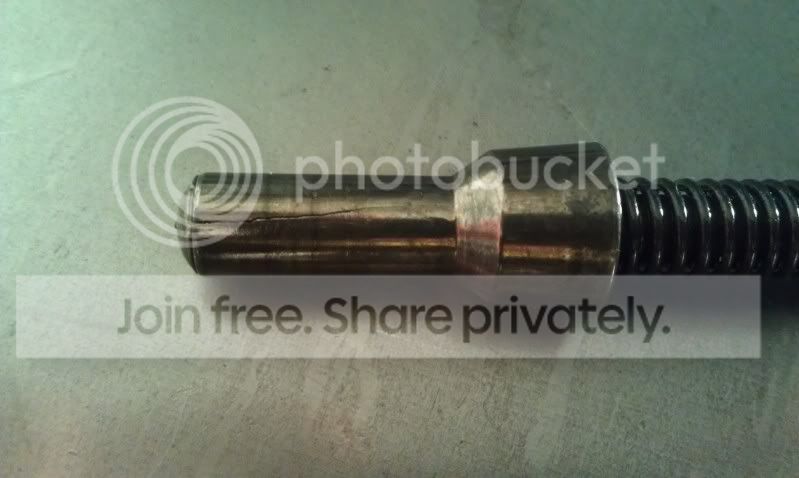

only other issue with the trans is the parking lock actuator had a crack in it. This sucker pushes down on the parking pawl when you shift into park and I think it may have cracked in one of the many times I tried to put the trans into park with the t-case in neutral and the parking pawl is banging back and forth between the actuator and the output carrier. (that grinding noise for those who have also done this before). This part was replaced in the rebuild.

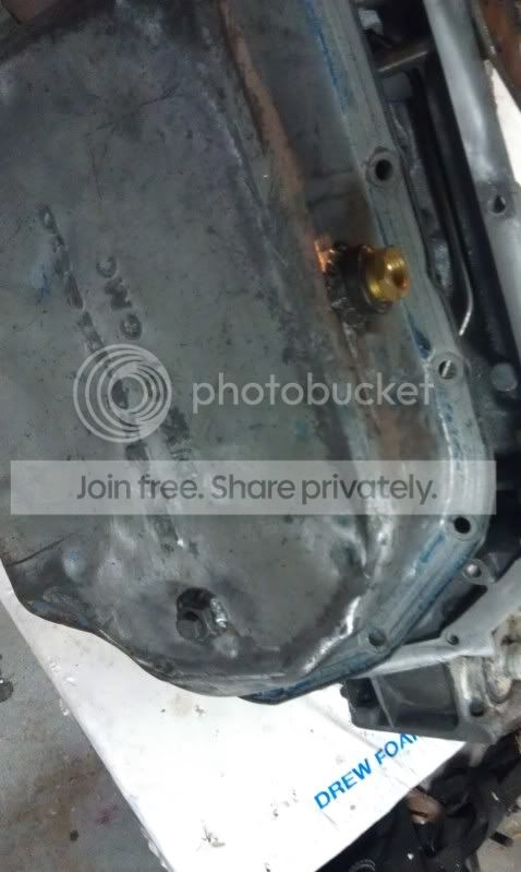

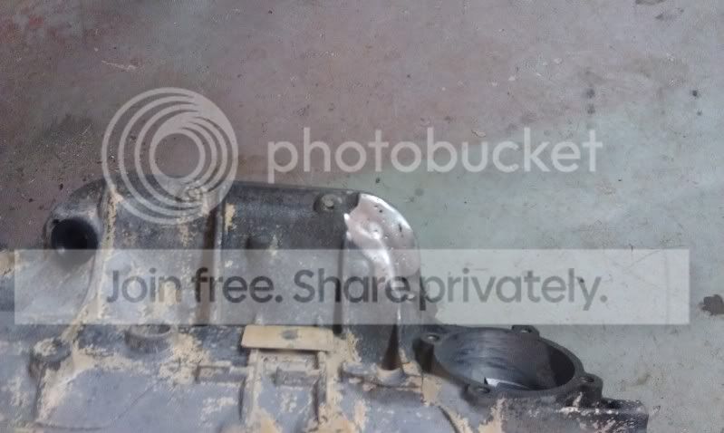

One thing you wanna do is be gentle with the case. Just easily rolling it around on the bench when I was disassembling everything I cracked the housing and had to have it welded.

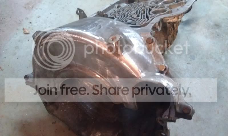

First upgrade was the cast aluminum dust cover that some of the heavier cases used. I had to drill and tap holes in my case to use this cover, but I just really didn't like the plastic and tin covers. FYI, not all cases have enough material in the casting to drill and tap these holes.

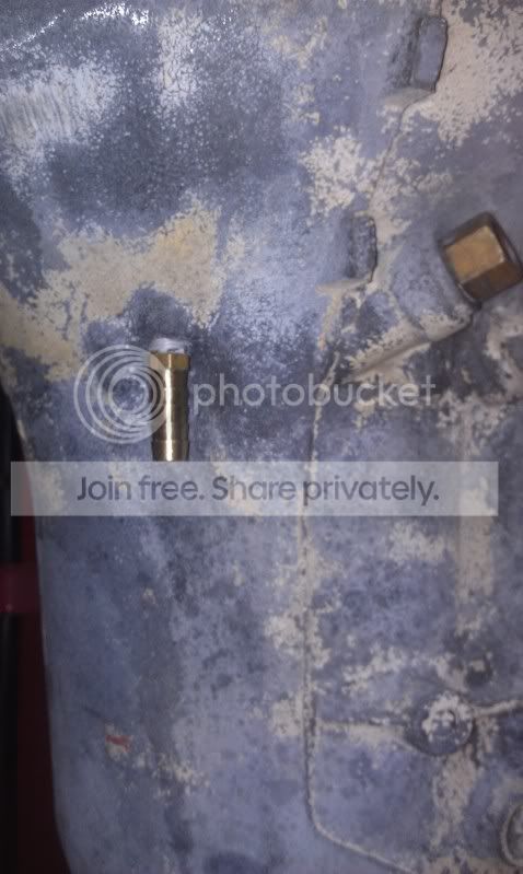

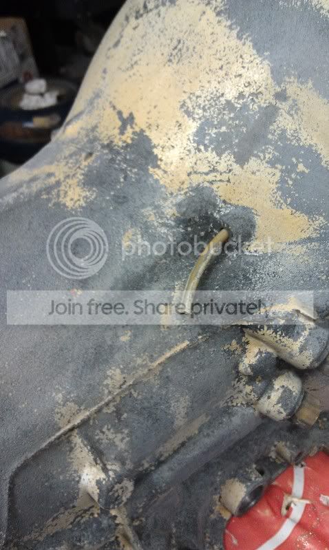

The other upgrades to the case were to drill and tap the case vent for a 1/8npt hose barb. This will allow me to route the breather somewhere safe when this transmission goes into a buggy so that I dont have to worry about hot trans fluid pouring on me when im rubber side up. I also modified the pan to hold a temp. sender and a drain plug. IMO a aluminum tranny pan wasn't going to aid in cooling with the proper cooler/fan and they are pricey. Also, if something hits an aluminum pan it can crack, where the steel pan with just deform.

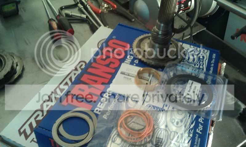

From all the research I've done, and looking at all the spec sheets for dozens of reputable transmission builders, these are the parts I came up with...
-Transtar deluxe overhaul kit (Transtar # 34008A)(came with transtec soft parts rebuild kit, borg warner frictions and steels, new front band, adjustable vaccum modulator, filter, and a couple bushings)
-Transgo 1-2PRO Reprogramming kit (Transtar # T34171)
-Borg Warner 48 Element Direct Drum Sprag (Transtar # 34652A)
-Sonnax No-Walk Rear Case Bushing (Transtar # S34064BA)
-"Rollerized Rear Output Bearing" (Transtar # 44229 and 44212A? <<A-F shims to set output shaft endplay)
-Scarf Cut Teflon Sealing Rings (most kits contain metal rings) (Transtar # 34175AT)
-New Rear Band (didn't really even need a new one) (Transtar # 34024 or 34024E)

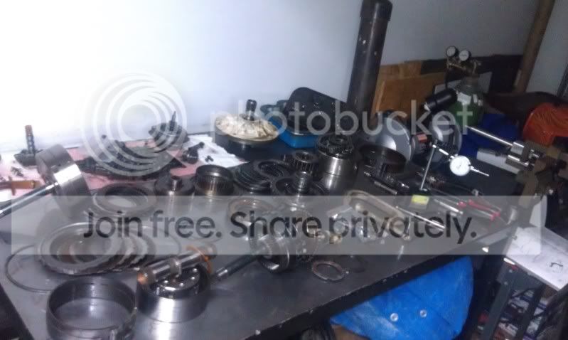

Ok, so I'm not going to show everything step-by-step because that would take forever. Most of this is in the order that the ATSG book has you doing things..... ( While doing the rebuild pay attention to all the bushings. The book doesn't mention replacing or even checkint them. I didn't find clearence specs for so use your best judgement and replace bushings as necessary)
-Disassemble gear train parts. Measure clearences on planetary gears. Replace lip seals in intermediate clutch pistion and sealing rings on the center support. (You will see a lot of info on the interweb about dual feeding the direct drum with leaving a sealing ring off the center support. If you are going to use the Transgo kit, DO NOT DO THIS or any other mods you read for dual feeding the directs. The Transgo kit does it a different way. I'll try to touch on that later)

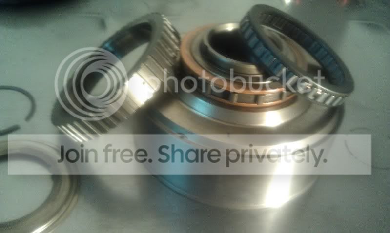

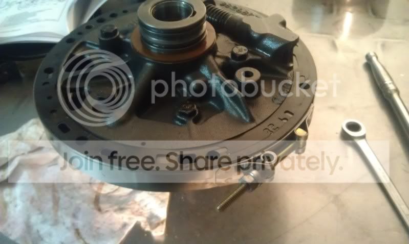

Here is a pic showing the direct drum and the new sprag next to the old one.

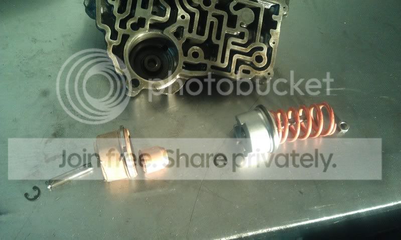

-Transgo valve body mods: (drilling valve plate orifaces for 1-2 and 3-4 shift feel, Governer spring changes for faster/slower 1-2 shift, 2-3 aluminum accumulator and new spring, 1-2 shift valve change for compression braking and no over-ride shift out of 1st and high rpm, and a few more things I can't remember)
Lots I sould show with these steps but its covered in detail in the transgo instructions. Here is a pic of the new aluminum 2-3 accumulator and spring. Notice how my old accumulator is plastic, broken and missing the spring. This explains my WAPOW shift into 3rd.

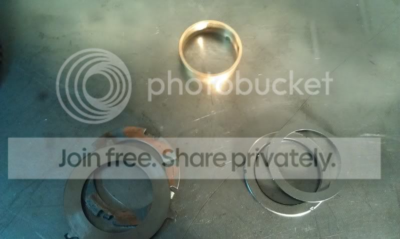

The other upgrade in this area is the Sonnax no walk case bushing. The rear bushing in the case has been known to push out towards the rear of the case and eventually the ouput shaft trashes out the hole. There are oversized bushings if you ever have this happen. If you are running a stock style bushing, locktite and stake in place.
If you dont want to rollerize the rear output you can use the sonnax no walk case bushing and the rear end-play selective washer and your bronze output shaft thrust washer. If you had too much or too little rear output shaft play at the initial measurements you can change your selective washer here.
If you do want to rollerize the rear output you cannot use the no walk case bushing as the thrust bearing does not fit over it. You replace the thrust washer and selective thrust washer with a TH350 Pump Bearing and selective washer(s) to set your rear end-play.
Here is a pic of the old thrust washer and selective, the sonnax bushing and new thrust bearing and shim.

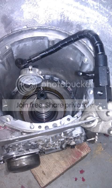

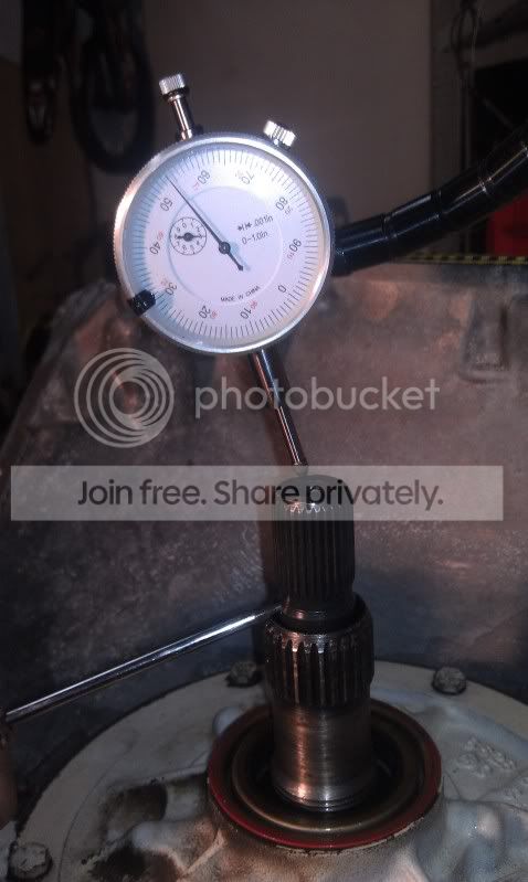

-Now is the best time to check endplay on the output shaft and adjust. You wait till the book says at the end and you have to change it EVERYTHING has to come back out of the case. Should be .007-.019". You want it on the tight side because of the previously mentioned info on the planetaries pushing on the back of the case.

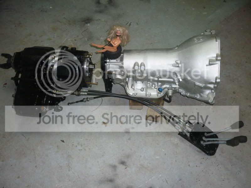

NWF 203/205 Doubler and Triple Cable shifters, 32 Spline Everything, 1350 yokes, but may go with a 1410 up front if I need the angle. Spent the past couple nights really dialing in the shifters. Welded up and redrilled some holes, lots of new hardware, got about as much slop as I could out of everything. Also shimmed the detent springs to get it shifting like butter. As long as it doesn't kick out of gear, front digs are gonna be easy like Sunday Mornin'.
OK well I've got the doubler under the truck. With the 3" body lift I still had to cut up the floor slightly for the very top of the 205 to get a flat belly. From what I've seen of the crossmember thread, hardly anyone has a flat belly, so im pumped about that :woot:.
