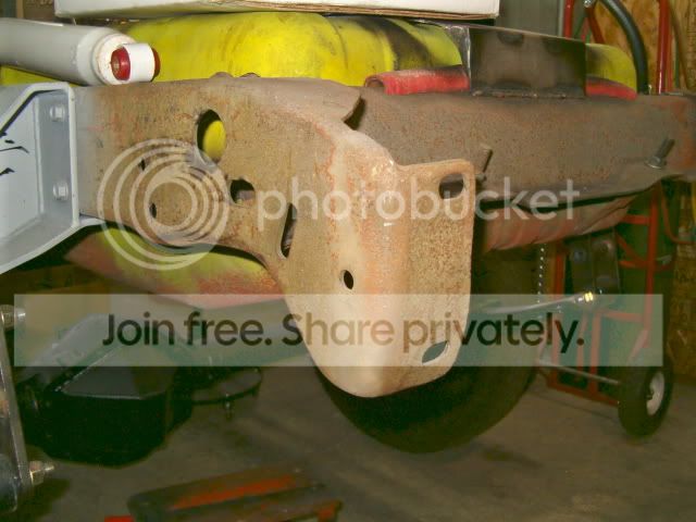

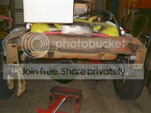

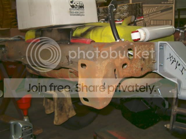

Still needing this? I have a 72 K5 going back together. L
