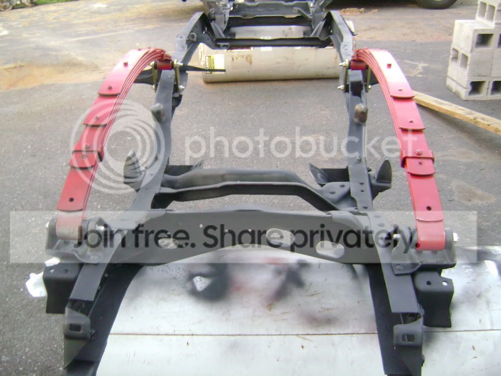

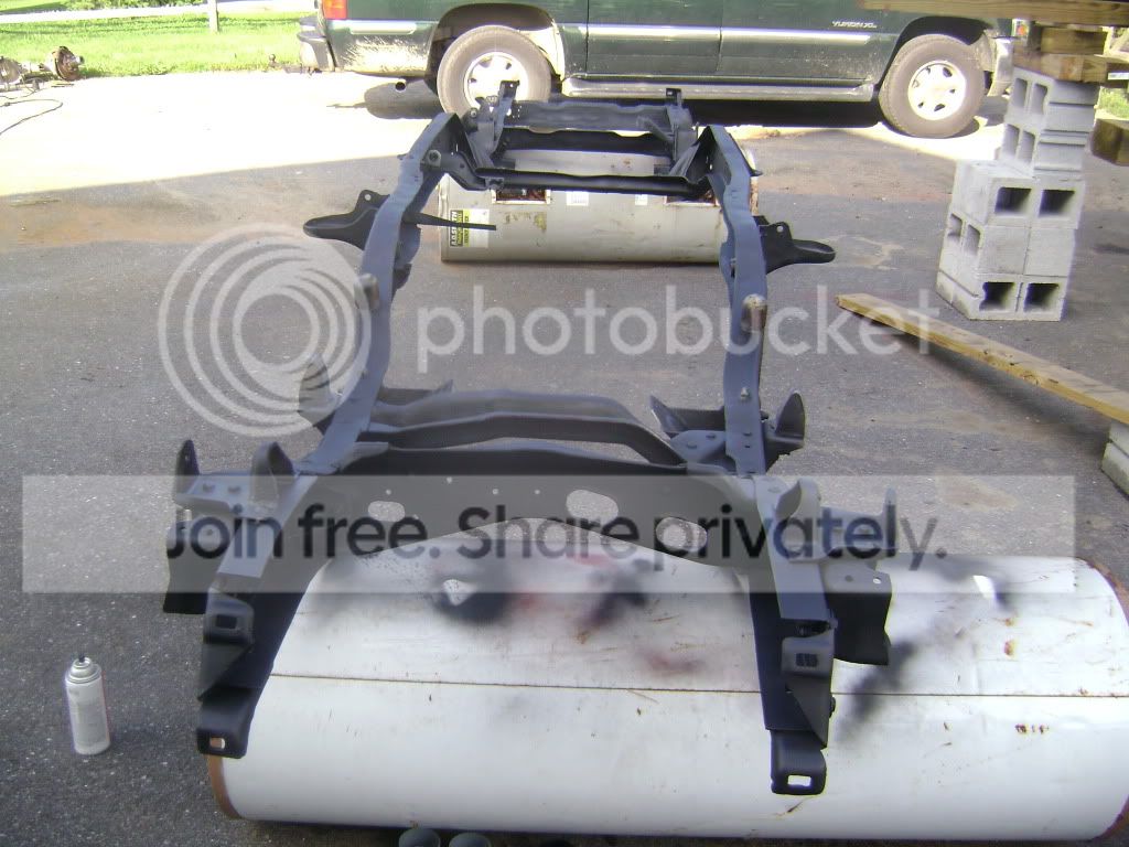

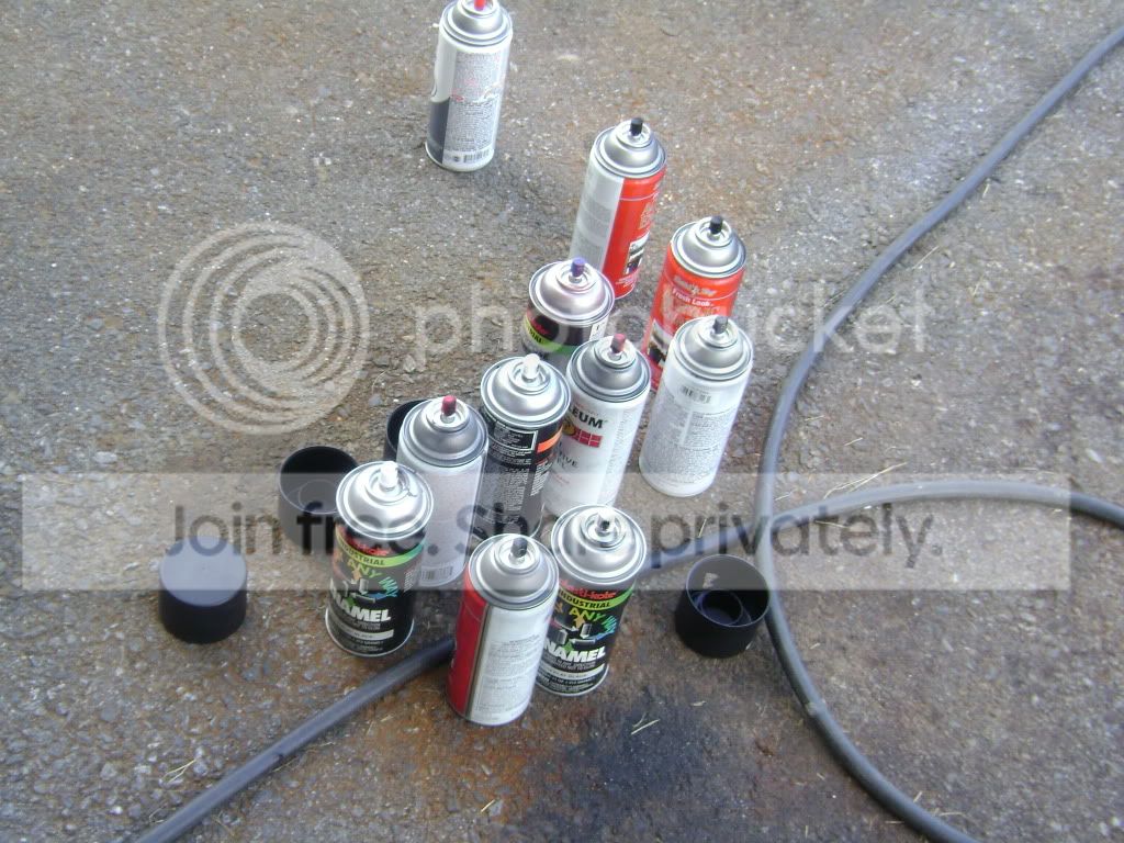

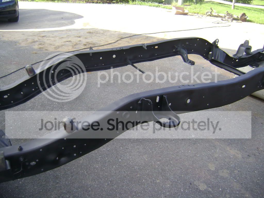

Well we didn't finish the front axle today, ran into alot of snags. But I did finish painting the frame, and cleaned out the local hardware store of their flat black lol.

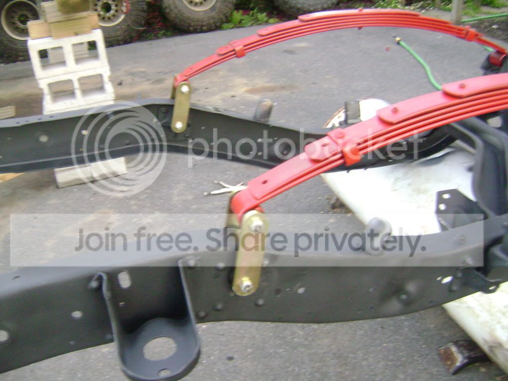

And got my front leafs mounted on all new ord bushings and shackles.

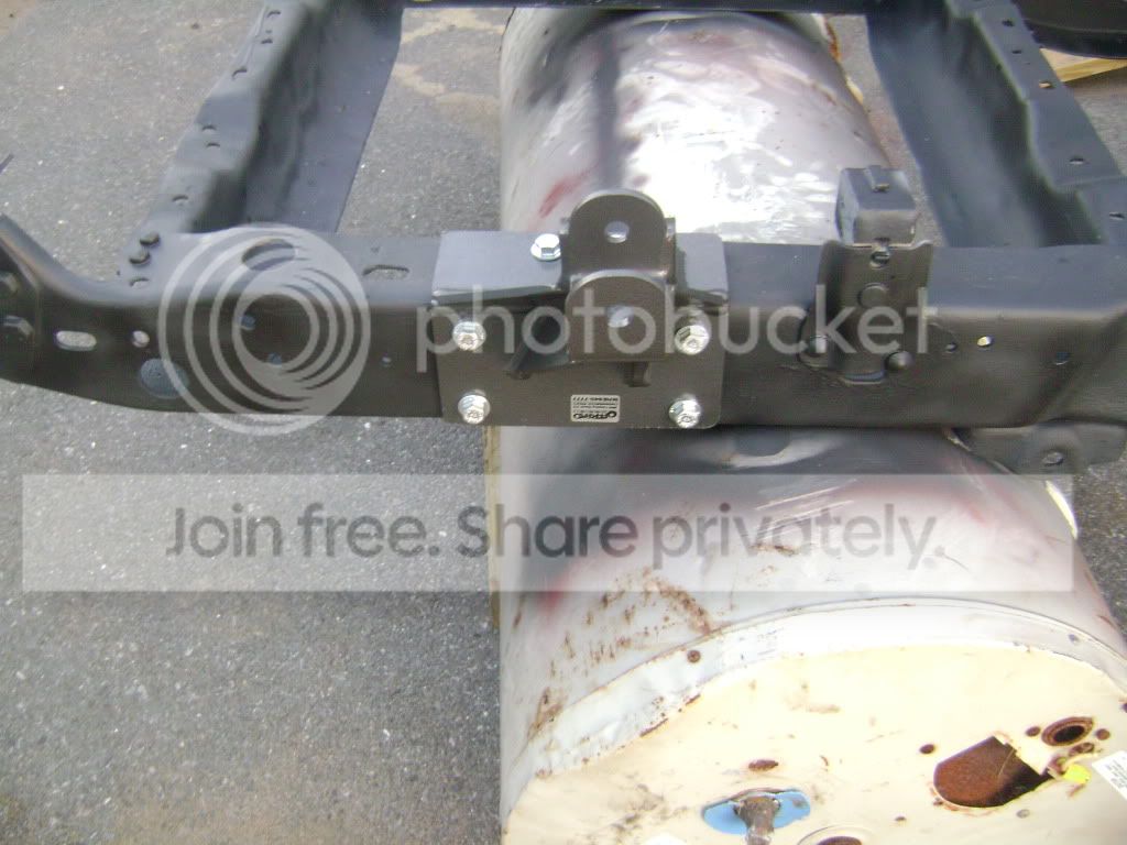

Still waiting on ord to send the rear shackles so I can get them mounted but heres the flip installed
Nice. Your gonna wanna do that frame in something other than flat black spray paint though.
Go for either 3m undercoating or por15.
Yea I went over it with 2 coats of rust bullet which is some really thick stuff from what I can tell. It should be covered for a while, hopefully.

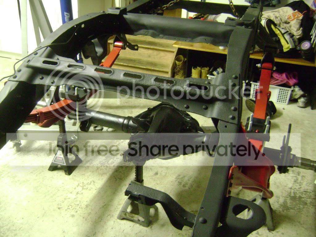

Alright so I finished the front axle, waiting on more wheel studs to finish the rear. But i slid it under the frame to get ready to bolt it on to the leafs.

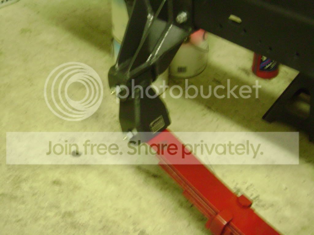

Simple answer , No :D. Turn them around. I'll try to find and link a pic for you
yea thats what I was thinkin, I was looking at a stock shackle and put them on like that. I'll flip em.

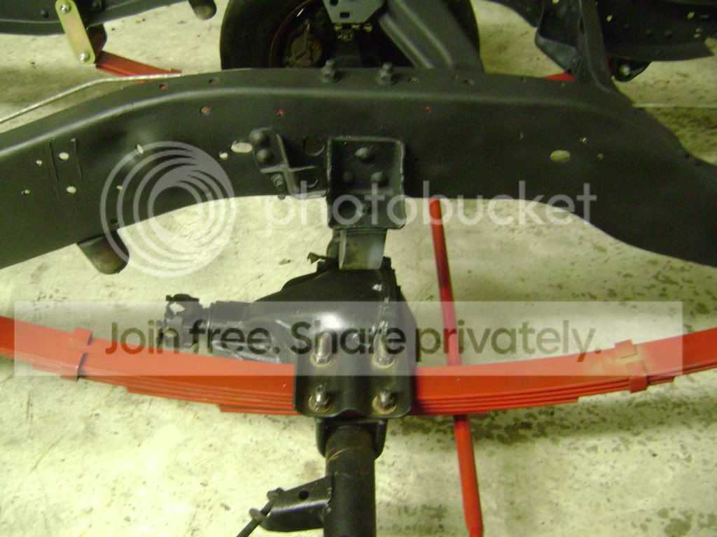

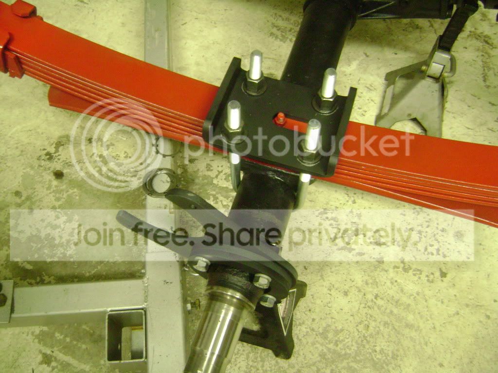

Attached the axle to the leafs, with ord u bolt flip u bolts and plates.

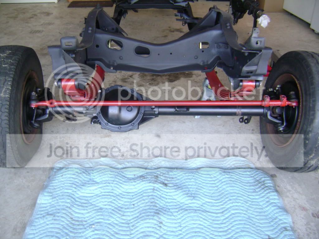

Front axle is totally locked down now.
