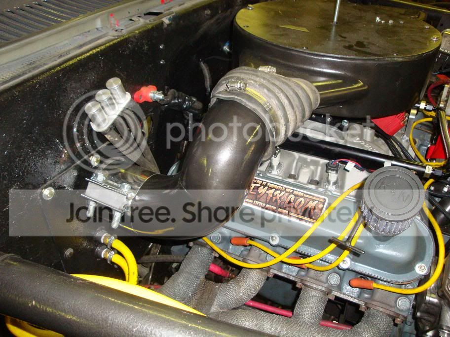

Fuel injection wiring making its first appearance in the engine bay. Pretty much all sorted out for where they need to go.
Looks real good! The funny part is it looks like you ran the wiring into the air cleaner! ha ha
On a seperate note, I don't see why that XFI system would care what kind of engine it is if the tune is right. My cousins use that system on there 1200 hp 632 BBs in their dragsters. I think you'll get it just fine once you learn it.
Your right, it does look like the all go in the air cleaner. That's funny. Got most of the stuff hooked up today and had a little confusion. got to talk to the boys at FAST and get some things cleared up.
I think your right though, It should work with just about any engine. We used the GM harness since that was closest to the Cadillac engine. Cylinders are numbered the same just on opposite sides of the engine so the injection harness is basically upside down compared to a chevy. Doesn't matter in the least. You tell the computer the firing order anyway. There are alot of things the injection system can do that I'm not sure I'll ever use. Some, i think I'll find a slick use for in the future, just no time right now to play around with it.

Went back to the shop for an hour or so tonight and wired up the alternator. One more item down.
All wiring is now complete. Done. Over. Finished, and thank God!
Did you use a 425 midsump pan?Thats a common problem with them that the rods hit the pan on a 500. Not so sure I like where the oil filter is but if it works:dunno:. Hopefully FASt is willing to work with you on getting this running. I know that Potters did an engine several years ago with a FAST system and they never got it to run on a dyno. But it ran like a champ with a dominator.

Yep, its a 425 mid sump. I had this pan on the previous 500 and they didn't hit so I guess I'd say it was the larger rods that caused it this time.
FAST has been pretty good so far as well as Kevin Thompson at hot rod solutions.net. We'll see.

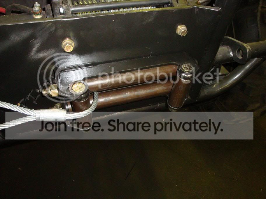

Got alot of small items finished up last night. Got some winch cable in place. Needs to be stretched and rolled tight. Throttle cable hooked up and the coil mounted.

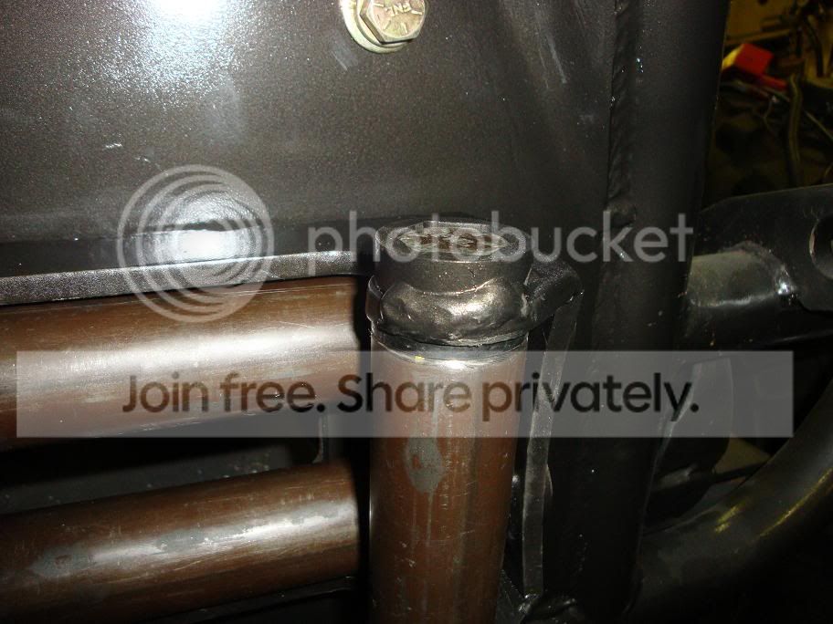

Roller fairlead has been fabricated and installed. Air intake tube is finished all the way into the engine now.
