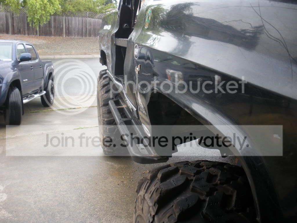

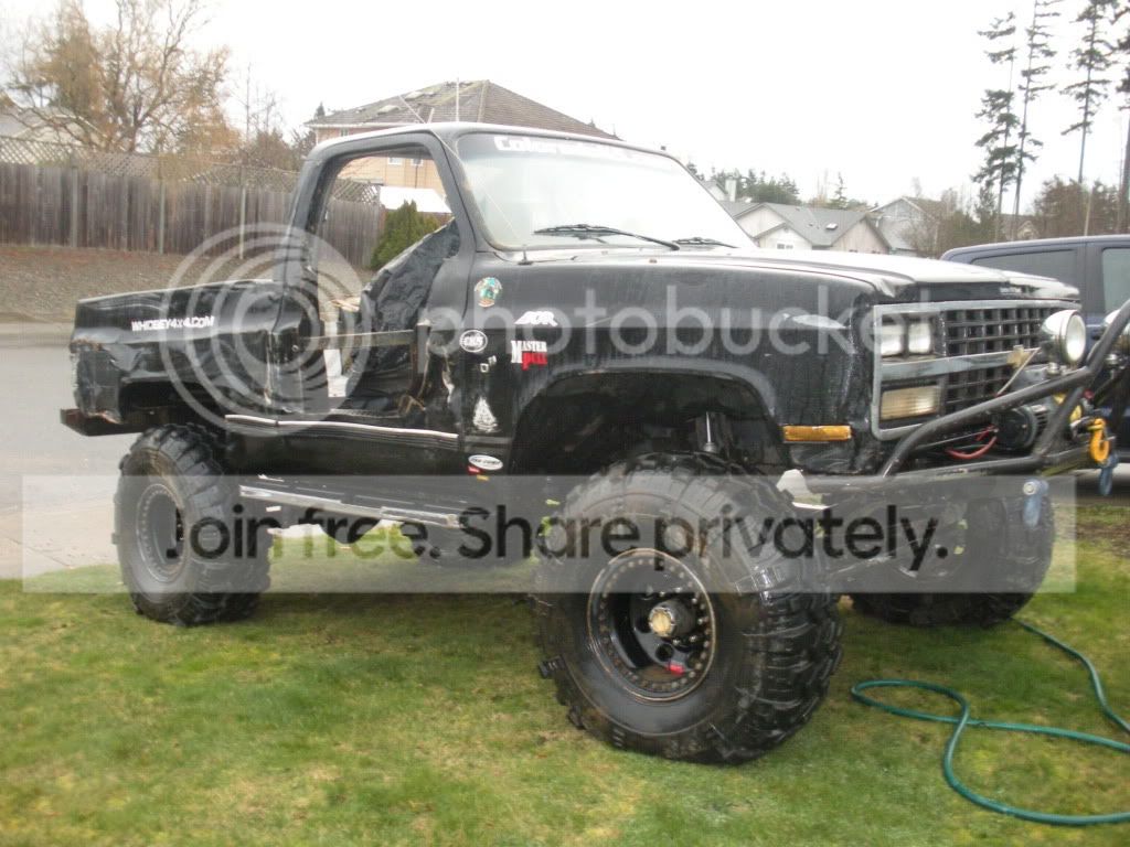

Here are my sliders with the steps added on. The were 2x3 tube originally. I added the 2x2 outrigger bars/steps.
Original
Steps added

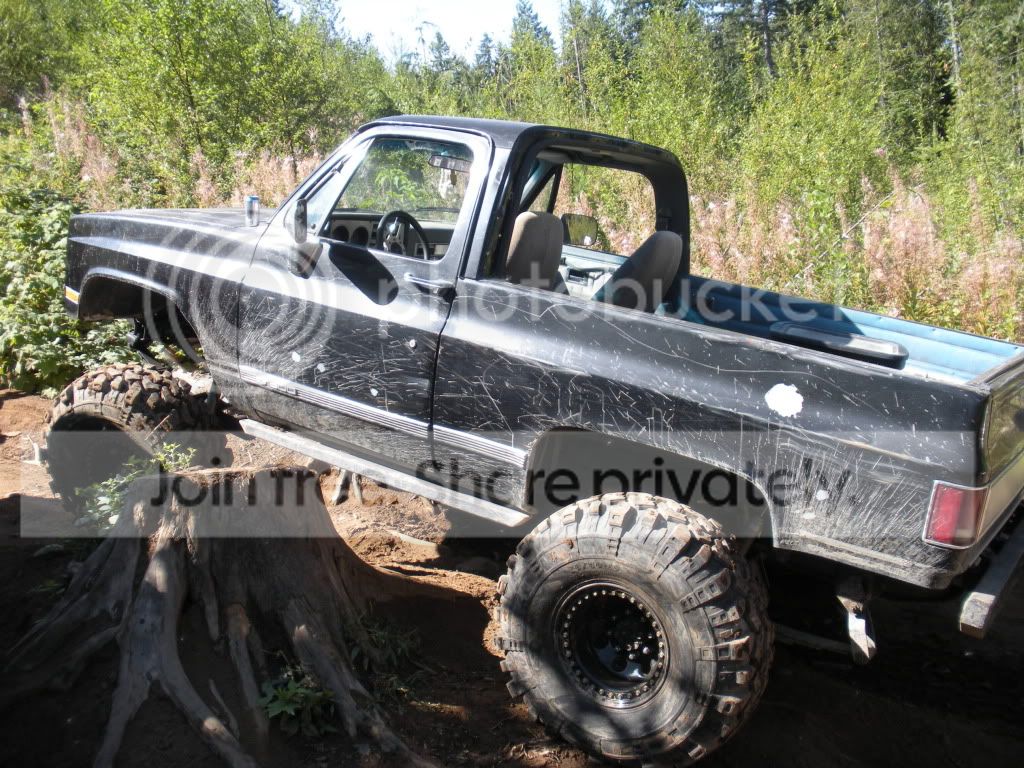

Here they are after I wedged them in between some rocks and stumps.
