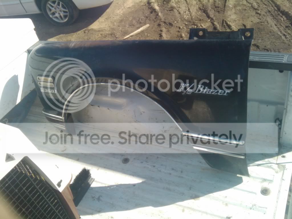

found a local guy who says he knows what he is doing when it comes to sandblasting so i took my fenders there today hopefully there will be no warping!
this is what i started out with, no rust and only a few dings.

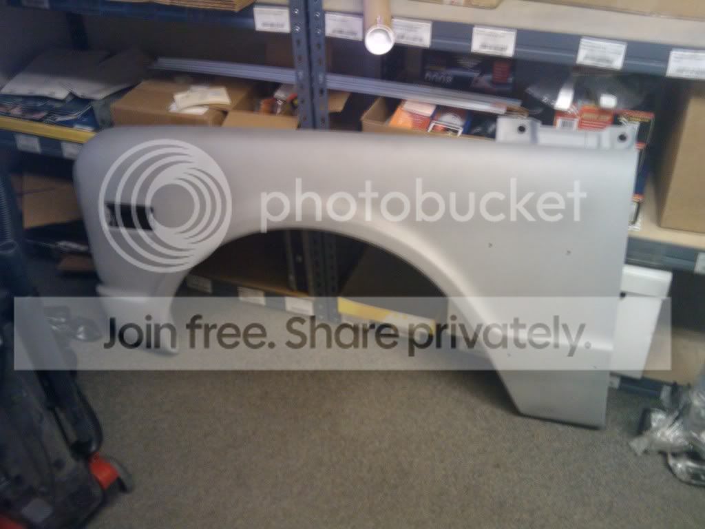

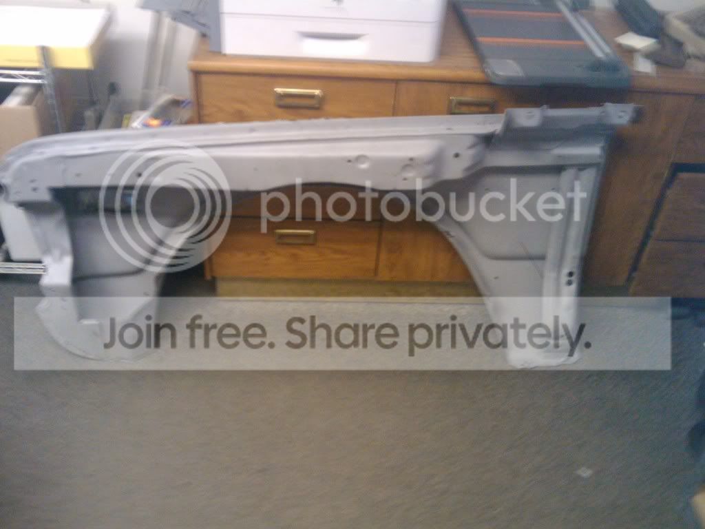

I got my fenders back from the sandblasters. Im really impressed with how good of shape they are, but im also unimpressed with what was uncovered.
crappy cell phone pics. (I really need to buy a camera)
that fender is in practically perfect shape.

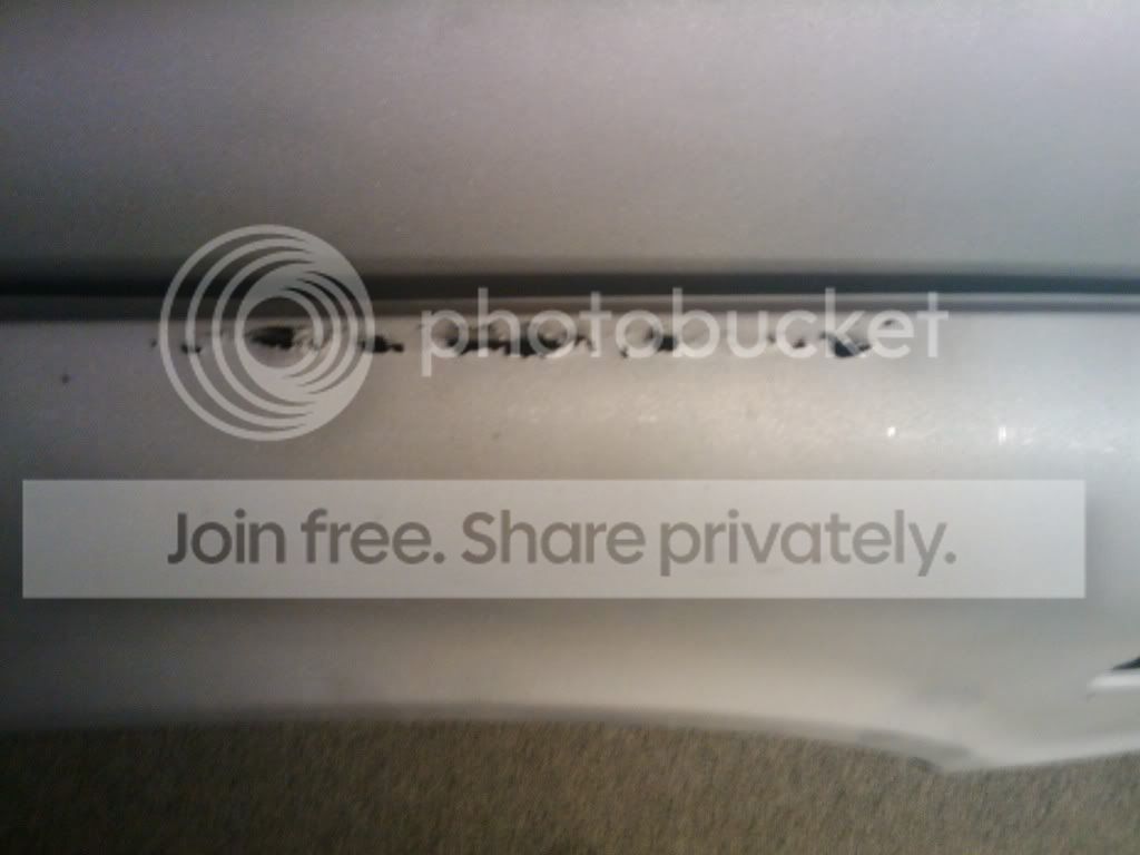

but this one uncovered the only rust spot on the both fenders.
Im a little nervous on fixing it. I have 2 other fenders that will be great candidates. I have a great welder and alright welding skills. Just never really have done thin metal and patch work like this.

Aren't you glad you had it blasted now? That's the way I feel whenever I get one back...I am disappointed to see the rust but I am glad I find it so it doesn't go unnoticed and come back later and ruin all my hard work.
If you have other fenders, I would go ahead and patch that one for the practice...you might be pleasantly surprised by the results...

yea I know what you mean.....:rolleyes: Thats one reason why I wanted to get it blasted to uncover everything. If im going to do it, I want to do it right.
As for the other fenders I have, they are rusted on the bottoms thats why i got these ones. I think I should be able to cut it out and replace it fairly easy. Its never as easy as it sounds, thats why im planning for the worst. So we will see how it goes.
As I found out, it doesn't have to be pretty...just solid...and when you mud over it, it disappears...
