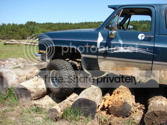

I have had blazers with 4" of lift and 35s stock on 35s 9" of lift on 38s (and 40s) and 3" of lift on 42s. Most of these were on the same truck. I now have a blazer with a 6" lift on 35s
If flex is important than you will have to trim no matter what, even if you went a full 8" (6' spring+ ez inch+shackle)
A flexible 6" lift is going to be more stable off road than a super stiff 4" lift
