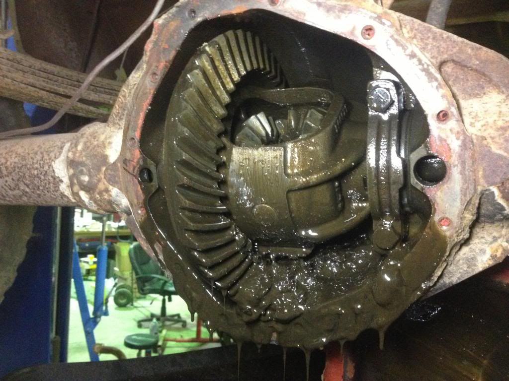

so finally got around to changing gear oil :doah:and the rear was fine...
but the front not so good im going to have to buy gears real real soon
Looks like just a new set of front axle shaft seals and lock in the hubs for a little while with the fresh oil then change it again and you'll probably be fine. Worst case you need new pinion and carrier bearings. It takes a fair bit of rust to ruin a gear set, especially in an off-road vehicle and it's the front axle to boot.
yeah, I will probably change the front again next weekend... hopefully nothing is too wrong but if so just means I can buy lower gears I guess
I've driven worse looking ones without issue. I wouldn't go buying gears for it unless there were non-visual warning signs.
oh im not buying gears for a while (unless I have too), I just really really hate when the gear oil is freaking milky like that. im pretty sure there was mud in there too I pulling clumps of something out.
That looks pretty damn clean compared to some of the ones I have dumped.

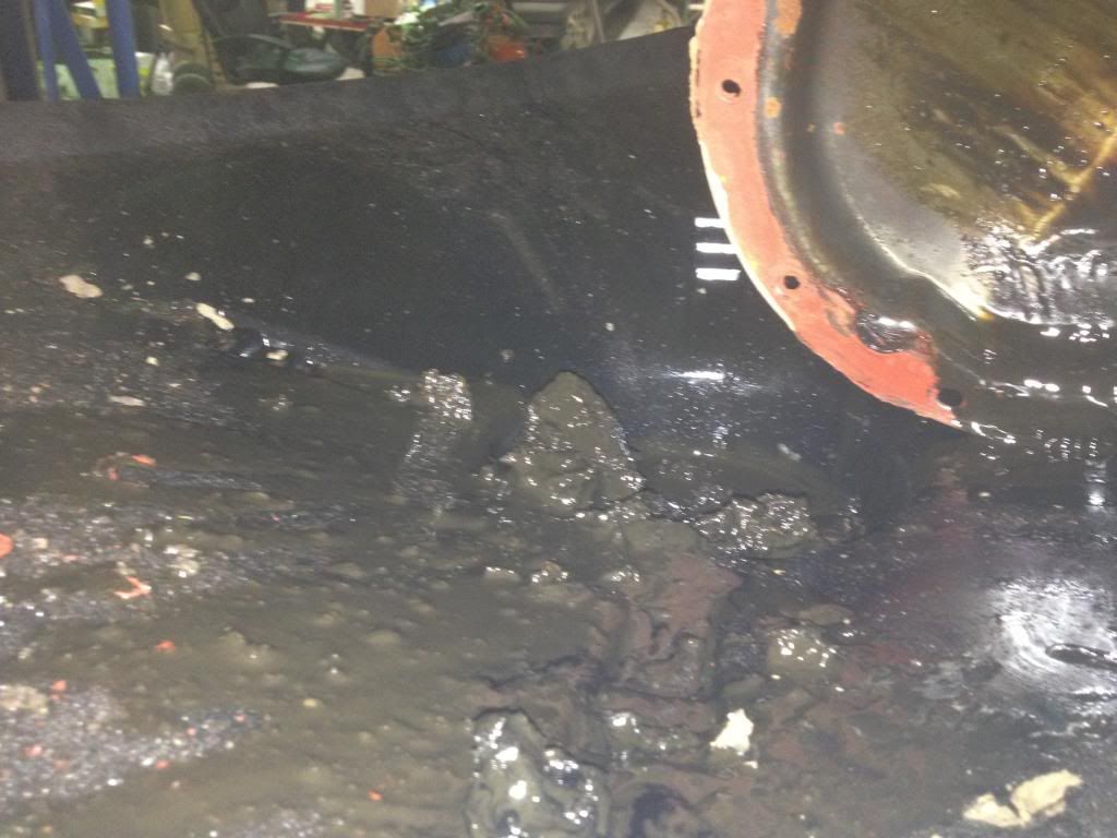

See those chunks?
This truck had been sitting in a tree line for 20+ years. You can see the chunks that fell into the catch pan.
Those were chunks of ice. After nothing more than being cleaned out, and some new gear lube, that axle goes down the road just fine.
You'll be alright.

I cant recall any diff on my vehicles I opened up looking any different,they all had milky gear lube and some rust on the parts that dont contact each other..
I never had one give any grief after a good flush and new lube,even one that looked really nasty inside...I doubt any of them ever had a fluid change,and all had well over 100K on them..
