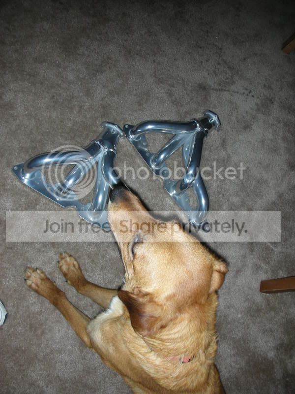

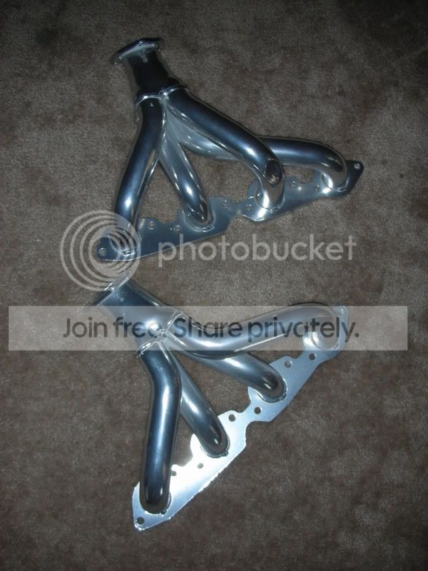

finally got the headers back from getting coated! bling..

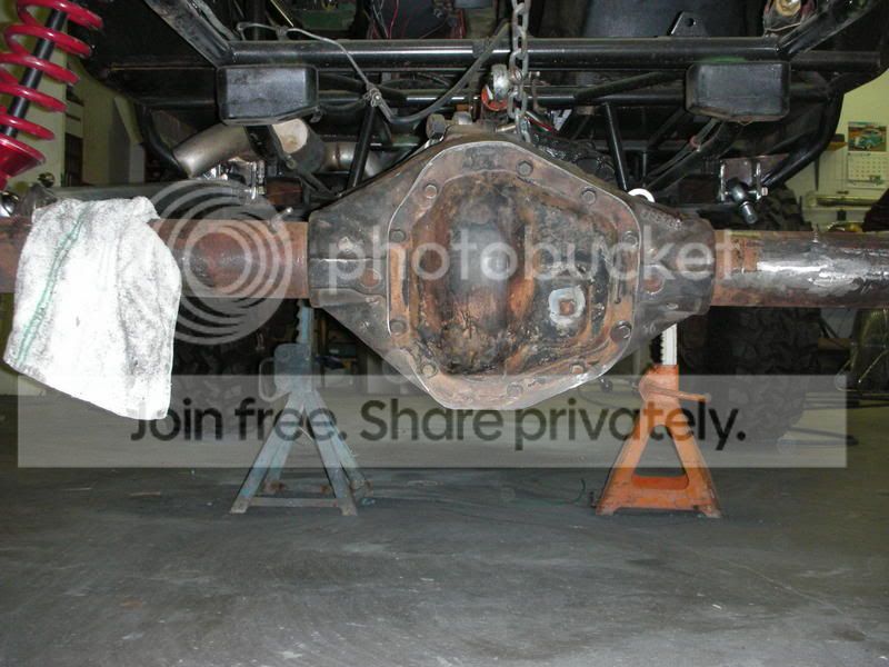

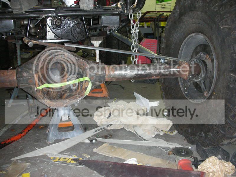

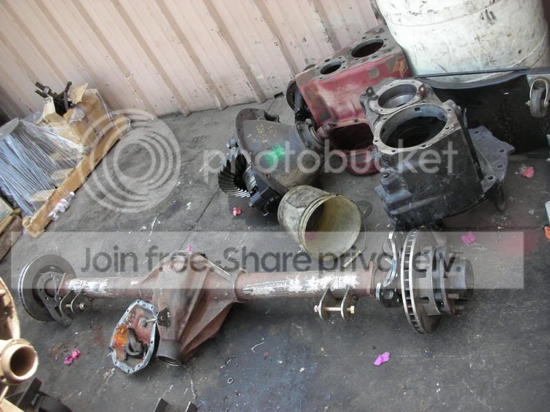

and got the dana 70 over to the gear shop, the g/f dads own the place so the cost for the install was hanging a fan at his home!:bow: turned out to be very interesting to get the carrier out! I also welded up the spyder gears and should have it all ready in a day or two and back under the buggy!

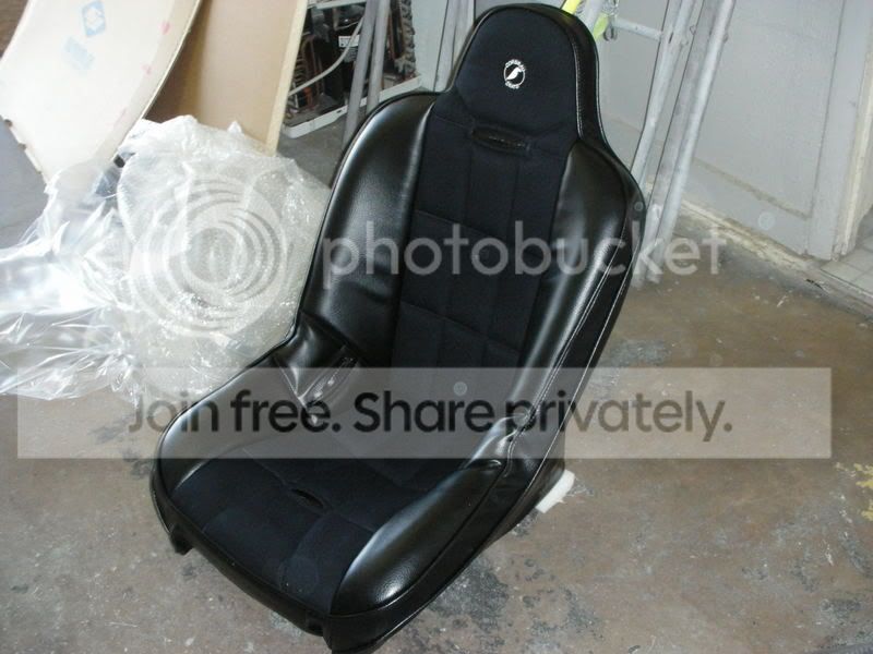

other things.. ordered new front seats to replace the current suspension seats, 169 each shipped from offroad overstock

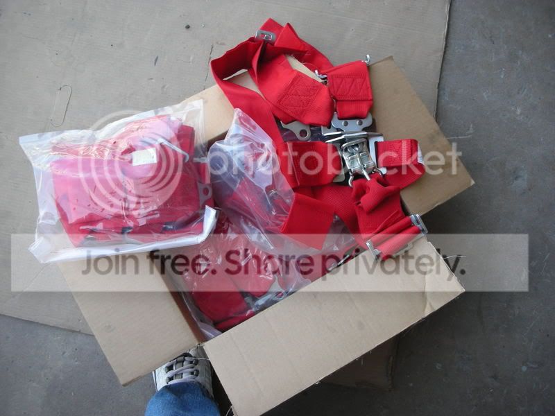

and ordered 4 five point harness's at 54.99 each shipped

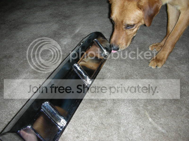

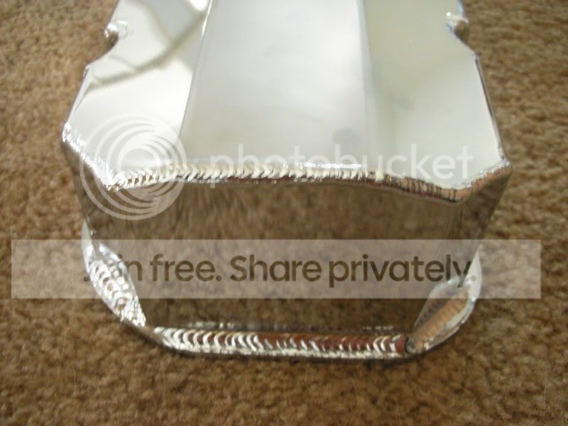

as well as ordered some fabricated bling bling valve covers for the big block

Shawn, I like your coated headers, looks much better than the cheapo rattle can ceramic black that I used on mine...

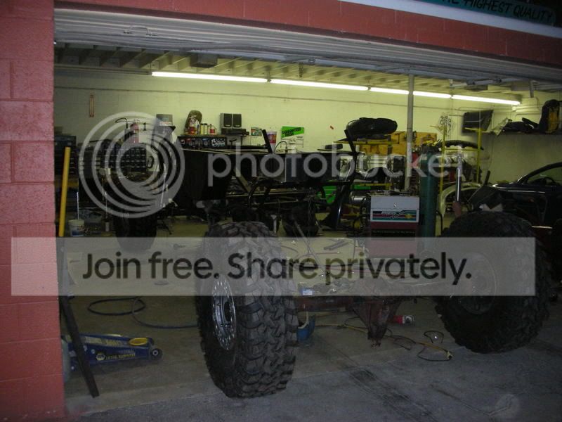

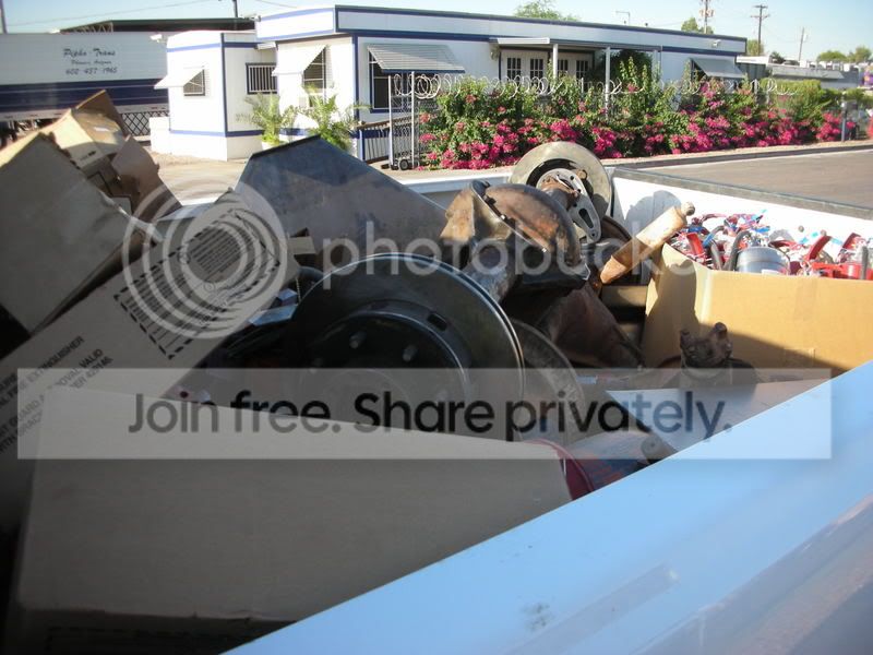

look how loaded my truck is! 3 axels, 4 extra shafts, maybe 40 fire fx and at least a couple pounds of 3/8 3/16 and 1/4 inch plate..and a nitrogen tank..along with ton of other crap! damn!:crazy:

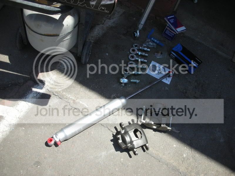

got the front seats in, the front shocks 9 way adjustable new rancho rsx9000xl's they have the 18 mil shafts and 2.75 inch body..hope I like them!
also the rear end is now geared and ready tho toss the brakes on and put it under the rig.

look how loaded my truck is! 3 axels, 4 extra shafts, maybe 40 fire fx and at leat a couple punds of 3/8 3/16 and 1/4 inch plate..and a nitrogen tank..along with tone of other crap! damn!:crazy:
3 axles, what are you building a 6x6 now :wink1:

Looks like it's time to Combat Unload all that stuff...

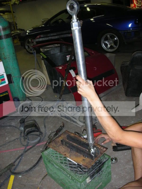

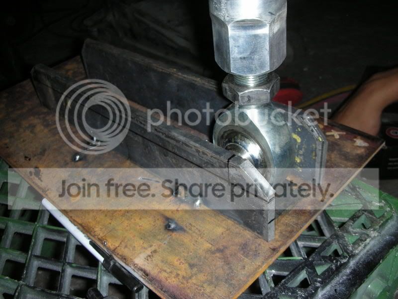

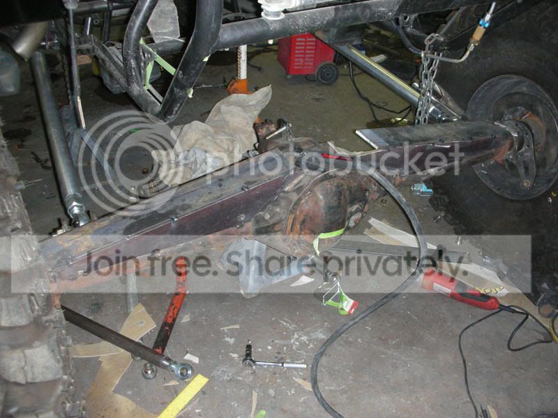

got the rear links mounts fabed up, two position options, built out of 1/4 and 3/8 plate..BEEF, headers and exhaust installed, water/oil temp ran. wiring sorted and put in, more interior panel work done, steering wheel hiem mount installed lots of crap:D

tig welded fabricated polished valve covers for the big block

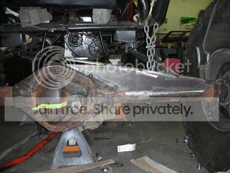

started building a truss, I was going to just buy one but they are all ugly and I dont want a tube truss.. made of 3/8 plate:eek1:
also decided to not do a 3 link panhard set up, I will just run a double triagulated 4 link now, uppers will be 1.5 250 wall dom sleaved with 120 wall 1 3/4" chromo tube, upper frame mounts will have 2 mounting options as well for adjustment.
also nate and I gt he big block running, the pro injection has some nice throttle responce! I had to sort out a few bugs, loaded the hell out of the motor with fuel so she was smokey! also got the wiring and guages finished, went through and did all the connectors and used heat shrink on them..wow lots of work!
Copy cat:
This is the one on my brothers 70HD
Except Shawn's will be much slower without all those speed holes. ;) BTW, nice work and that BB sounds sweet. :D

great minds think alike?:p: i think mine is a little wider and more beef though, I do like his speed holes..i want to get a nice hole saw but I want one that will last..ideas? looks like he used 3/16?? mine is 3/8 so I need a good bit and alot of cutting oil!

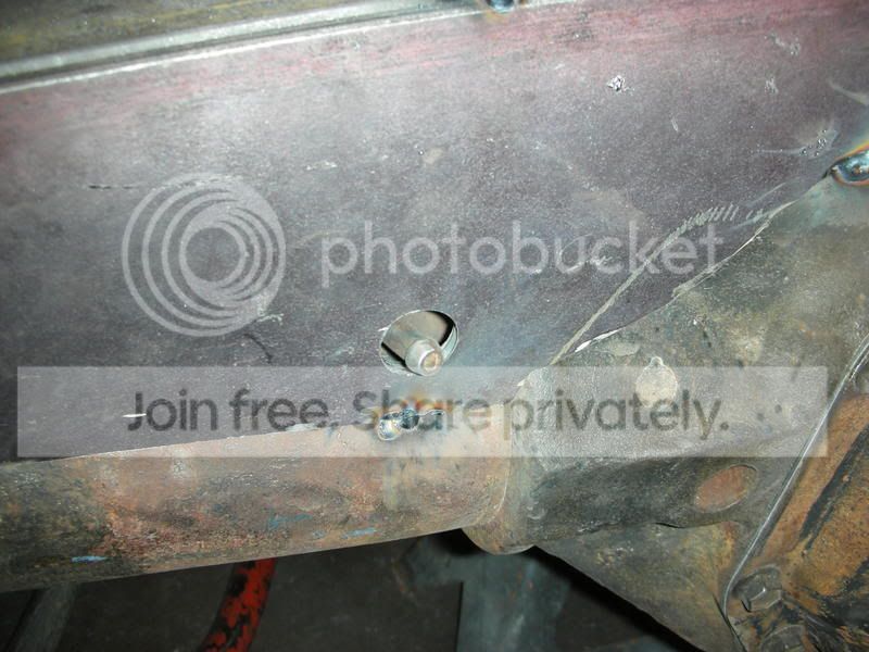

I believe its 1/4 plate. Three plates total. The front and back plates were waterjet cut from cardboard templates my bro made. He originally designed it to fit between the old spring perches (was going to use perches as bumpstop contacts)
But the top plate was made a little too long, so he ended up cutting off the perches. The hole saw he used was from mac tools. I dont have pics of it now, but he welded tubes in the holes, so water cant get inside the truss.
