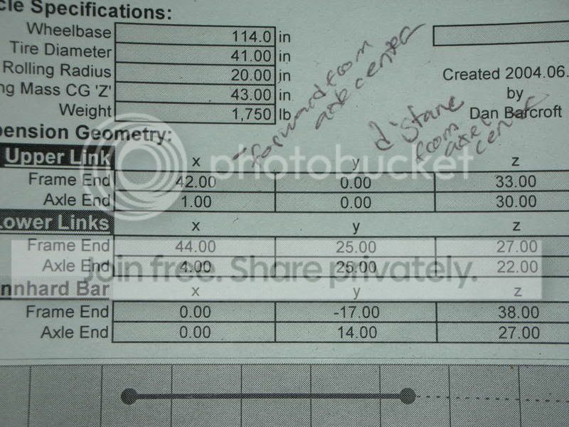

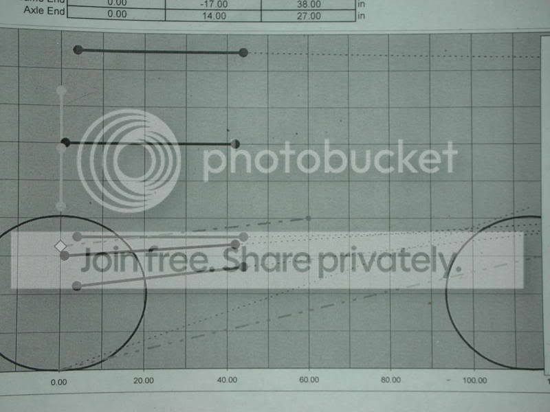

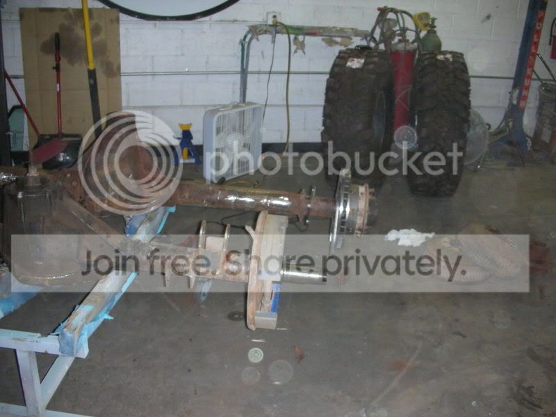

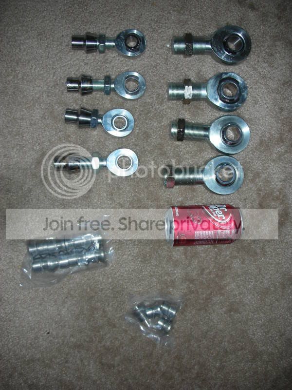

Finally made up my mind and ordered the material,

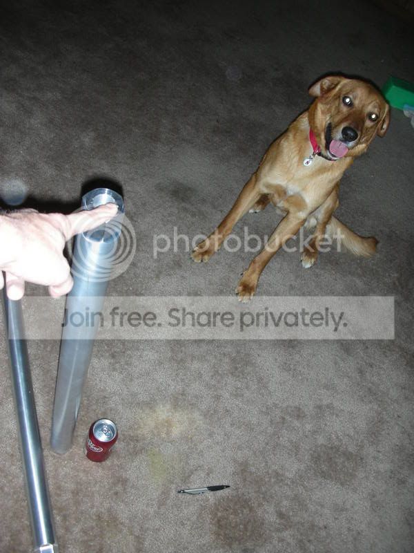

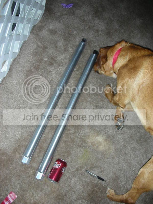

2 lower link material
(2) 2 inch tapped and machined aluminum links 20.00 a foot 2 hours lbr =330.

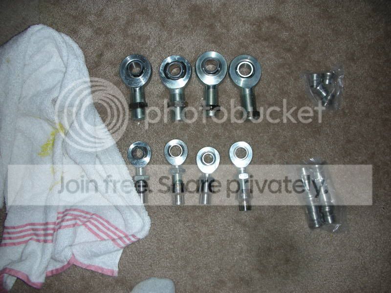

(4) 1.25 chromo qa1 rod ends=239.00
(4) jam nuts=17.16
(8) misalignment spacers =71.92
upper link
(1) 7/8 hiem 28.00
(1) bushing sleeved with dom at chassis end 15.00
(2) misalignment spacers =16.00
(1) jam nut 2.00
(1) tube adapter 11.00
link material..not purchased yet, 1.5 od 250 wall dom is my thought
panahrd
(2) 7/8 hiem = 56.00
(2) 2 jam nuts = 4.00
(2) tube adapter =22.00
panhard material? thinking 1.5 inch aluminum for some bling
so.. 333.00ish in lower link material and labor
and 500 ish in parts from balistic fab
thats about 850.00 before the material for tha panhard and upper link
my girlfriends face when I figured this all out...priceless
