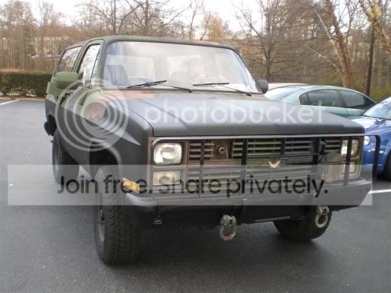

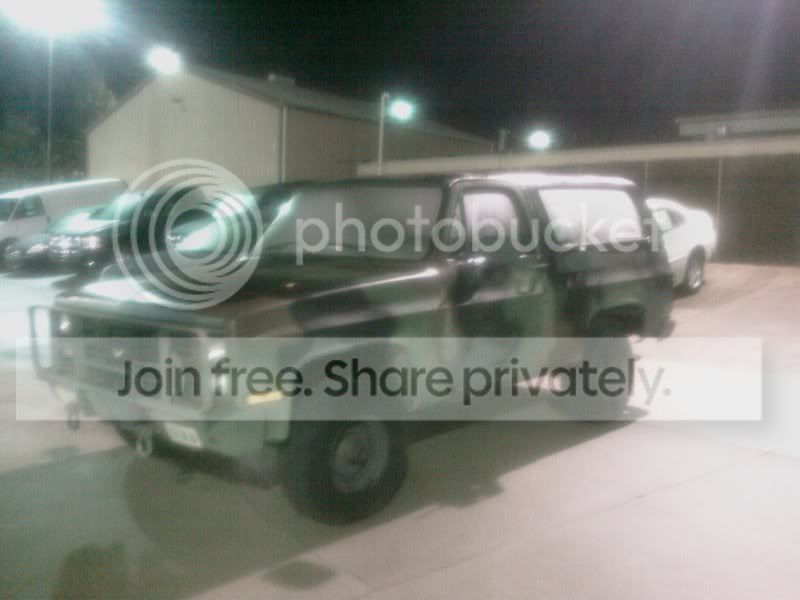

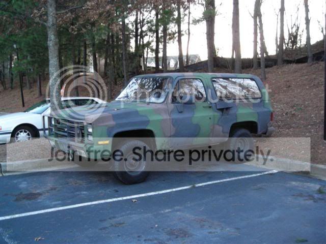

Here it is the night I got it.

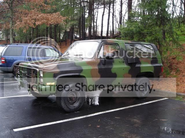

Here is a shot from the next day when it was raining. The paint really looks different when it is wet vrs dry.
Next day when it was dry out.

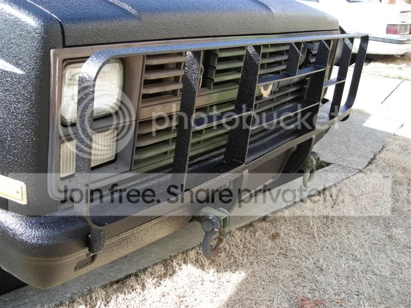

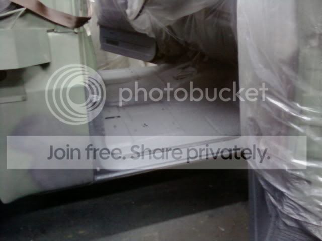

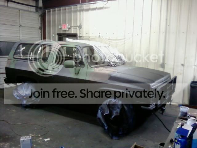

Now, since this is going to be coming back to Michigan with me, I wanted to do something to protect it from rust as much as I could. So, here comes the bed liner. Inside and out.
The outside I wanted to just to the rockers... but I also wanted to do the wheel well arches too. So, I figured... what the hell, lets just do from the body line down. Well... the hood had a big surface rust spot where it looks like there may have been a engine compartment fire at one time. So, I coated the hood area too.
Here are a couple day time shots of the completed work.

What sort of liner is that? You're REALLY tempting me to do more of The Blazer and Big Ugly.
Talk to kert for rocker protection. AJM and The Blazer approved.
Looks good, I agree with going green on top. Is that als liner that you used?
A local guy... deal I couldnt refuse. Speedliner. Almost positive that I will be doing the top green. Just some details to work out first.
I like it! Don't forget about them mirrors though lol
I didnt want it to look like a mask the windows and blast it job. So, I left the mirrors and door handles uncoated. I am going to mask and paint the mirrors and doors handles flat black.
