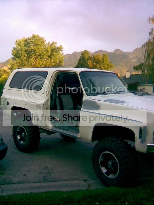

I figured I'd hop on here and make a build thread for my current project like so many of you guys have. I think after attending my first blazer bash my inspiration and desire to dig back into my truck was renewed.

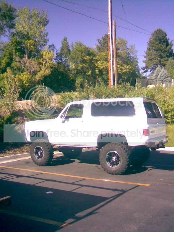

This is my 1978 GMC JIMMY that has gained the nickname Nightmare due to it fighting me every step of the way, if it could go wrong it did, some of my other threads read like a bad comedy, this truck did not want to be driven. Looking back over the years it was a huge pain but I have learned a lot and the truck is rock solid now so it was worth it. Here's a current pic from right before BB16.

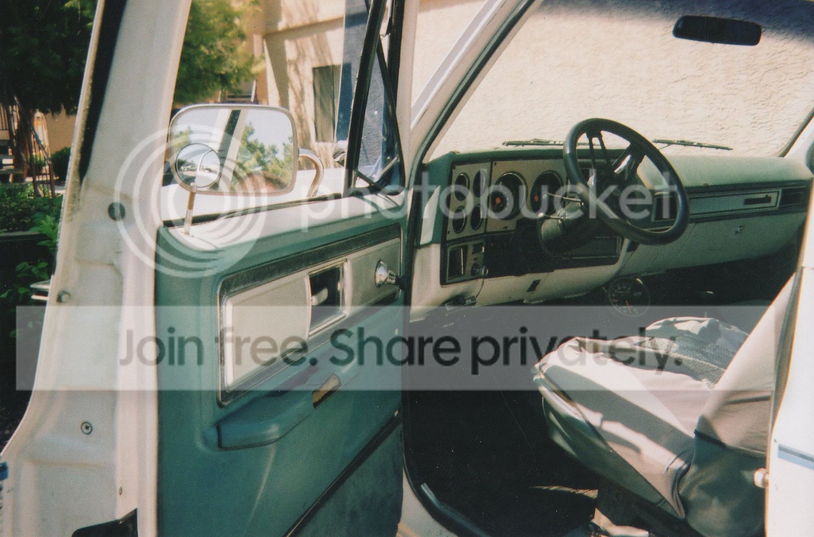

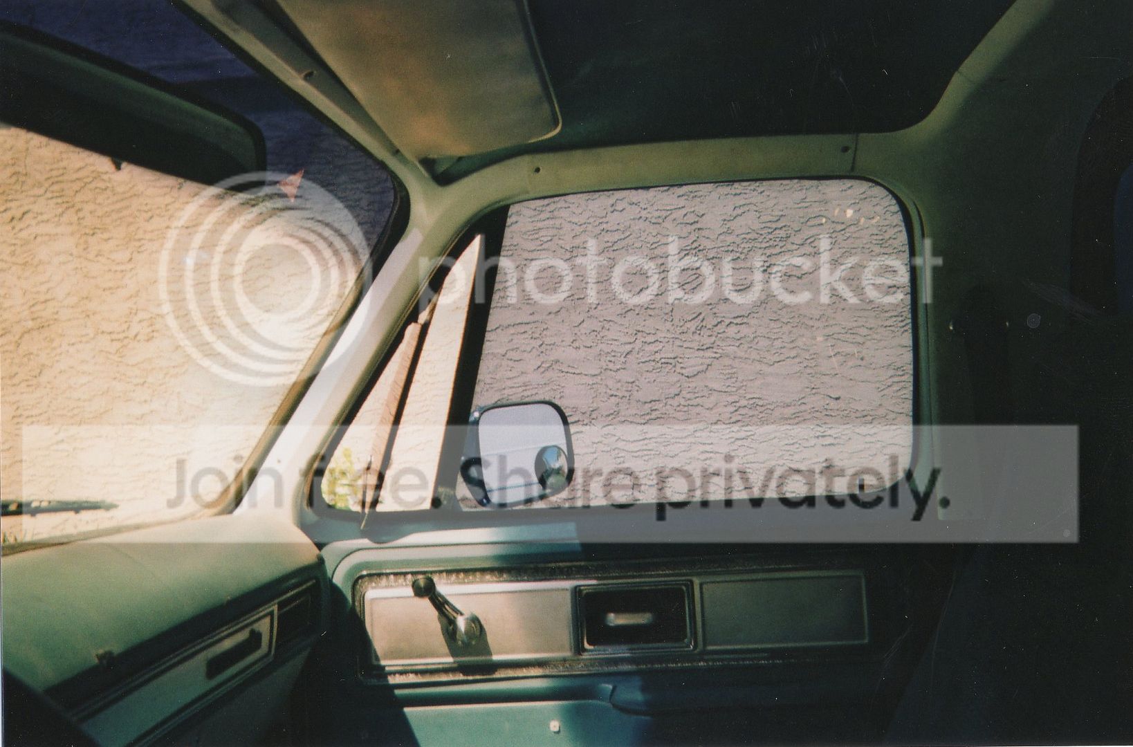

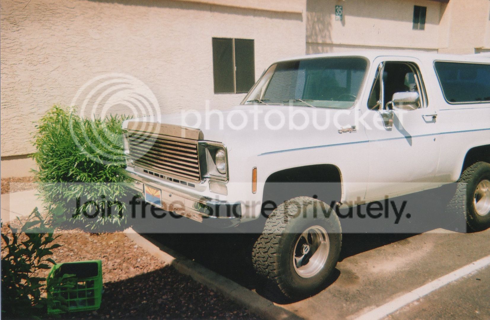

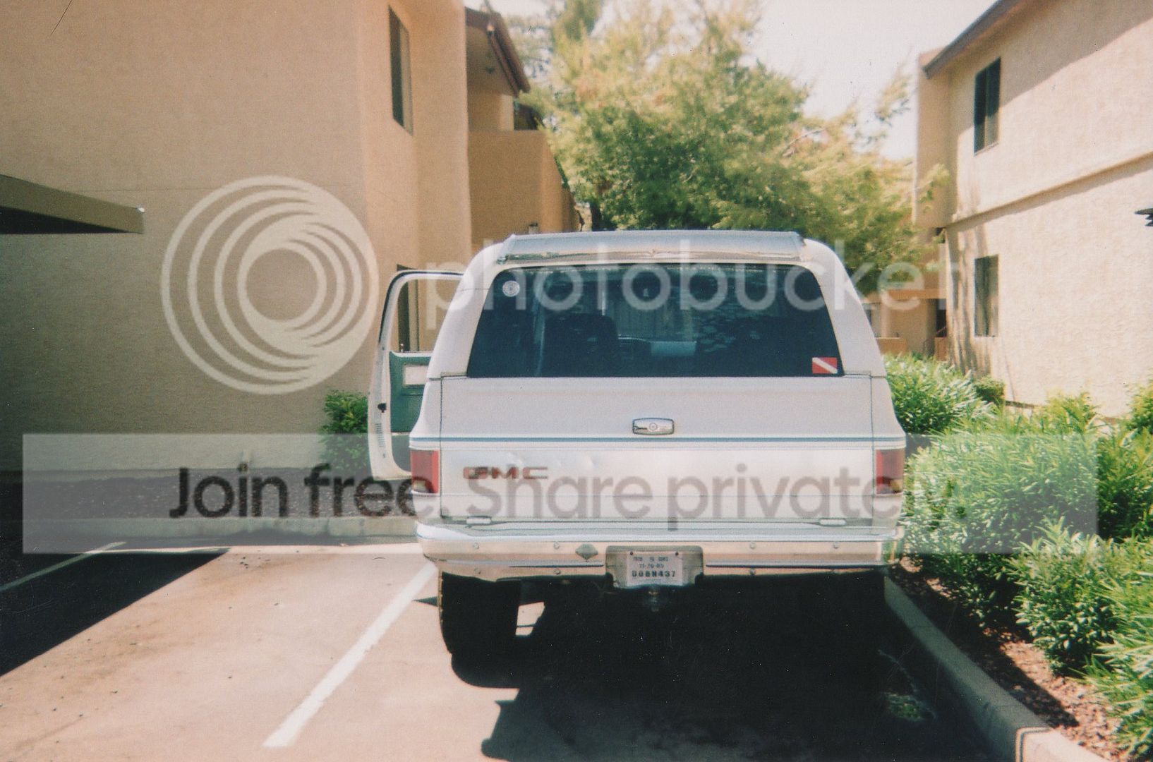

Here is what my jimmy looked like the day I purchased it.
Man I can almost smell that desert rot looking at the pics of the interior pictures. I wish I could find pics of the passenger side. It was pretty smashed,

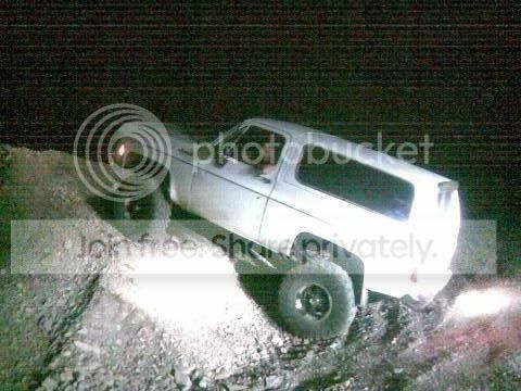

I saw your rig at the BBQ after the mishap with the other rig on Hell's. Did all of you make it to dinner? What ended up happening with the blue truck? I also didn't see either of you Saturday or Sunday? :(
Yeah I towed the blue truck off hells. My friend @72gmck5 and I made it to the BBQ but spent the rest of the weekend trying to fix it and hanging out. His transmission died so we ended up trailering it back to slc on Sunday

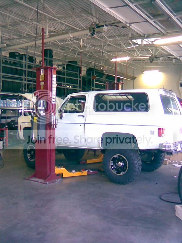

Since I needed new drivelines to match my new t-case I decided now was the time to lift it.

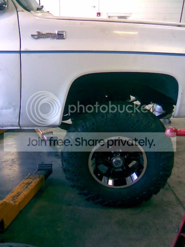

8" In the rear (6" tuff country Springs 1"leveler 1"block ) and 6" tuff country Springs upfront
I went with 37" super swamper irocs (probably not my first choice)

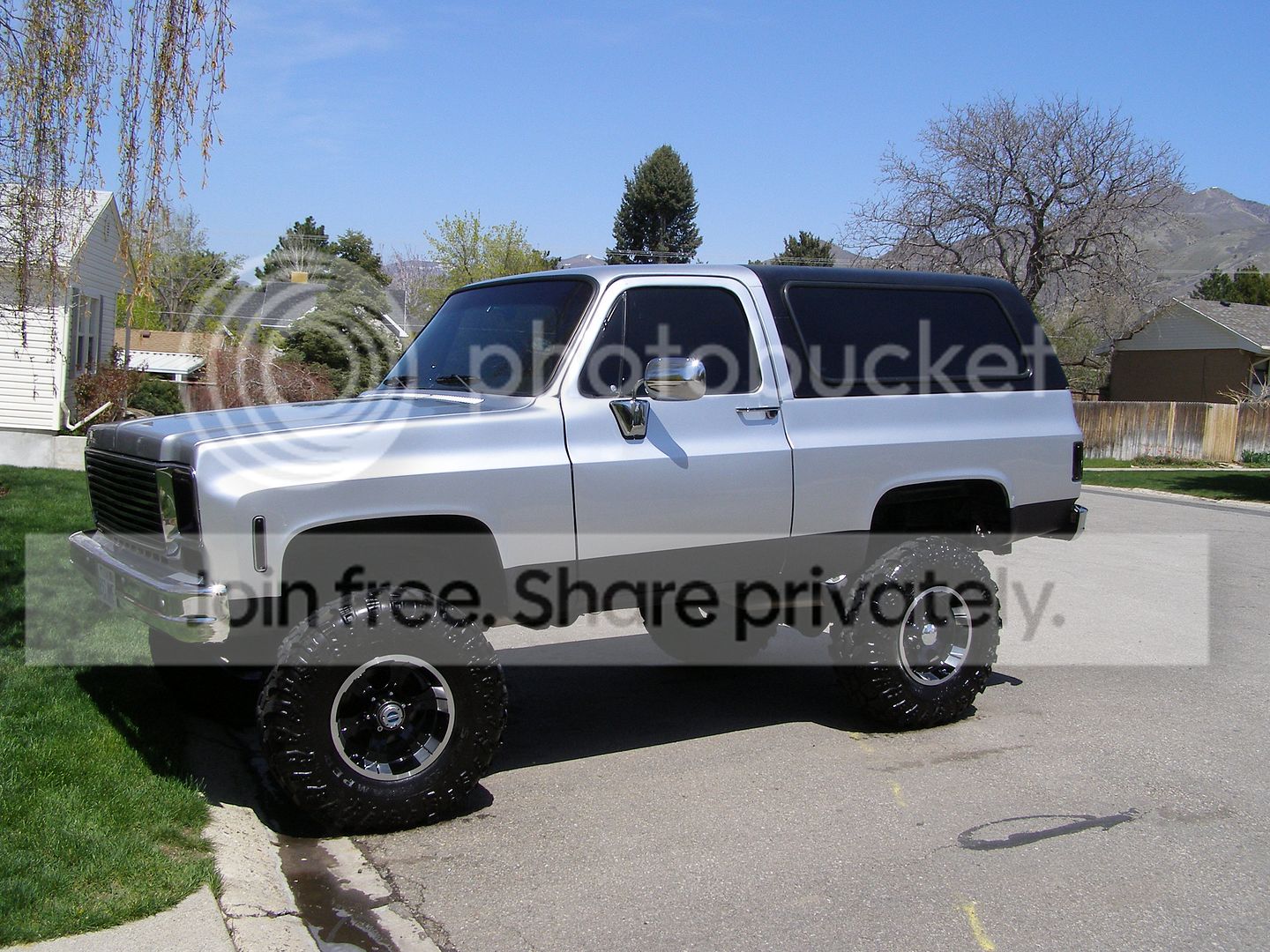

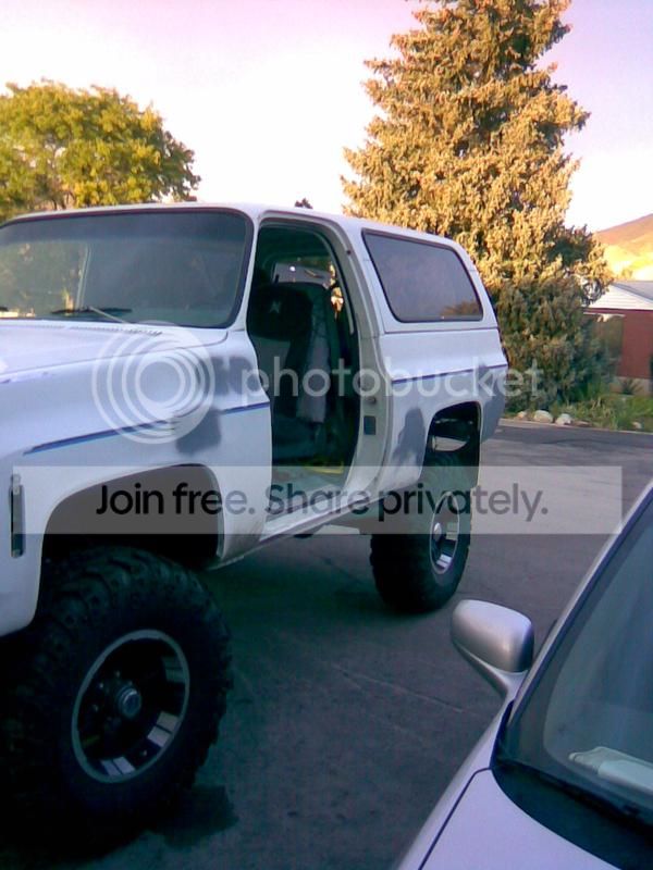

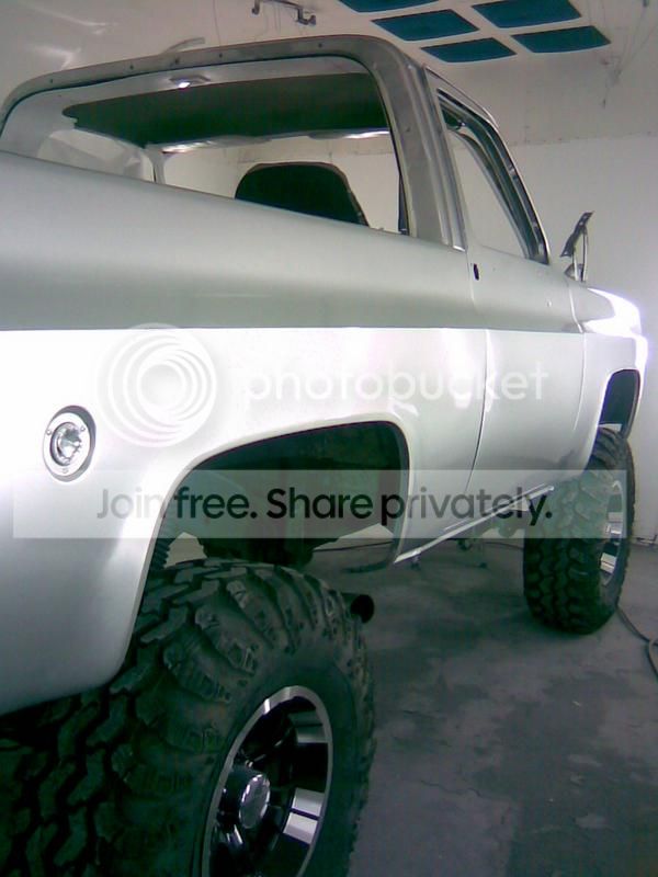

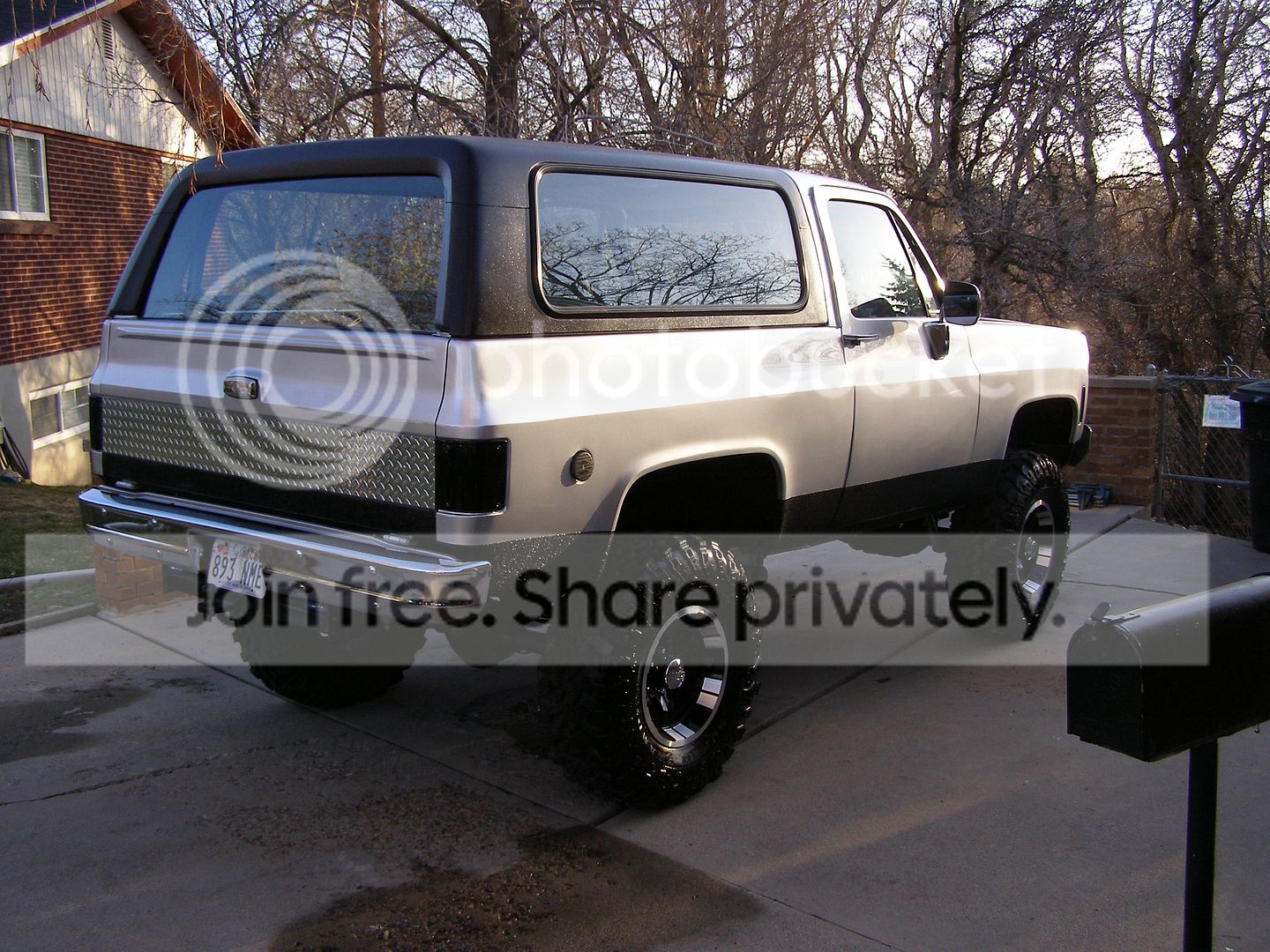

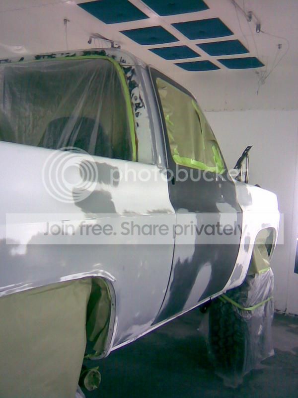

I got to work on repairs and started the body work.
I got lucky, one of my best friends is a really good Painter and he hooked me up. We bed lined the entire interior and tore the truck down to paint it. More than a mask and spray job.
After the body and paint were finished it won 4 wheel parts best looking right of the month :)

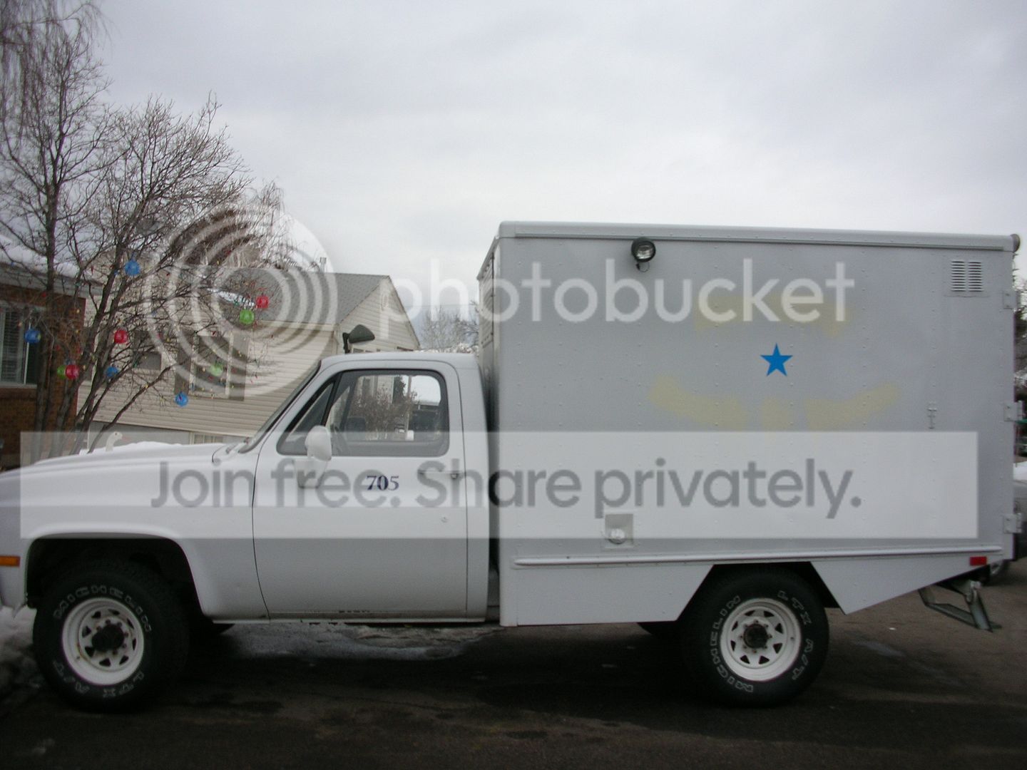

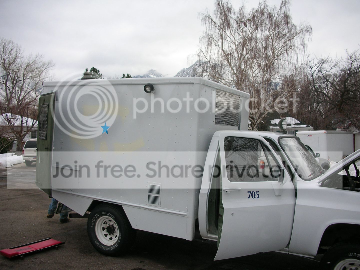

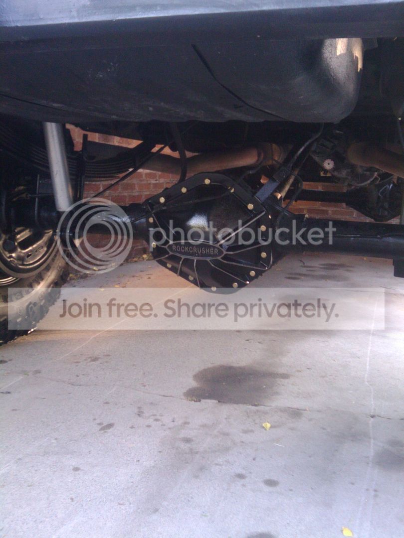

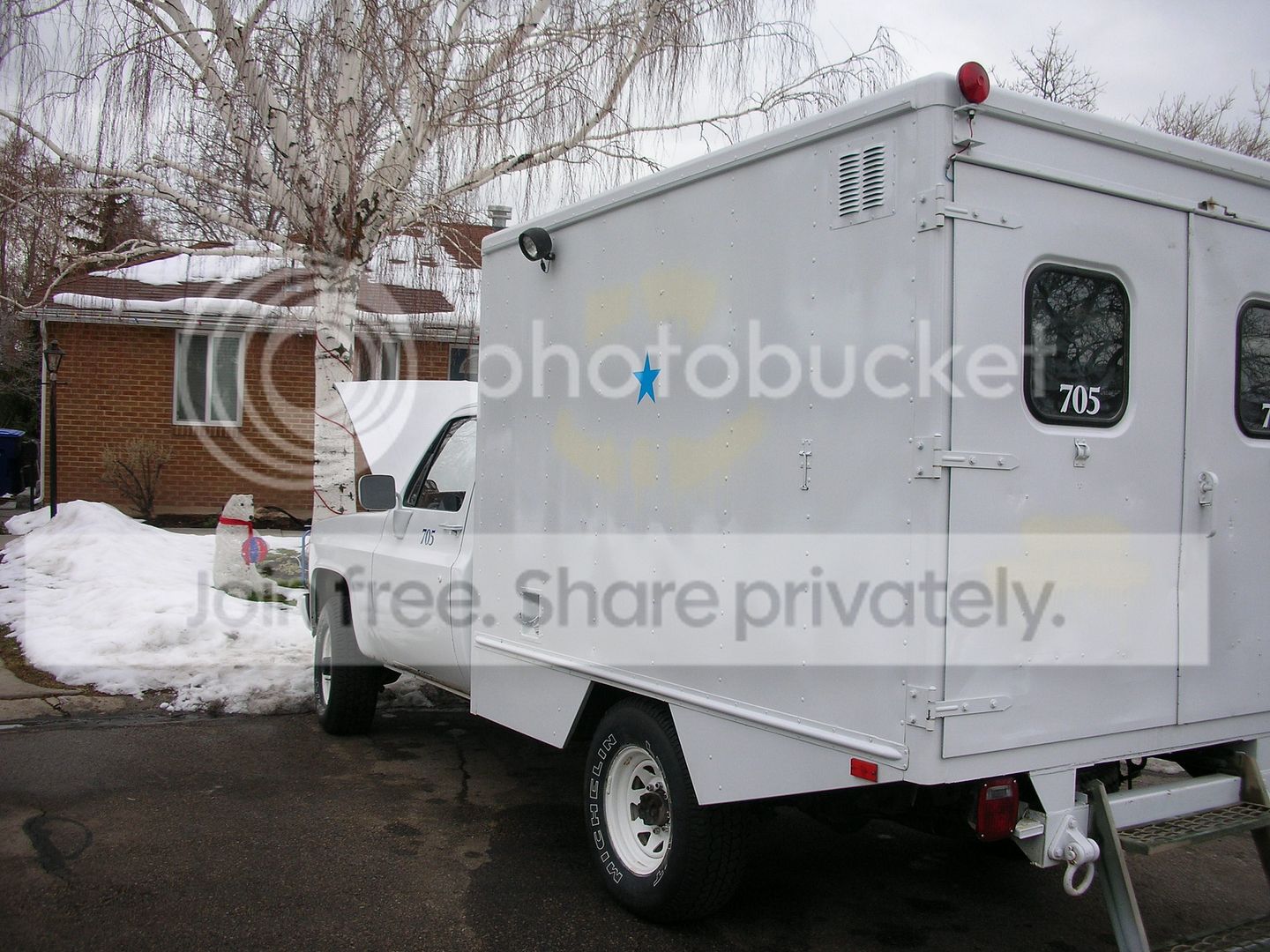

Next step was axles. My buddy @72gmck5 found me a sick donor vehicle. It was an ex-military search and rescue ambulance. Dana 60 front corporate 14 rear. 456 gears locker in the rear.
This thing ran and drove just fine. We swapped the axles and I sold it for more than I paid for it and everything to do the swap :) score!

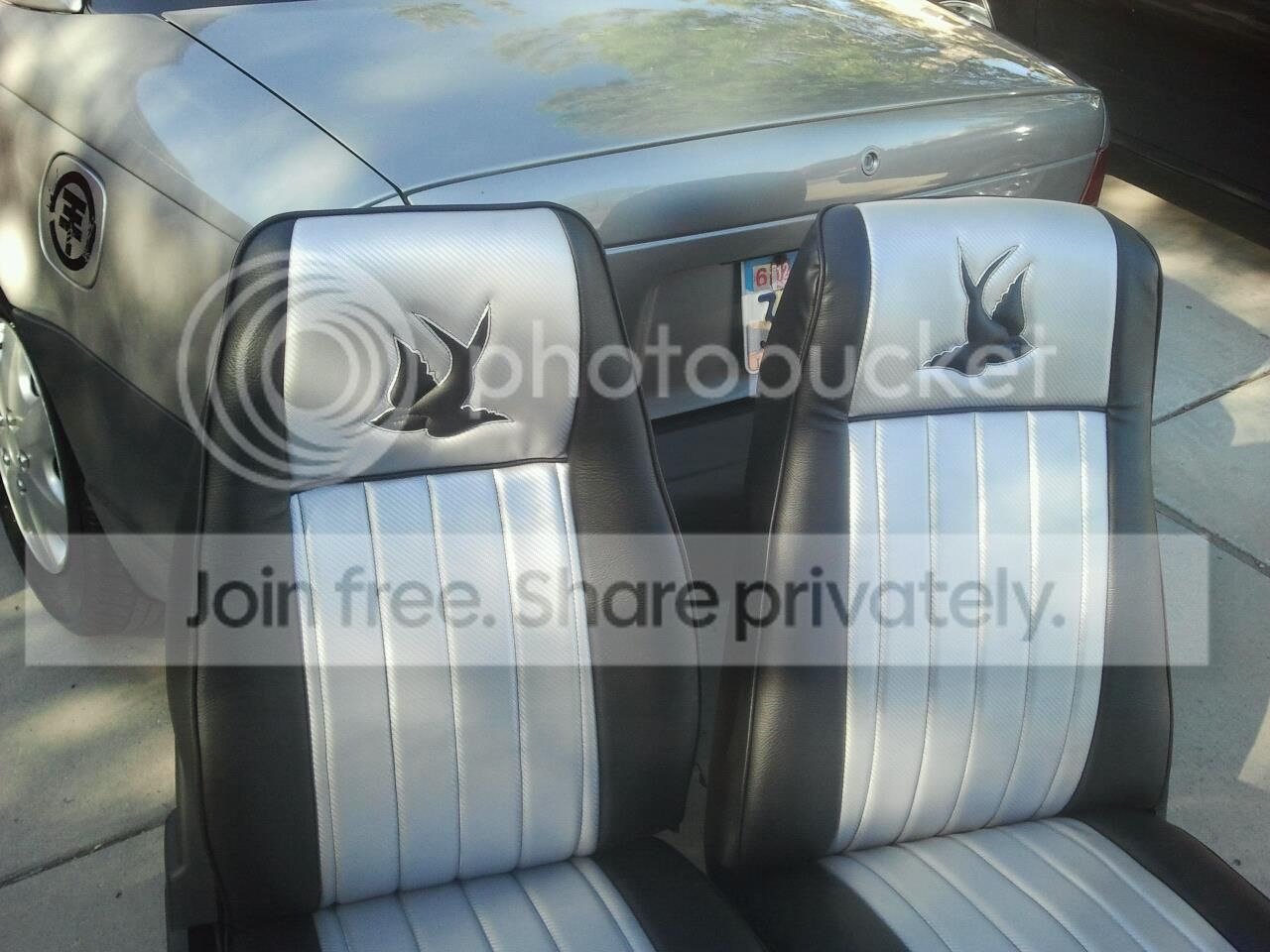

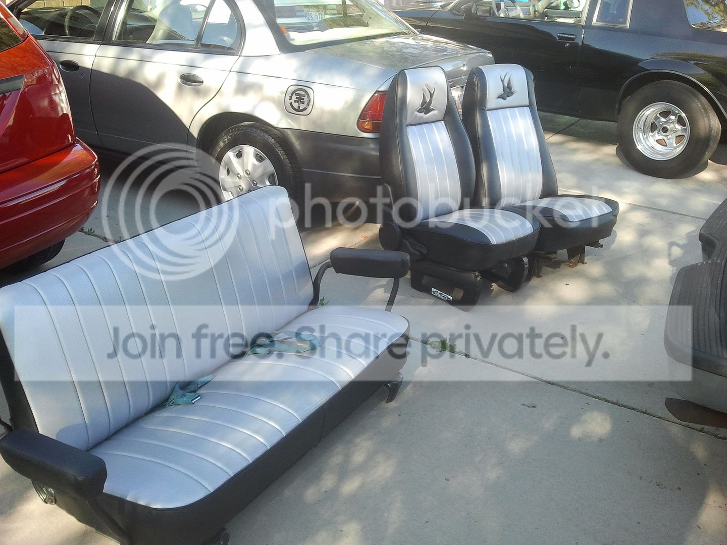

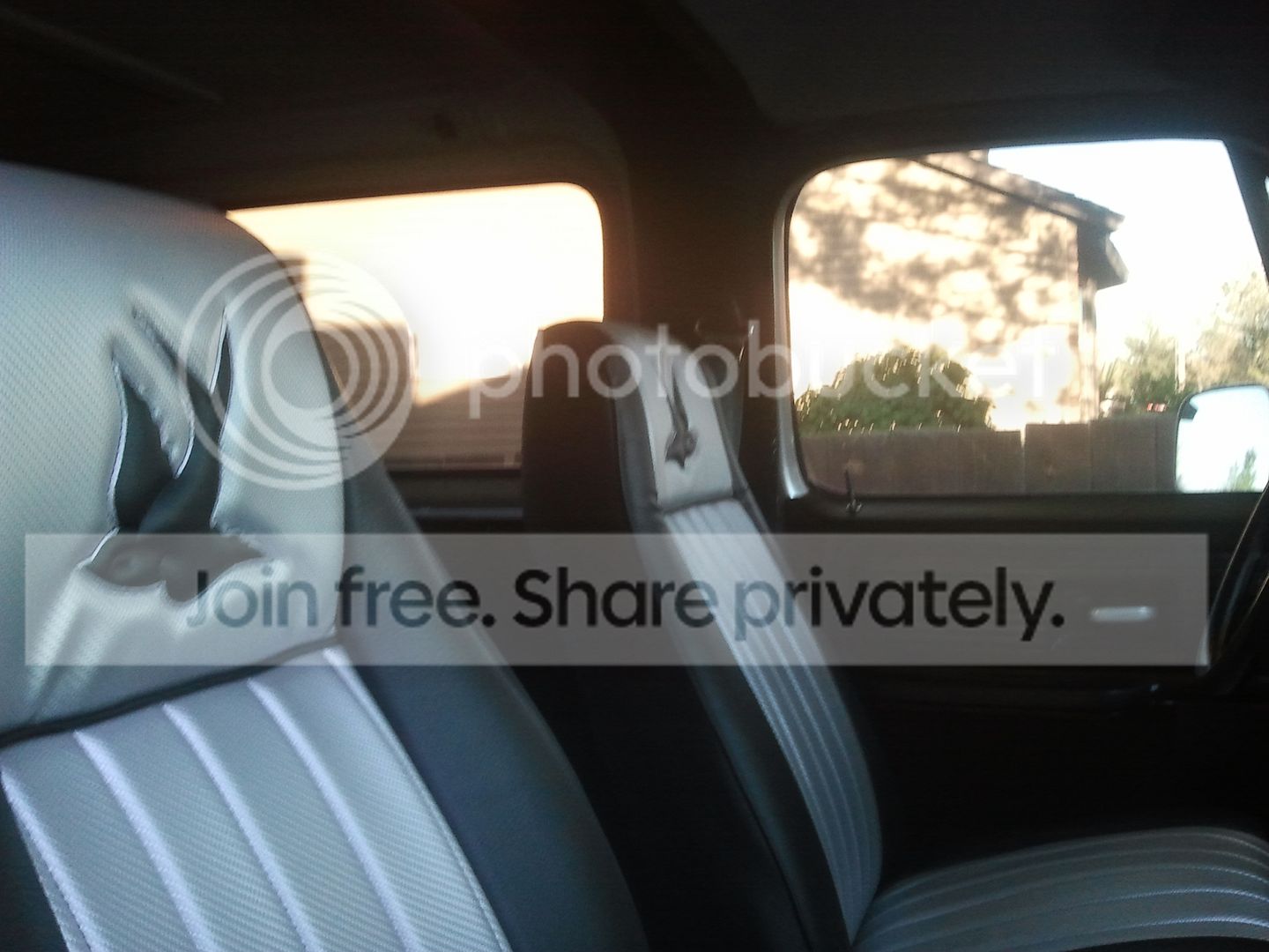

I wanted to do the interior of this truck because the blue rotted interior wasn't working for me. I went with new black carpet and custom side pannels for the bed that hides most my stereo equipment (I'll have to get some pictures) and as a birthday present my ex mother-in-law reupholster to my seats

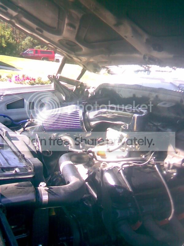

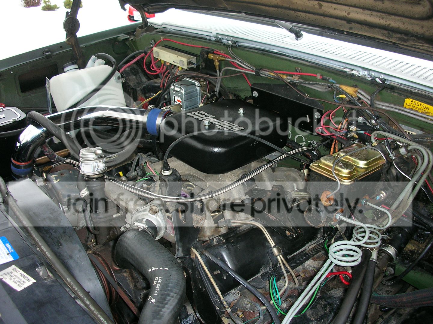

After the engine was built and the transmission came back from the shop I decided to rewire under the hood. And clean it up a bit

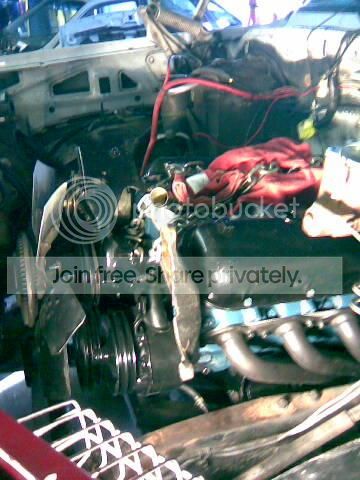

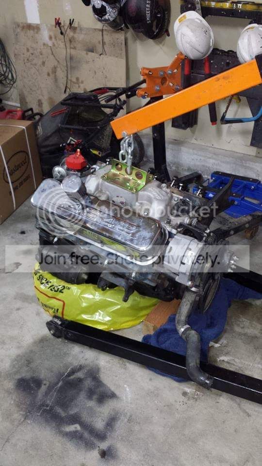

Then I got this engine installed. I was sooooo pumped
Well after the install was complete I tried to start it..... and tried... and tried.... had an expert come help me, we got it fired up but it just ran awful. We followed cam break in procedures to a T...... but wouldn't you guess I killed the new cam on startup..... f my life.. . The engine had to come back outo. Little did I know this would be one of 4 times I was going to pull the engine in the next year....

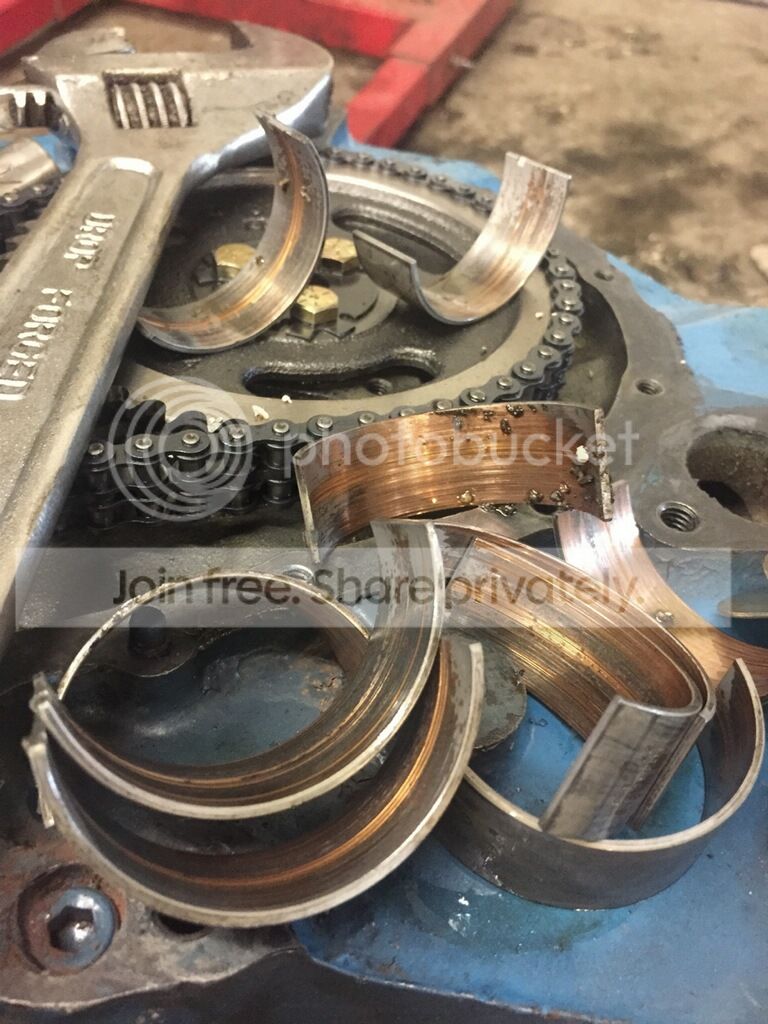

Well the new heads are on at this point this thing sounds amazing has a lot more power and generally runs like it should…. I picked it up and drove it home ( 10 miles) then drove it to my friends shop ( 5 miles) then on my way home it started making a weird noise…. That’s when I noticed the oil gauge was reading ZERO…..
My head was about to explode. I had to have this thing towed back to my friends shop because clearly something was broken with the repair he just did 20 miles ago…

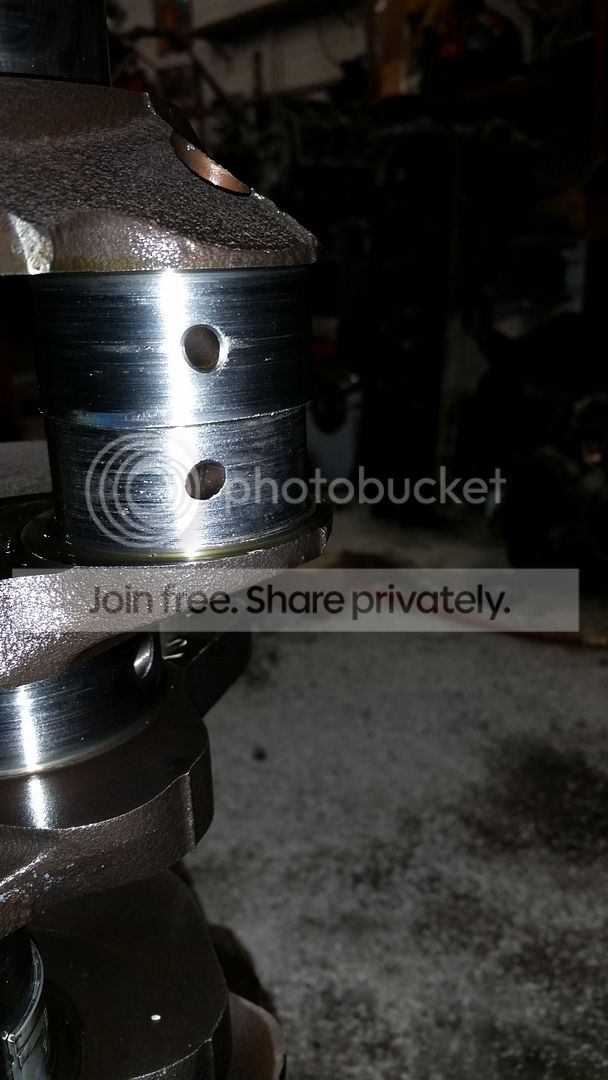

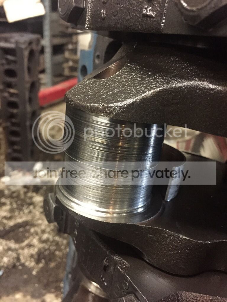

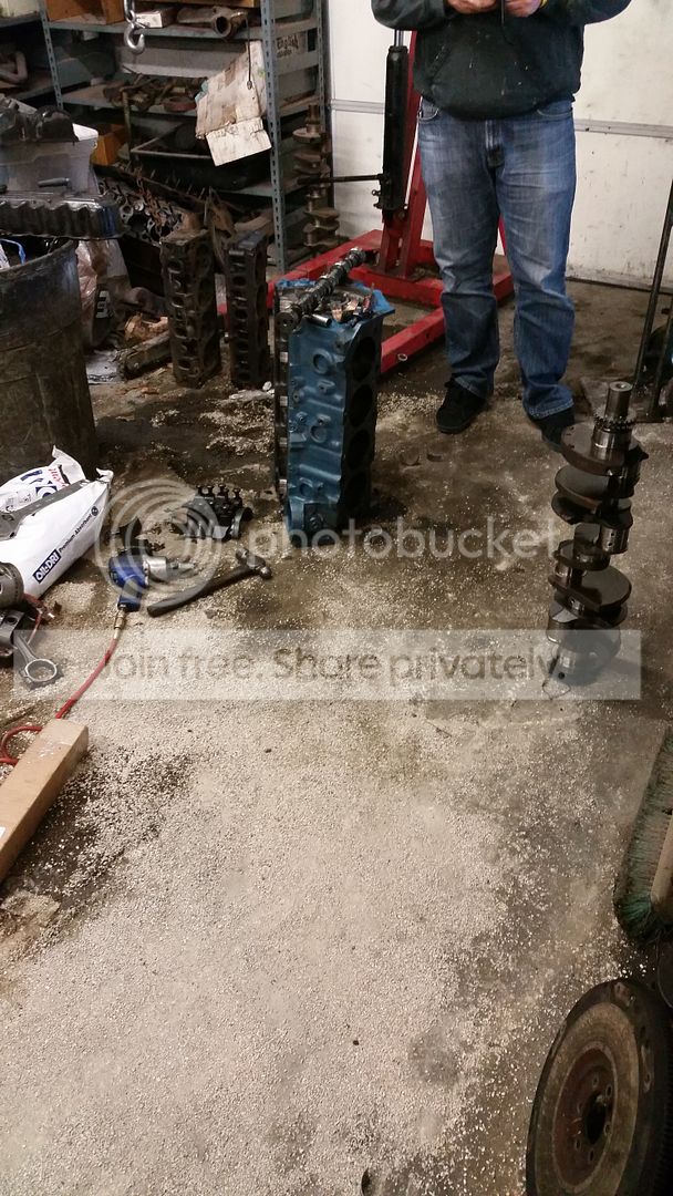

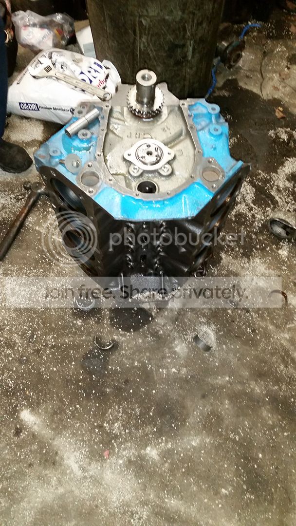

He dropped the pan and wouldn’t you know ALL the bearings are wiped out… no one has a clue what the hell happened… so the engine came back out 100% and delivered to the machine shop to investigate what went wrong. To this day we have no clue what wiped out the bearings
Clearly the crank was killed along with the bearings… some metal even made its way up to the cam and did a little damage there also… so needless to say all I had left was a block, sweet heads and pistons.
