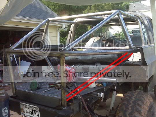

After all this time I finally decided to put a cage in the Jimmy. Stole the overall idea off of a picture I saw on this forum. Here's a few pics to start with. should be done with it in a week or so. Still have a lot to do. What do you guys think so far. I'm using 2" HREW, and mounting to the frame in about 8 places.

Got some more of the cage done this weekend. Still have a couple pieces left. Windshield cross bar, bar behind the back seat, and one more tied into the frame. Looks a lot better and more like a cage now. turned out pretty good. This is the only picture I have, taken from my cell phone. I forgot the camera. What do you guys think? Any suggestions?
HREW tube should be bent with the seam on the inside of the radius. DOM does not matter, but HREW can split at the seam during bending. As you probably know the welded seam is the weak spot of the tube and during an impact if a tube that has a bend in it get forced and bent further from an impact it can split too under force causing a much greater failure then it would if it had not split of course. FYI. Other then that it looks really good.
I was unaware of that. Thanks for the input, although at this point it's too late. I guess now I know. It makes since though.
I like the back..... maybe add a triangulation piece down low by the floor on those 2 down posts up to that horizontal run on each side, to the underside of where that tube comes down into it....... might even be able to incorporate a shock mount in that too...
like this......
i figured it would help serve 3 purposes, help transfer any vertical load to that back post, possibly incorporate long travel shocks, and look good....
