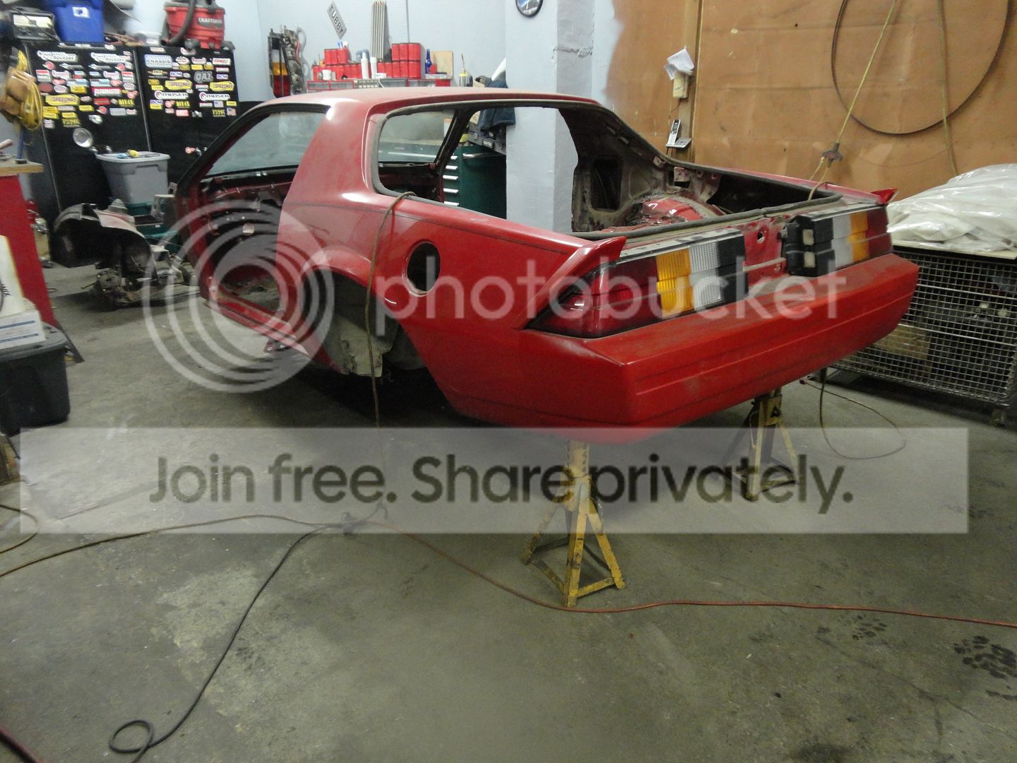

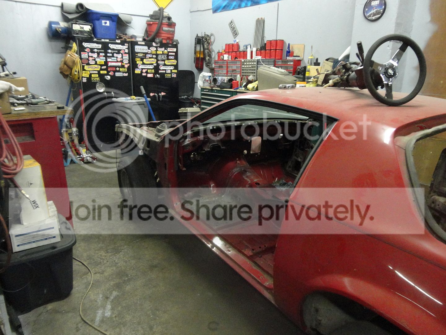

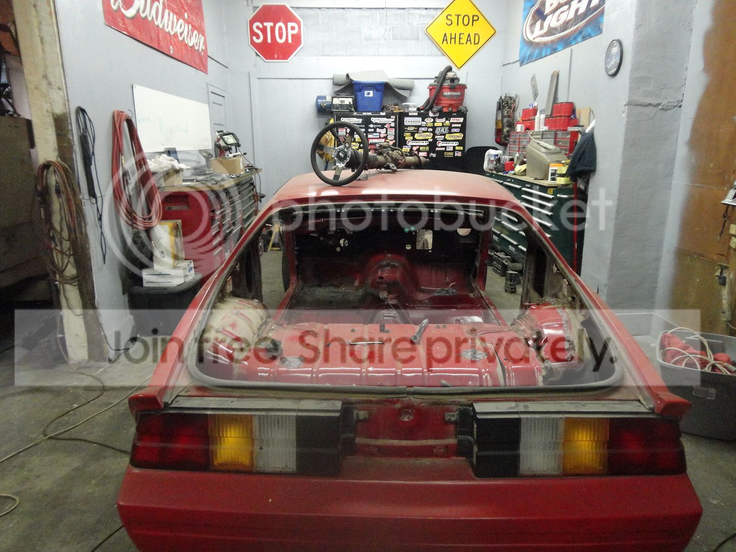

My brother has gotten it pretty stripped down. Only thing left that he wants off the car is the wheels.
Never to see the street again.

Not much left of it now! Wow, quick job stripping it down. That floor makes me a bit jealous seeing no rust and knowing there is some on my floors.

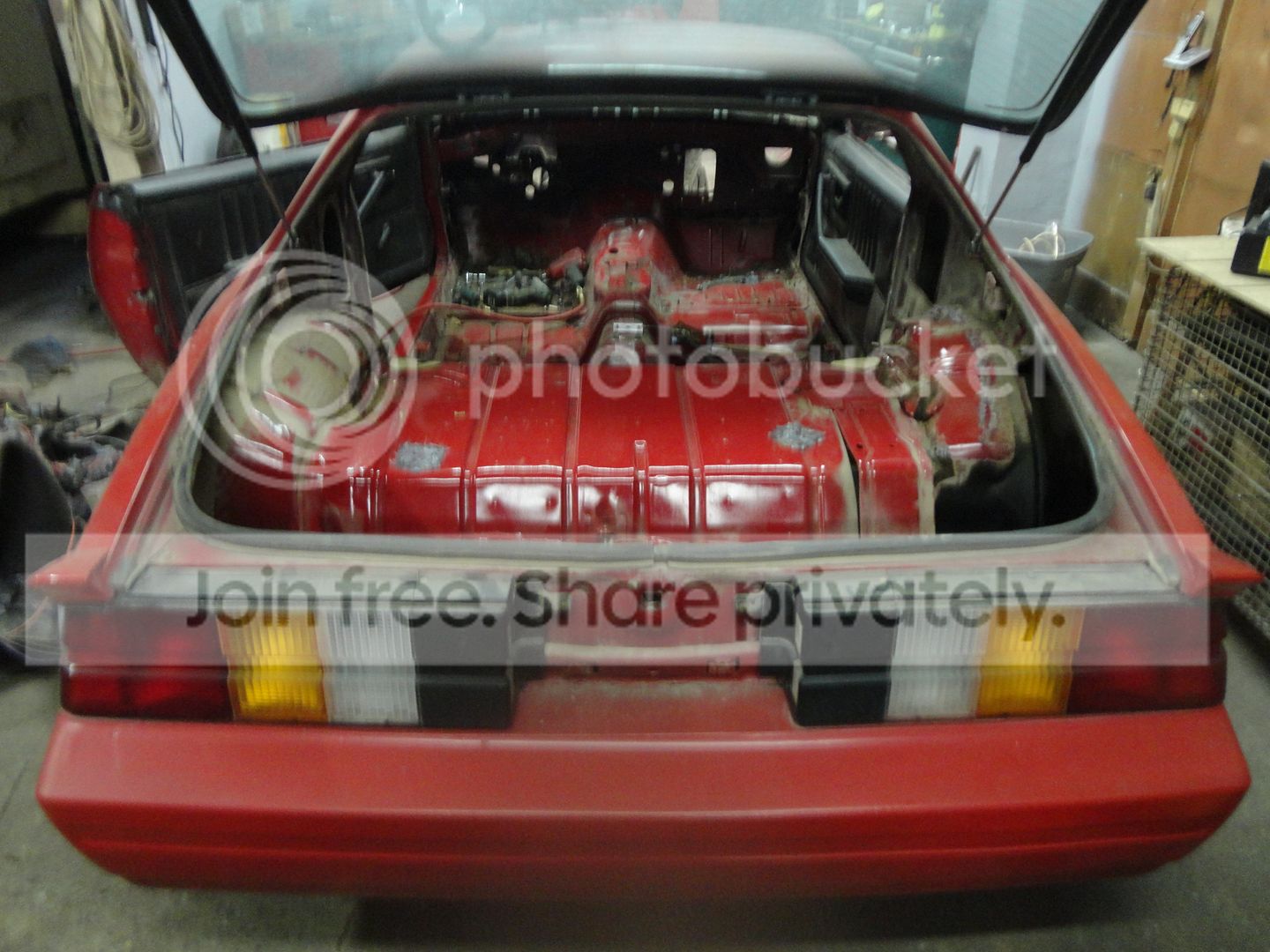

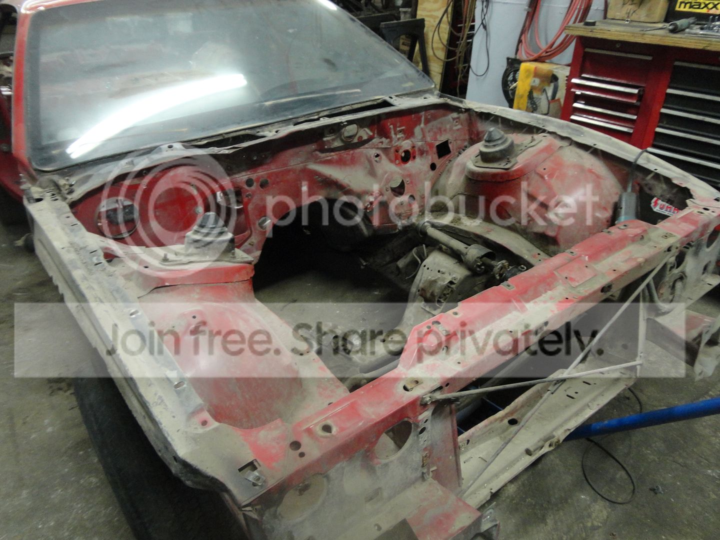

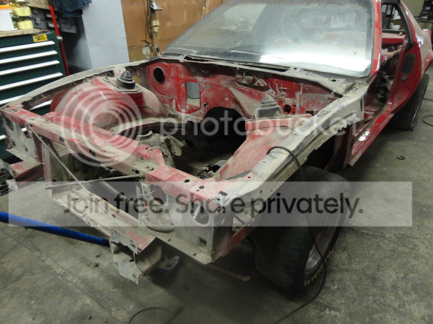

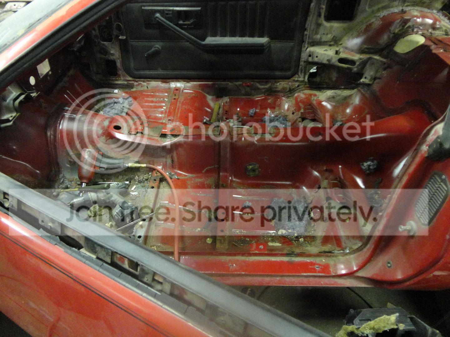

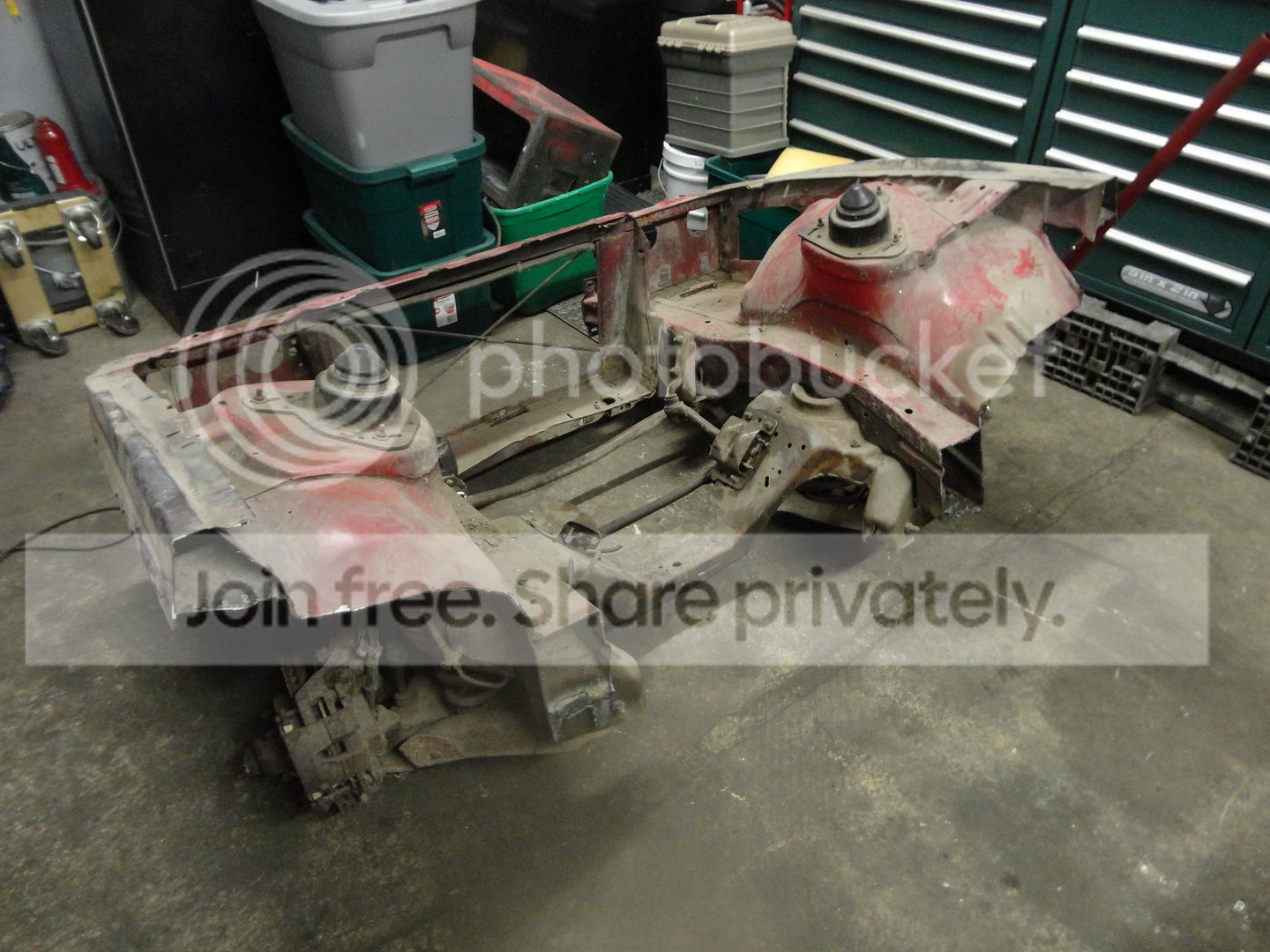

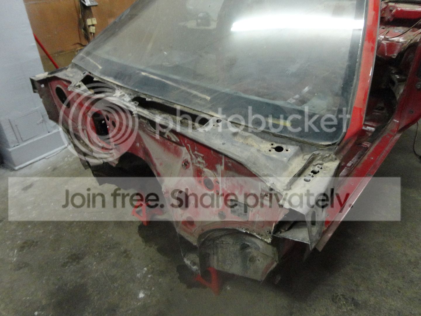

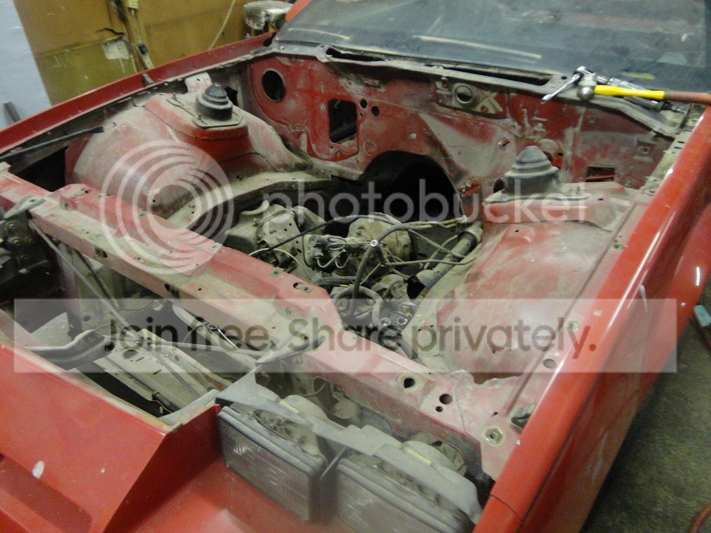

Still a bit of removal to do before I can say its stripped. Rear axle and all rear suspension will come out. Fuel tank has to come out. The entire floor will be cut out including sub frames and firewall forward will get chopped off. Factory firewall will be removed and a new one put in 8" or so rearward of where the factory one is. OH and the tail lights will get gutted out and the lenses put back on.:D
Currently debating whether or not I want to got to the work of a chromoly chassis or stick with mild steel.
I could do the mild steel much quicker which in the end may be the biggest deciding factor.

Maybe 300 lbs. to chop out yet.:D
