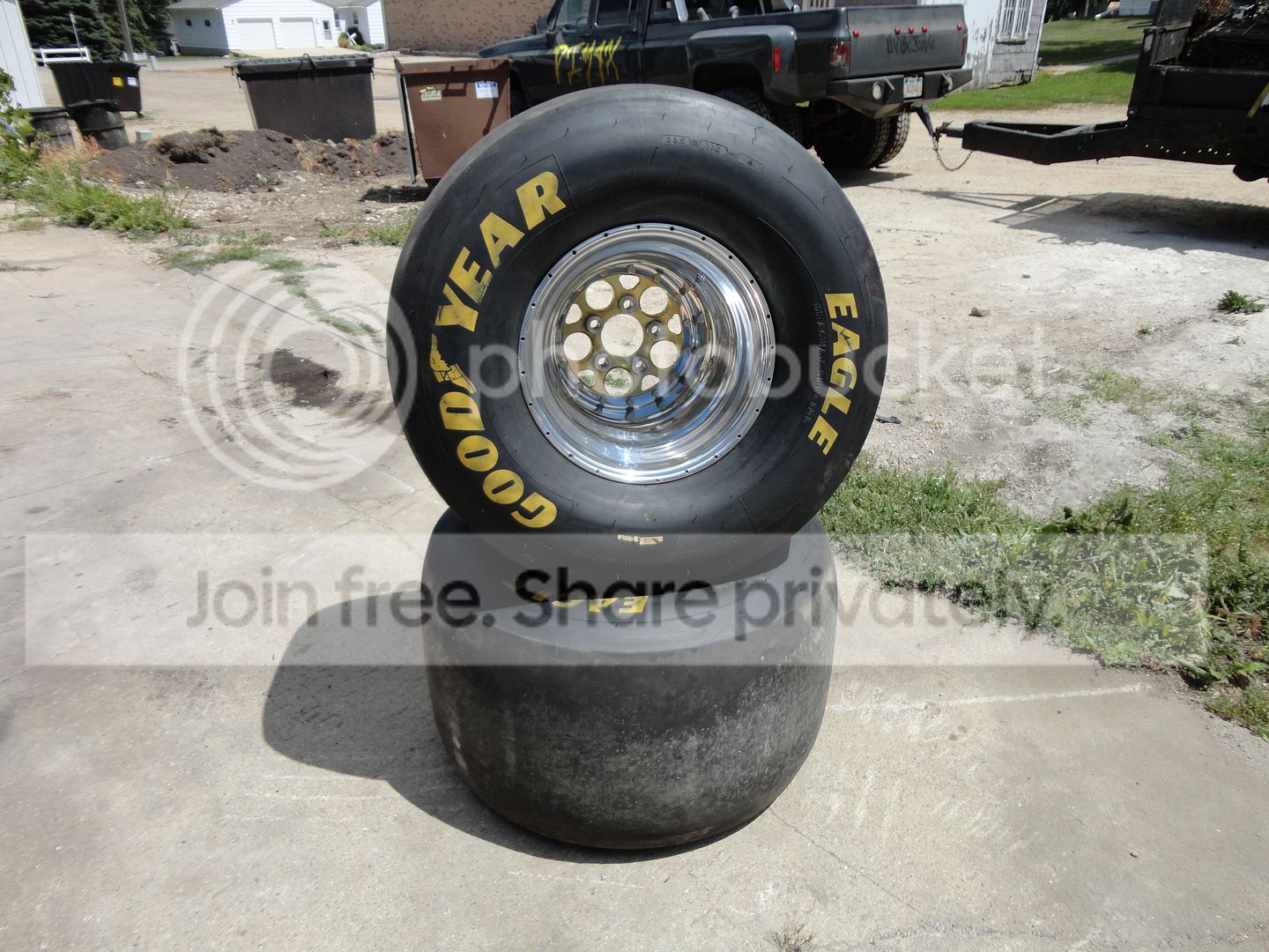

this is cool Kert. those are the ones we were looking for in Joliet right?
Yep, thems the ones.
Here's a shot of them with the eagles on. Bead screws to come much later.

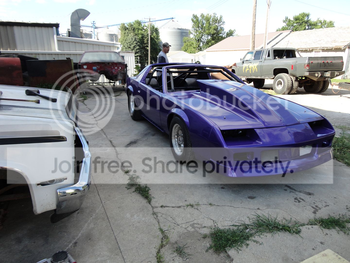

And my brother's car going back together.
He stole Bretts hood!
those look great Kert.
Does Kerry already have a block and heads?
Car looks awesome Kert. I keep seeing pics on FB.
When I was in college, in 1993, I put bead screws in my bias 38.5 TSLs. I knew nothing of beadlocks back then. Don't even know if they made them. I worked on a sprint car team and was into drag racing. So I ordered a set of band new rims and tires. And started drilling! In two yrs, one tire came off one time in the mud. And all those screws shredded the tire. I flipped the tire and ran it for yrs.
Good times!
