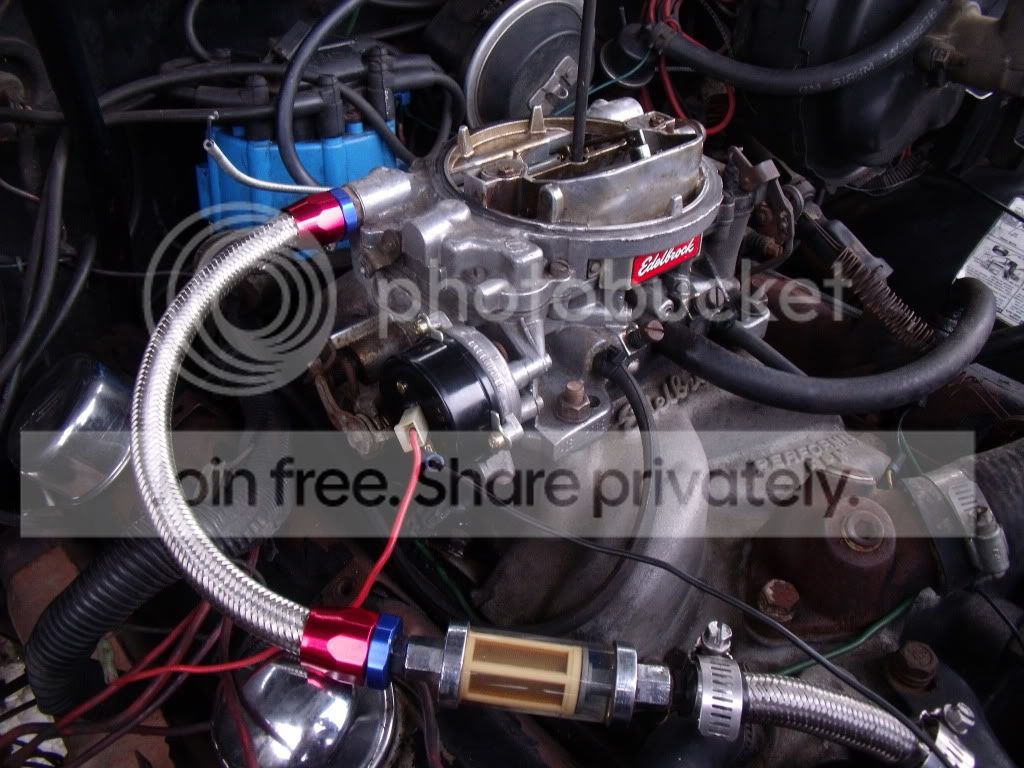

Should be easy...Theres only 2 vacuum lines to the carb. PVC and carb lines.
True, for the Edlebrock, should be three up front, PVC, ported to the distributor, and mannifold for trans or cruise or whatever, and the one in the back for brake booster. But he also needs to check the carb base, intake manifold at the heads, and the fitting on the back, that is usually a 'T' for the climate control, and something else. Also the PVC, line, and breather for the other valve cover too, probably doesn't have the cannister hooked up anymore.
The three ports in front of the carb starting from left to right. The first one is capped off. Second one goes to the PVC and the third goes to the distributor . The one in the back of the carb is capped. I have no emissions what so ever. Tomorrow I'm goin to do a leak test and check the carb to manifold for leaks. It might the crappy spacer I'm runnin.
Wait a sec, i have the 3 on the front. The left one on mine is going to the distributor, middle to the PCV, and the one on the right is capped off... Which one shoul be runnin to the dist, the left or right??? Maybe thats why im gettin 8 mpg lol.... Or maybe thats why yours is runnin weird, try switchin the one to the distributor... idk lol.
From left to right looking at it (passenger to driver) First one is ported vacuum, it's only job is for the distributor. (I'm not going to start a ported/mannifold vacuum for distributor discussion here.) Middle is larger, PCV. Right is mannifold vacuum, you can hook your distributor, or anything you need full mannifold vacuum, such as transmission, cruise control. The rear port is for your brake booster.

Ok...I had a leak between the carb and manifold ! So I put a 1" spacer on and the rod on the top hole of the Accel Pump. The truck takes off great from a stop, but now chugs a little when cruising around 30mph ??? Is this because of the spacer or where I have the accel pump? So many variables!!!
Also Im running with the choke valve open now! I tested the choke coil by taking it off and warming it up with a torch. It didnt move a bit !!! I have a new one on order.

Your accelerator pump is front top of you carb with the arm coming off of it with 3 holes in it. I think u should have more vacuum than that at idle.
