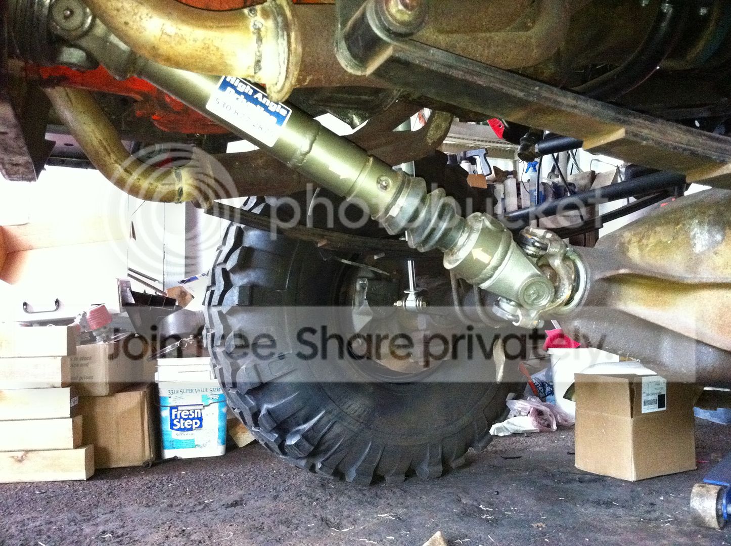

What kind of driveshaft (CV or nonCV) are you running and what angle is it set?at?
They're High Angle Driveline shafts. CV front and rear. I don't remember the angle on the front one. I can measure it up in a bit here. There's no binding or anything but it is a pretty steep angle (which is why I went with Jesse's stuff).

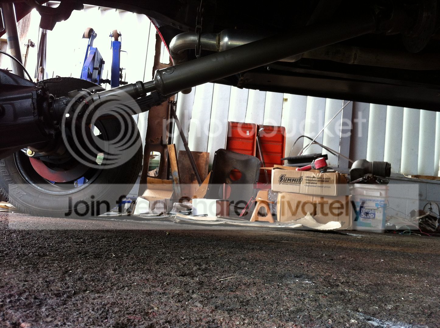

New vs. old:
The driveshaft looks good but the angle doesn't. The pinion should be directly in line with the driveshaft. That will reduce your caster a few degrees as well.
Yeah, I'm about to call Kert in a couple minutes here and get some different shims. I haven't rotated the c's though, so I probably won't be able to get the front driveline angle perfect. Based on the measurements of the shims that are in it, can anyone confirm quickly that it sounds like it's about a 6* shim??? (I hate math:doah:)

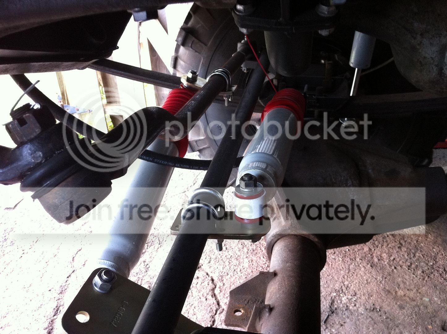

Another heads up. I got a dual steering stabilizer kit from 4wheel parts yesterday (only place on island that had any...) and threw it on there after some modification to the kit so it worked with the crossover/highsteer. I just took it for a drive around Kailua trying to recreate the dw. When I hit dips/bumps on either side of the truck that were causing it before it no longer does it. I was obviously paying closer attention than I normally would if I were just cruising, but you can feel it *just* think about it, but it does not wobble now:woot: I figure once the shims from Kert show up then it will be 100% taken care of. As of now I give it a solid 97%. Now a few more shake-downs around home and it'll be time to go beat on this pig a little:saweet:

Z71, Do you happen to have a part# for a dual steering stabilizer setup? It's for a 90 GMC sub with a Dana 60. My diff has that tab on it and my tie rod is that long one with the hole in it for mounting a single stab. I know I will have to cut the tab off the diff so I can use the supplied brackets, but the 4x4 parts store keeps giving me a part # for a ford or dodge. Thanks
I got this kit from 4wheelparts - SKY7255. I'm running crossover/highsteer though so I had to get creative with it. I used the bracket on one side and made a tab on the spring plate on the other.
You may be able to get away with using a longer bolt through the tab that's already on the axle and using one of the plates/u-bolts in the kit to put the second steering stabilizer onto the tie rod under the other one. Could work I think...
It's a lot better, but still a little low at the pinion. Eventually I'd like to have the c's rotated but I'm not in a hurry for it. With thr hubs locked I get a shimmy at about 30mph. I'll grab a pic in a little bit here
