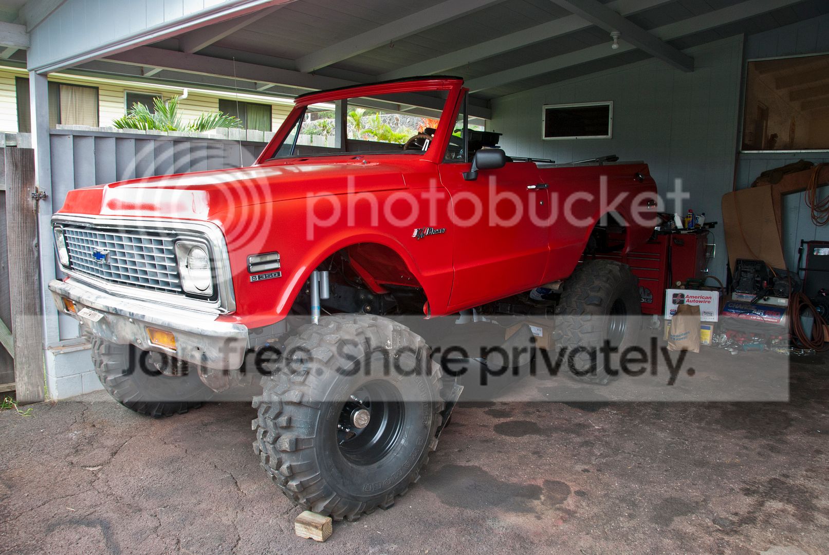

So I'm finally getting close to being "done for now" on my blazer (at least until we move). Taken it for a few drives and overall I'm very pleased. I did however get a wee bit-o death wobble the other day. I rechecked all my u-bolts, bearings, tie rods etc and the only thing I found to raise any concern is my caster angle appears to be at 10*. I got this from putting my angle meter on top of the steering arm. I have crossover/highsteer and new kingpin springs/cups. I know I should put on a steering stabilizer, but was just curious if that caster angle would be adding to the problem? Any help is appreciated as always.
