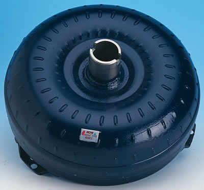

I was looking at the reman'd tc that I was going to use, and I don't trust the shop that installed it, and can't find anything on it to tell me who built it with it, so to heck with it. Didn't spend near as much getting the tranny fixed, so I ordered this today. B&M 20416 Holeshot 2000RPM flash tc from Summit.
