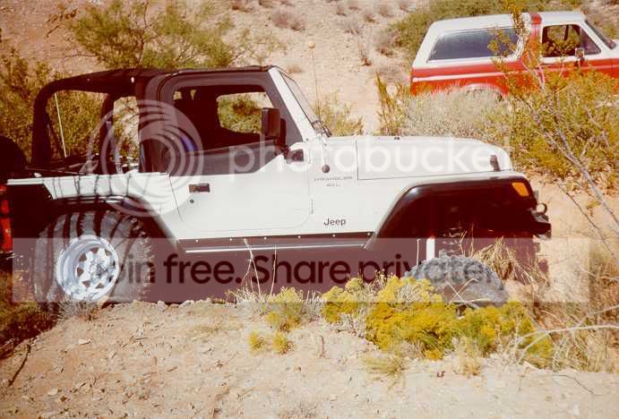

Here's the b4 and after for the TJ:
Marv

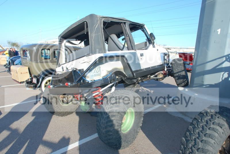

I am running an Atlas mine. It's 4.3 Atlas II. I love it and the case seems to work very well and stand up to my abuse with the 42's and the FI 350. I had some problems with my front driveline angle, because I clocked it close to flat and I have 6" of lift up front, so I add a 241 doubler to increase the front shaft length and reduce the operating angle at the front output joint.
I have used it(with the doubler) harshly on 4 runs now with no issues even in LOW LOW. These are the available ratios with my setup:

And since we're posting pictures:D:

Great looking rigs. Kinda funny next to an old model T.
DPI, how do you keep your body sooo clean? Blazer I mean.
