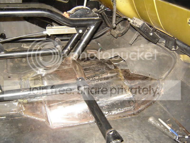

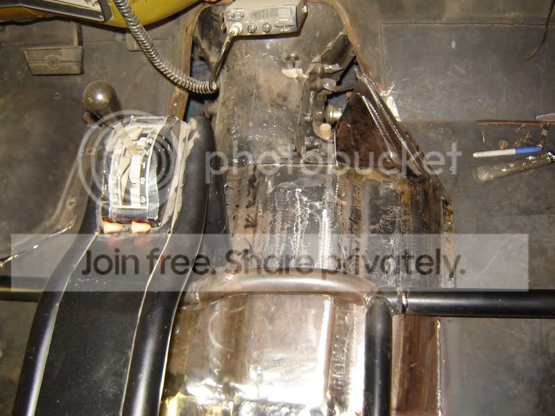

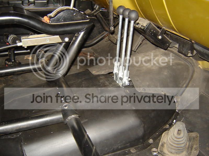

Here's what became of the floor. 2 pieces to be able to get to what I need.Next the Exhaust.
