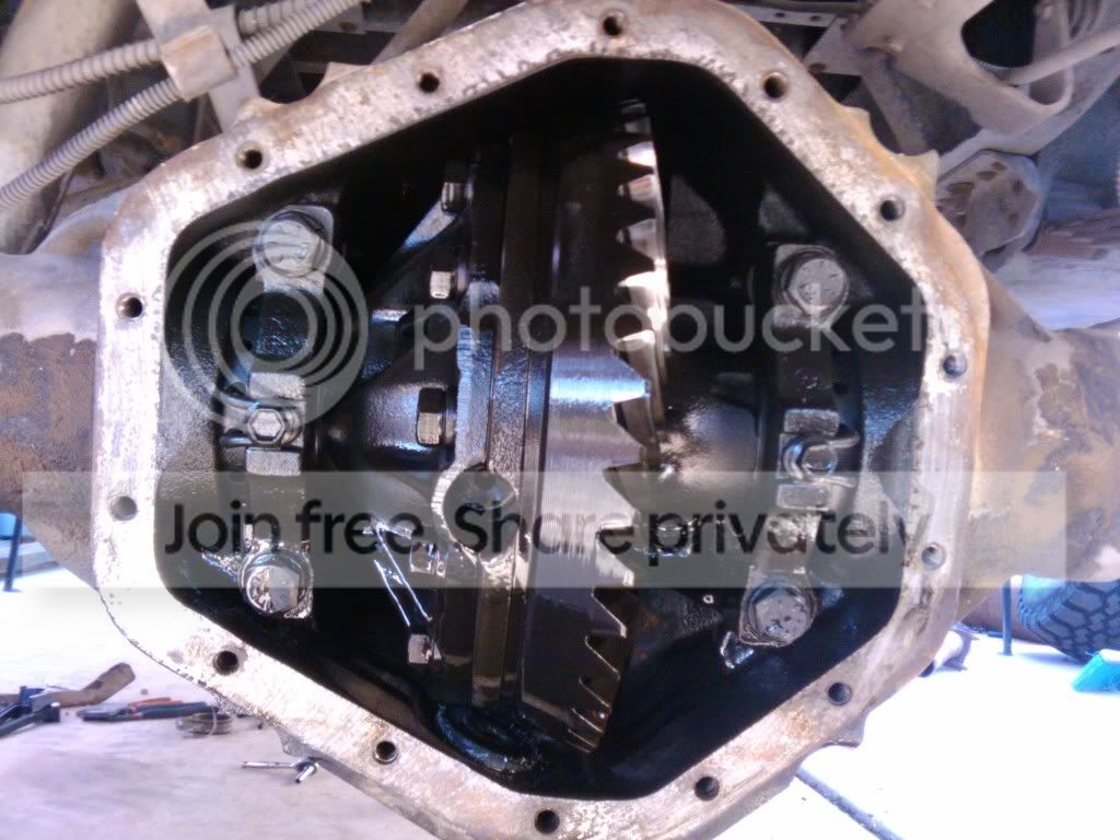

Fuel lines, stainless brake lines, diff covers are done. Diffs are 4.10's and it has a gov-bomb. Drilled and tapped the exhaust manifold for the egt and a spare hole so if I need one later. Turbo flange gasket was leaking. Waiting on the new one tomorrow, so that held us up from getting the exhaust on. Driveshaft will be done tomorrow. Oh yeah, it sucks posting from a phone.

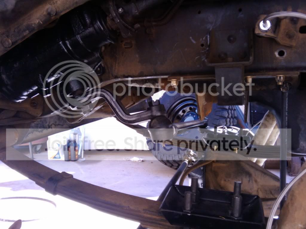

Steering and front axle were next. We tore it down and repacked the the wheel bearings. Brakes look like they were replaced not too long ago. Swapped the kingpin studs from the passenger side to the driver knuckle, put new springs, bushings, and cups in, and installed a WFO passenger arm. Aaron picked up a Dodge arm, 2wd steering box, and tie rod ends before I got there. Got all of that put on.
Aaron also made up some brake lines for me, so we got those swapped out along with taking out the LPV in the rear. It was kind of on a whim to make them, but it ended up being a good thing as the originals were dry rotted and stretched at droop.

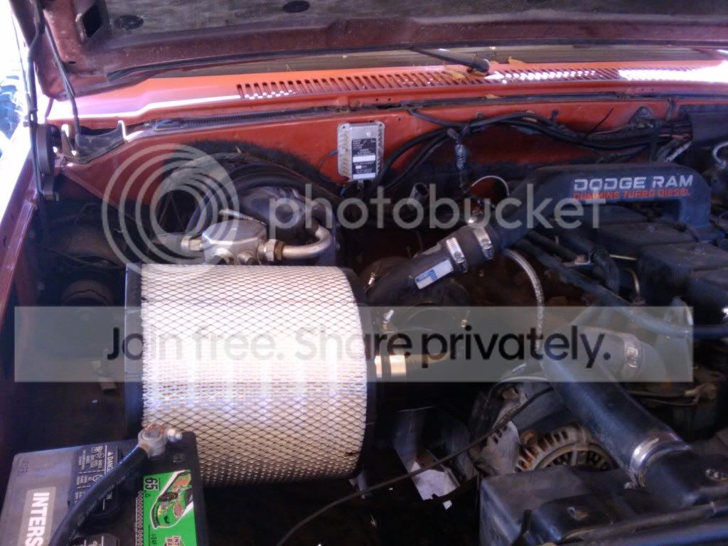

The intake was the original one from the Dodge and would not fit correctly with the second battery. I ordered the WIX 42790 filter from fleetfilter.com and found a 90* 4" to 3" reducer from siliconeintakes.com. Both of these fit great a short piece of 4" tube and stick the filter right between the second battery and A/C box. The filter could be a half inch less in diameter as it wedges between the inner fender and the hood. There are some other BHAF options with a little different dimensions that I may try next time.

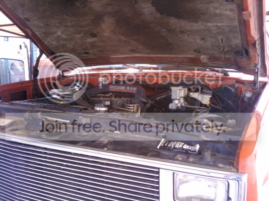

The clutch has a remote reservoir and the factory Dodge one was in the truck. Only problem was the mounting tab was broken and the nipple had been glued back on with something gooey. I didn't trust this to get me home much less in the long run. The brake master cylinder had been changed out at some point to the plastic unit from the cast iron. I could not find a suitable reservoir for the clutch that was easily available and cost effective. So we came up with running the clutch off of the brake master. Then there was the problem of coming up with a rubber washer to seal fittings through the plastic. Running out of time, the KISS method came around and we decided to switch the brake master back out to a cast iron unit and drill and tap it to accept a 1/4" 1/8NPT fitting.

Sorry the intake is the only thing I have a pic of. I'll work on getting some more over the next couple days. I was working on it from about 9 to 6-7 every day until Aaron got home, then we would work on it til about 1 every morning. I have to thank him and his wife for putting up with me for a week and letting me crash on their couch. This could not have happened if it weren't for their hospitality.
