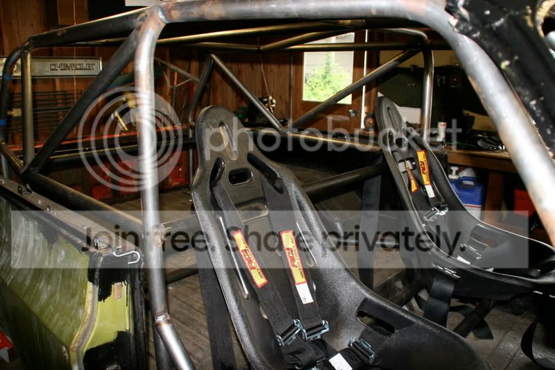

thanks for the compliments guys. i got the front seats mocked up today. i'm on schedule to being done with it tomorrow. probably still have some significant welding to do after tomorrow, but at least it'll all be together. ;)

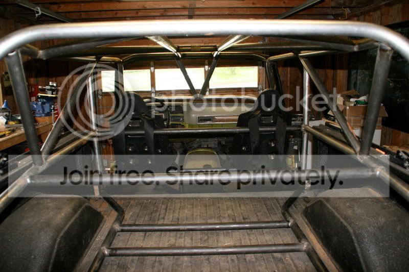

new pics. i've basically got all the tube work done for the cage. i still gotta add the tabs for mounting the seats and finish the welding tho! :D i'm real pleased with how it turned out. i'm thinking of doing a spare tire mount in the bed - i've got exactly 39" from the back seat rail to the back of the tailgate - so it'll be able to mount flat. i'm going to run either 37's or 38's. :D then all the rest of the cargo can just go on top of the tire. :wink1:
i might not get the back seats and harnesses till i get back from california in early july... i'm going to drive this down there and wheel with the SOCKO guys! :D :D

wow, nice cage work. Now I gotta go back and read the rest of the thread
EDIT: ok just went back and read the whole thread. Your truck is looking really good so far. Any plans to add another tube from the rear wheelwell to that node just above it? Man I gotta get a bender soon!

i don't plan to add anymore tubing. :)
