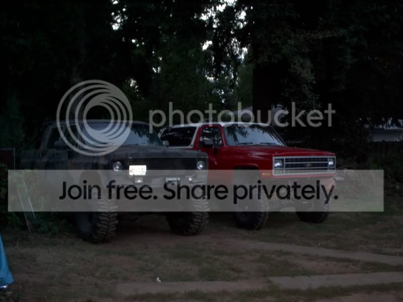

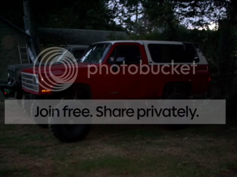

here you go, cheap-o's! :D it's the red body that i'll be getting:
I'm thinking an s-10 extra cab will do nice on that blazer frame with some tube work in back . Maybe just full tube it off the frame . I'm glad the blazer body will be getting a good home Colby . Nothing like getting a rust free blazer body and beating it up :laugh: . Your a chevy butcher just like me :haha: .
