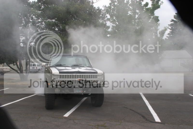

so, after installing my detroit i had to get out and burn some rubber - make sure it was working properly. :wink1: so i went to my favorite parts store and asked if i could use their back parking lot for some testing. :laugh: they said it was cool, but that their neighbors wouldn't be too happy... :rolleyes: so we did it. :D
well, we decided to find another location to burn some rubber after a few old women came out screaming at us... i'm not kidding - shrill, lost-control kind of screaming! it was hillarious. :doah:
i also learned today that burn-outs rip holes in the asphalt... oops. never done a burn out before. :D

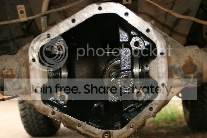

ok, so lift your rig up and pop off the diff cover and remove the axle shafts - or at least pull them out a few inches.

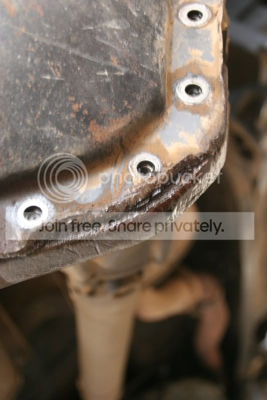

looks like it's about time for me to give kert at DIY4x a call for a decent diff cover... :doah:
using a hammer and a punch of sharp screw driver, make a mark on the collars, and a matching mark on the axle housing (see pic below, originally done and posted by pvfjr). this is what you will use to reset the gears when you reinstall your carrier. then remove the bolt that holds the collar retainer, and then the two bearing cap bolts.
(((EDIT: LOOKS LIKE PVFJR's photo is gone)))
rotate the collars two turns clockwise, as viewed from the carrier. this means that you rotate the collar on the right (passenger side) downward 2 turns and the collar on the left upward 2 turns. one rotation is when the marks that you made line up again. don't mess this up. make sure it's exactly 2, - you can do more than that if you like, but there's no need. just remember exactly how many turns you've made. don't mess this up.

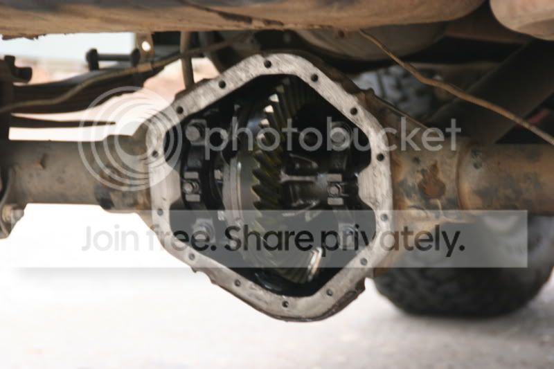

pull the carrier out. sucker's heavy, so be careful. this is what the empty housing will look like:

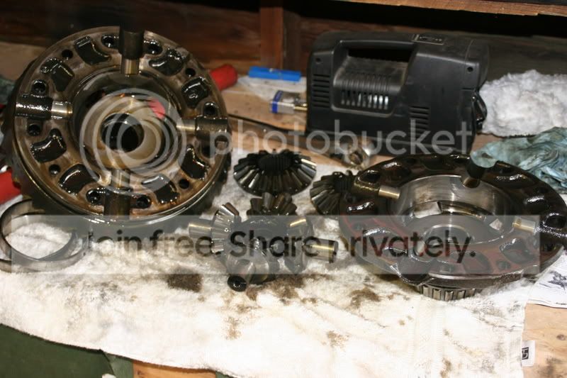

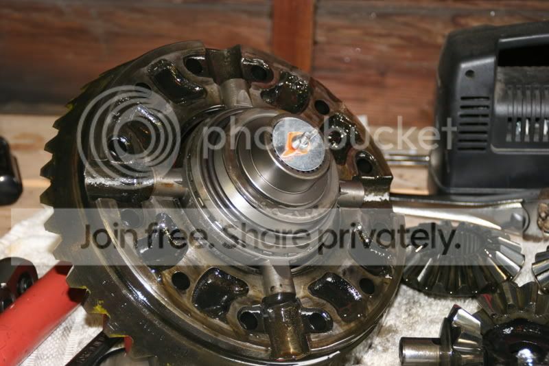

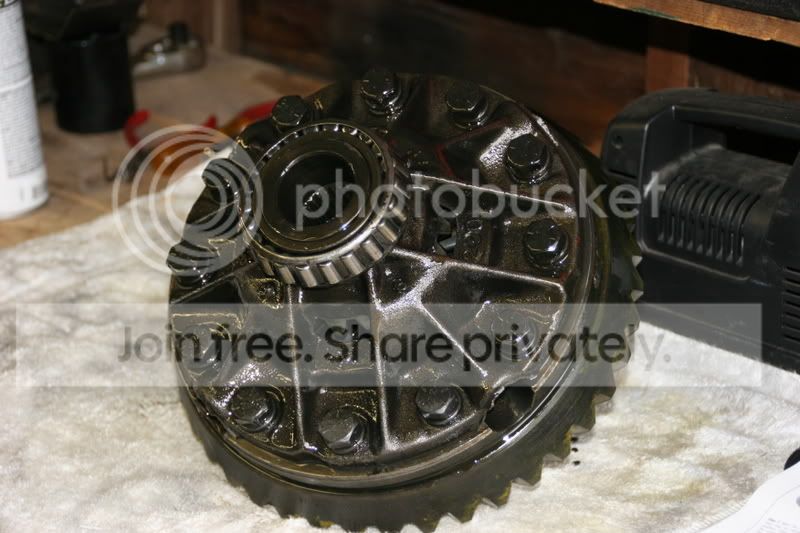

some pics of the carrier:
carrier disassembled - siders out, don't forget to pull out any shims that might be in there.
detroit sitting in place of the spiders.
put the carrier back together, install the ring gear bolts a touch more than finger tight is fine for now. then remove the bolt/wing nut that the detroit has installed in it, which holds it together.
