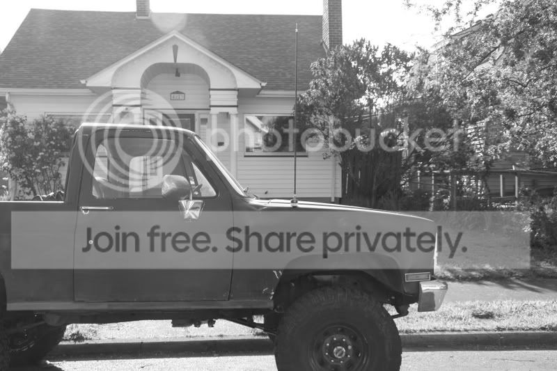

    well, i didn't realize that my camera was on the BW setting... so no, it's not snowy here, but there are lots of light colored flowers blooming on the trees. :D anyway, here's pics of what i've got going on so far.
    here's my antenna - not hooked up yet, but at least it's standing!

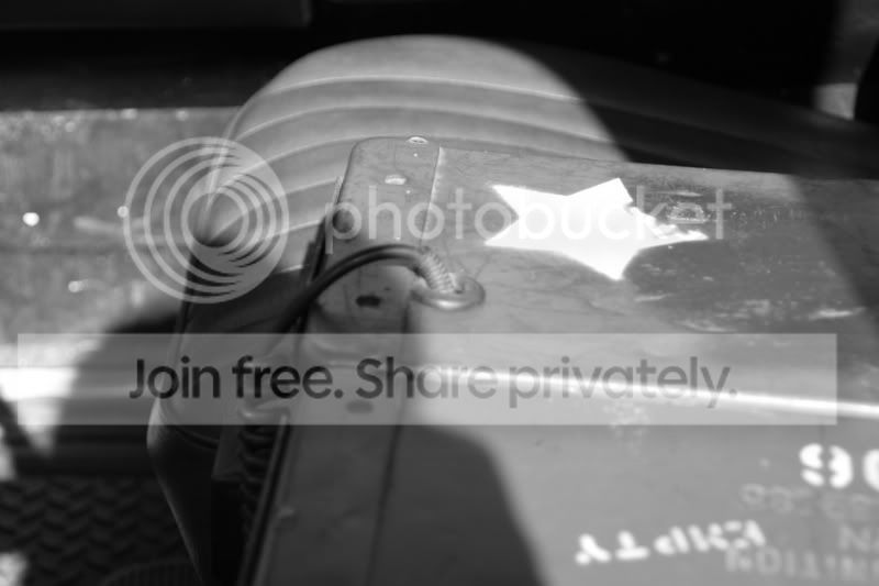

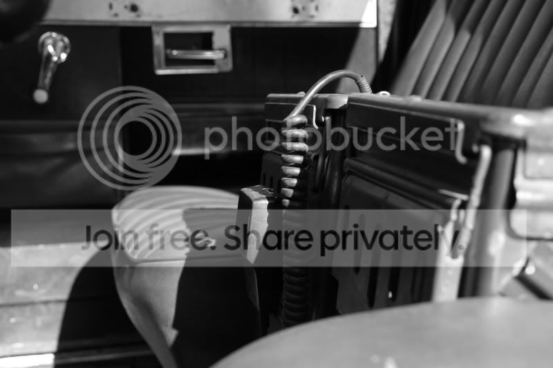

    here's how i've mounted my cb:
    [​IMG]
    [​IMG]
    it's pretty slick. the mic/speaker hang off of the slots in the latches for the ammo box. i intend to put my stereo, if i ever get one, in the ammo box too. :D
