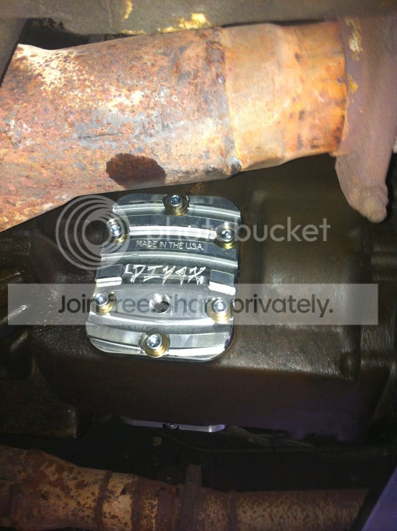

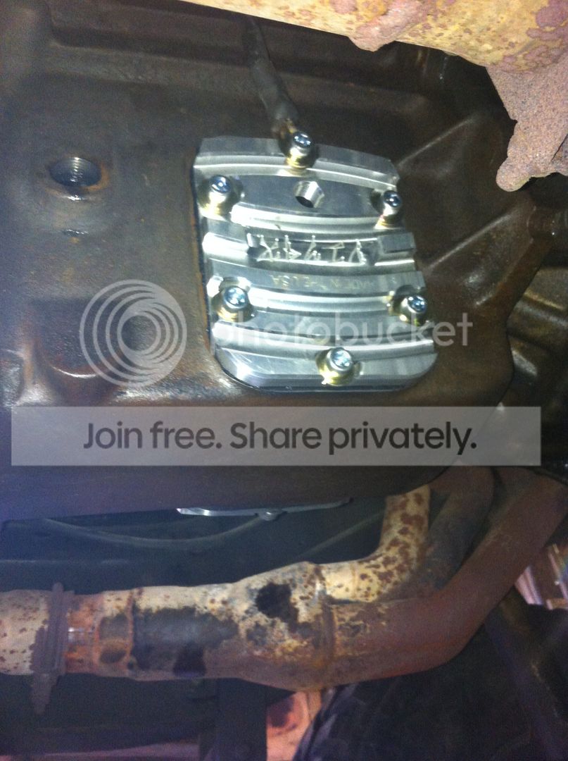

Put the aluminum PTO covers on this one while I was under there. The start of my NV4500 cooling system.
This one is on upside down so that the NPT ports don't line up straight across the transmission. Seems you could pump the lube in and right back out again. I'll bring the cold in this side so it can pump directly onto a gear and get splashed around a bit. At the very least there will be some dispersion in the case.
